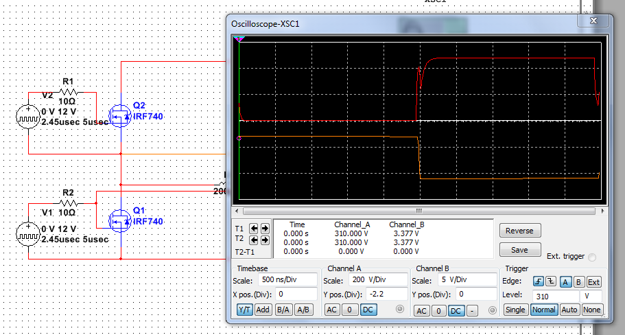

You should scope the lower FET gate, and tha half bridge output, to check for ZVS or ZCS switching.
How do I know if there is ZCS or ZVS ?
Previously I posted a simulation picture where there was inductive operation (possibility of ZVS) but the dead-time was to small to achieve complete ZVS:
You can see in the red signal (lower FET gate) that there is miller plateau caused spike, the on the yellow signal (half bridge) that the transistion is very steep.
If you have capacitive mode (possibility of ZCS), then you will see the same, even if you have big time.
Even if you in capacitive mode that does not mean you can certainly achieve ZCS 🙂. (as if you in the inductive mode ZVS is a possibility with good dead-time)
Here is a very good link about ZCS resonant converters: http://schmidt-walter.eit.h-da.de/snt/snt_eng/snteng4b.pdf
If you in capacitive mode then the periodic time of your control signal must be longer then the resoant network periodic time. (FYI: IRS27951 is intended for ZVS resonant controller, it cannot be used as ZCS resonant converter controller)
