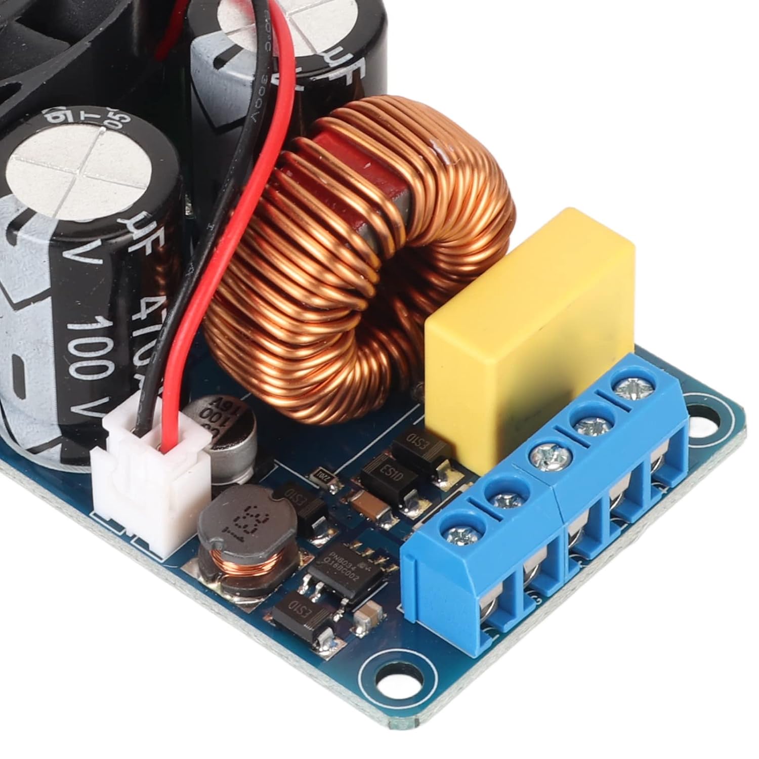

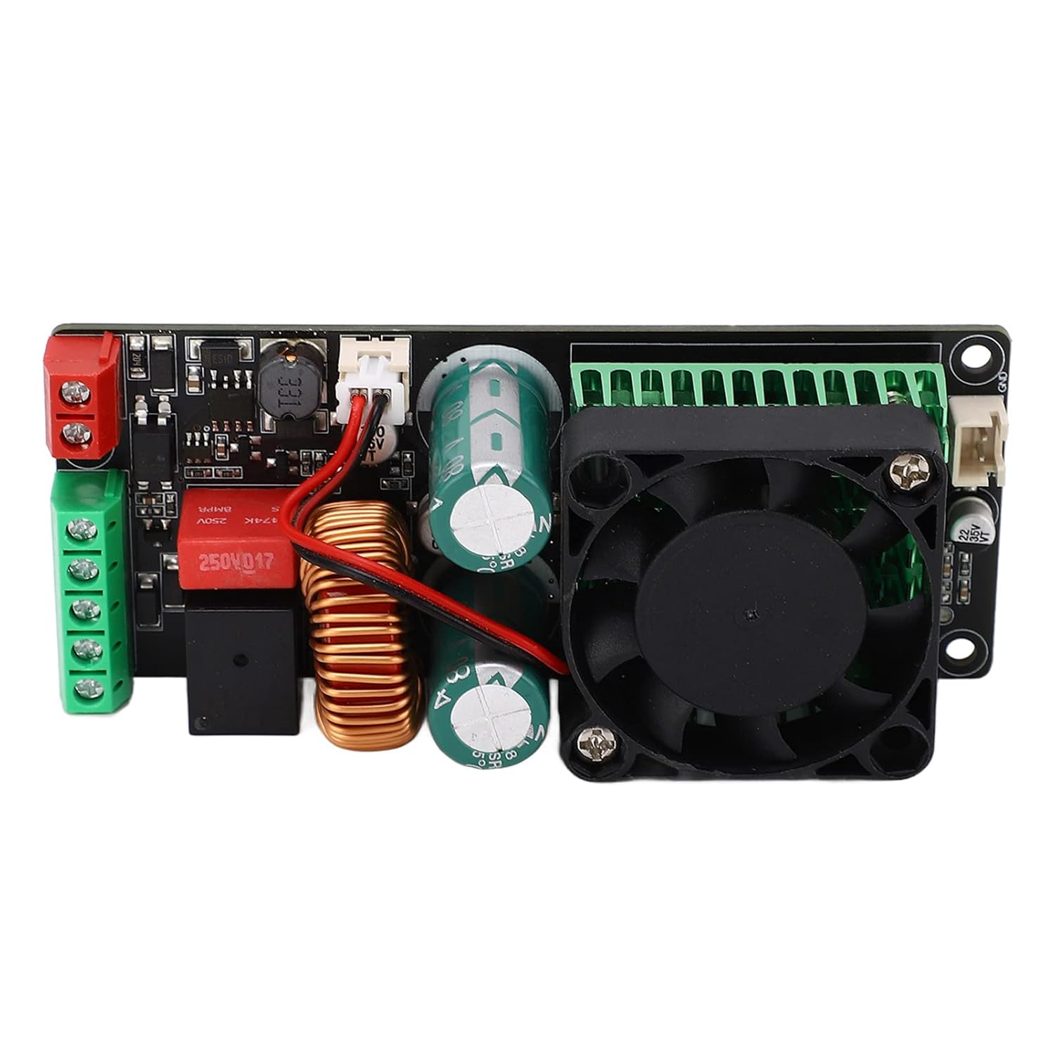

I was looking at some of the IRS2092S amps and ran across this one with AC input for power on and speaker protection. This seems unnecessary to require 110/220 for amp power on just to prevent speaker power on and off thump.
Has anyone tested these? Maybe someone could explain the benefits of this design.
There's no onboard PSU on that module - if there was, why would you need a separate PSU as well? (not to mention that there are no PSU parts on the amplifier PCB). Pretty sure that they have just added a mains sense circuit for the speaker protection circuit - because unlike most of these small amp modules you can actually see a speaker protection relay on this one.
