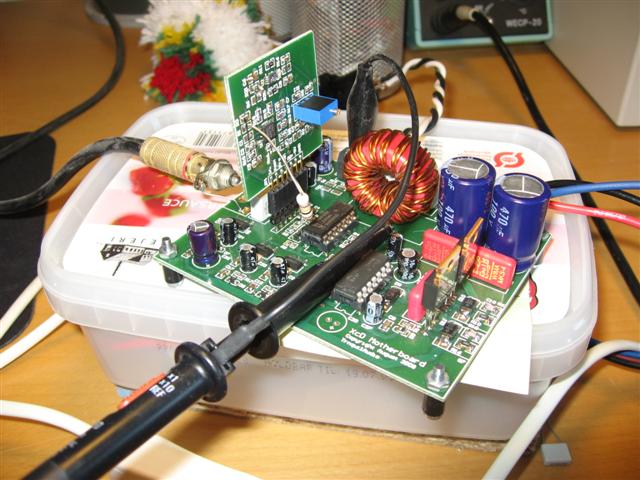

In self oscillating amplifiers, inductive crosstalk from the output inductor and capacitive crosstalk both from the switching nodes and the inductor, to the signal nodes, can result in strong deviations in switching frequency. If intput signal is also picking up stuff, it becomes even worse.
At the beginning I used to touch the switching node (be careful witn RF burns if fingers are not completely dry or peak to peak voltage is more than 80V-100V) and output inductor and look for frequency deviation. The target is little or no visible deviation on oscilloscope. This is like using your body as an antenna.
Double sided PCB with ground plane, SMD components, balanced input/output on modulator, placing the modulator in a clean spatial plane, and good lowpass filtering of intput signal will help a lot.

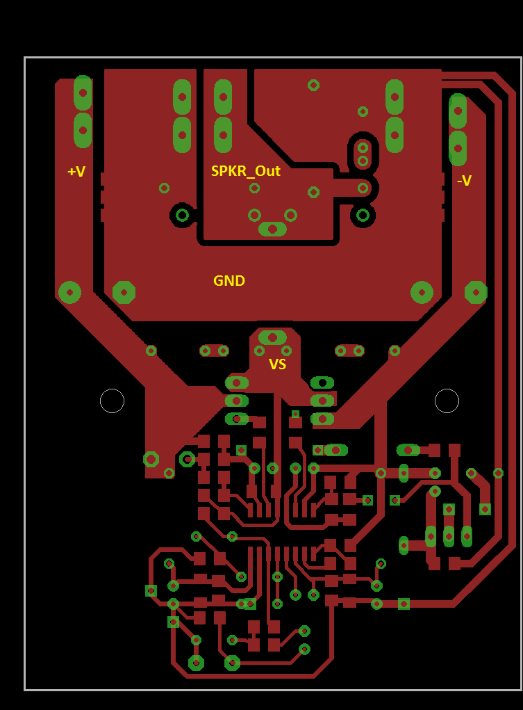

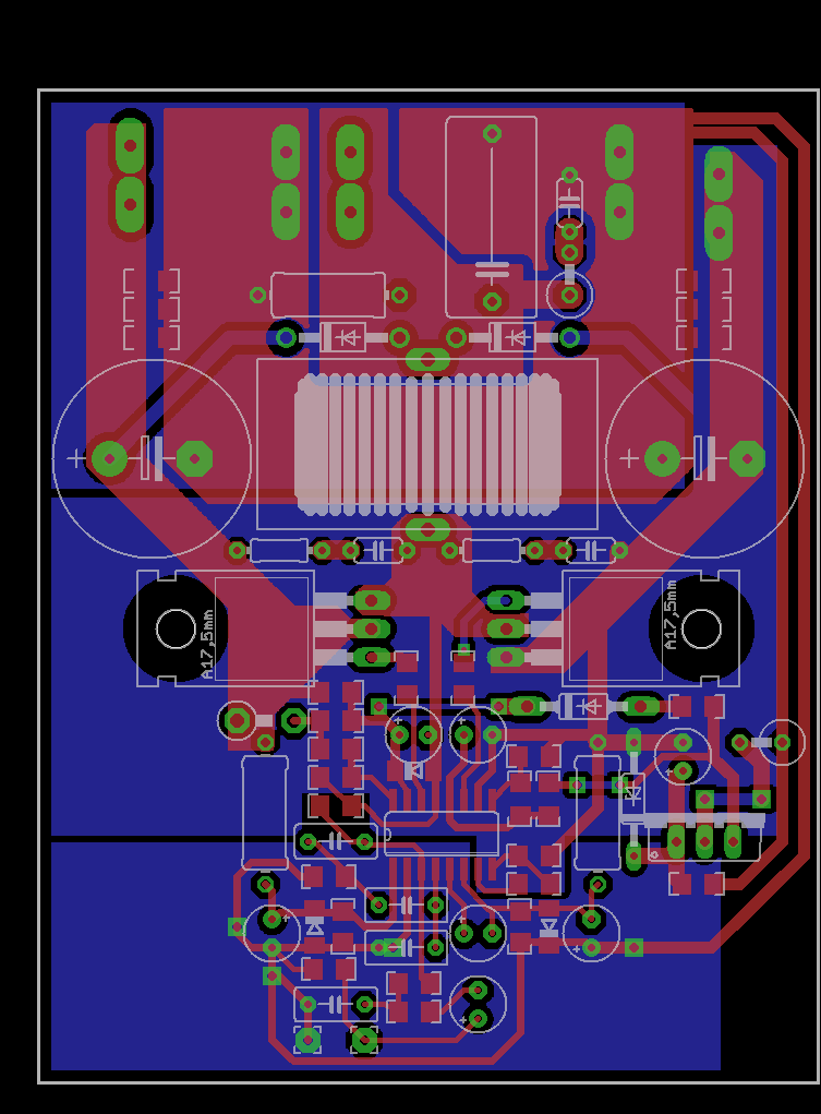

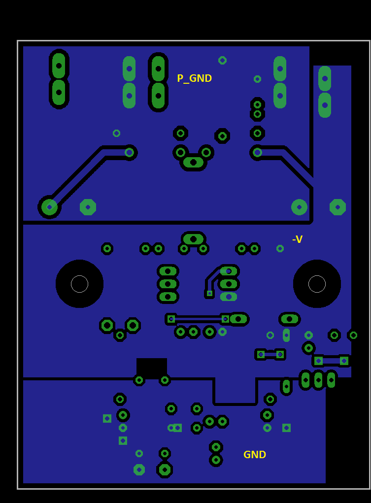

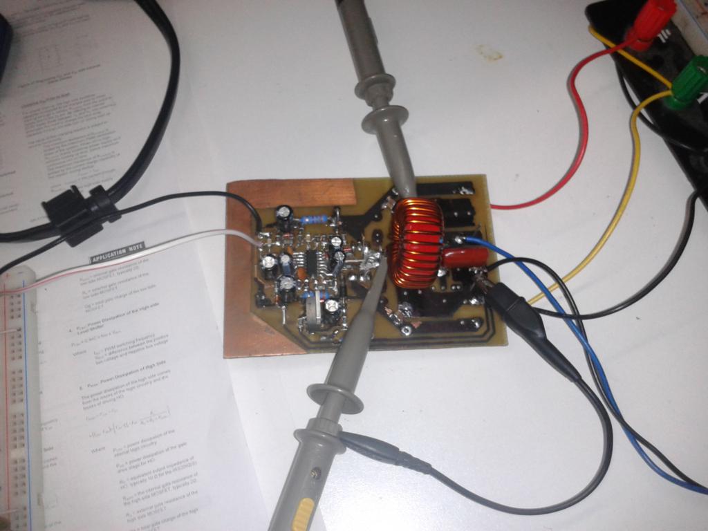

Hi

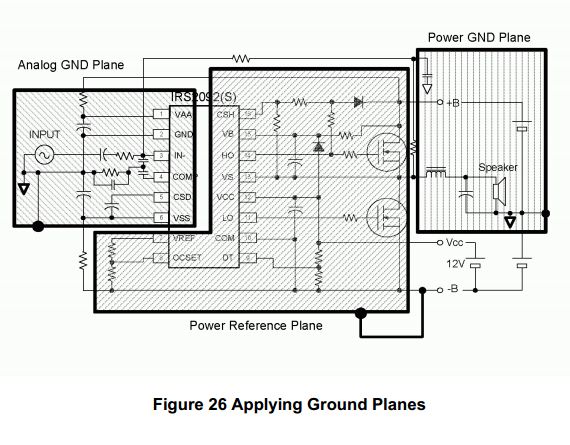

I'm trying to apply ground planes correctly. I saw Luka´s pcb and ir app note.
The board is based on iraudamp7.
What do think about this layout ?
regards!

Are you not using a heatsink ?
Are the inductor wire holes big enough ?
The layout looks about as tight as you can get it.

-The heatsink will be under the pcb.
-The inductor wire hole match correctly.
-I want to get a small pcb 😉
But what do you think about layout?? I have no experience wiring Class D amps
regards!
This looks good, I don't think you need those diodes, above inductor... you do have them in fets if they would be needed: In fact only diodes in some app are somewhere around IRS, those you might want to add
I think you are ready to build it

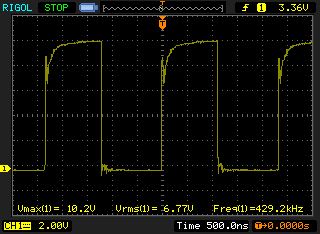

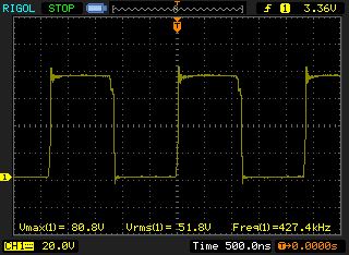

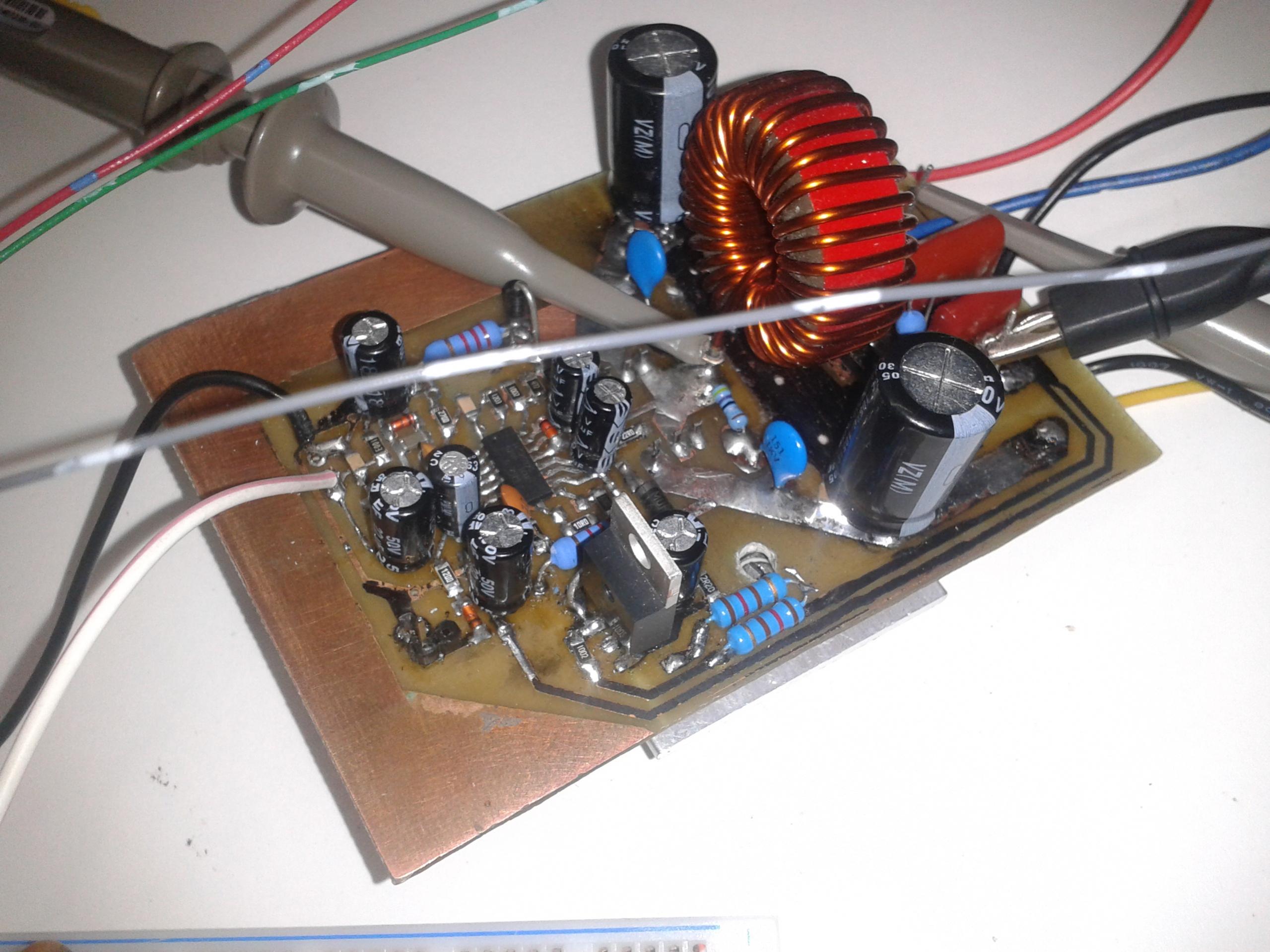

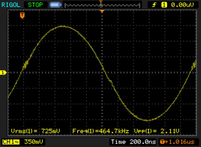

This is the pcb working at 80% 😛 ,
I have to improve the OCP,the IC enters to protect mode at high volume and select the inductor output.
No more heating. The mosfets are a bit warm.
Working at +-35vdc@450KHz , 6 ohms Load

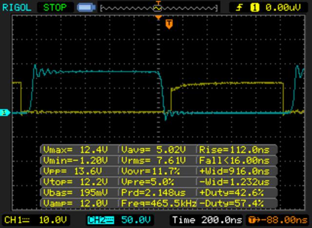

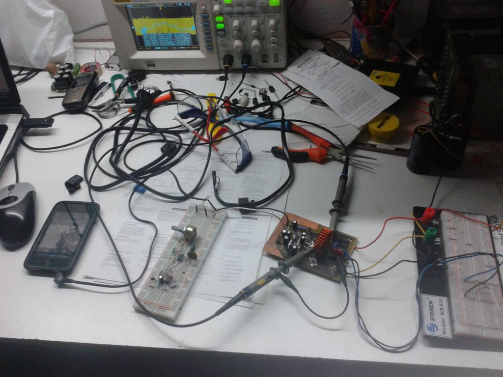

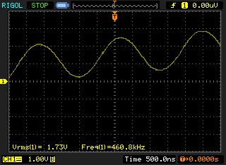

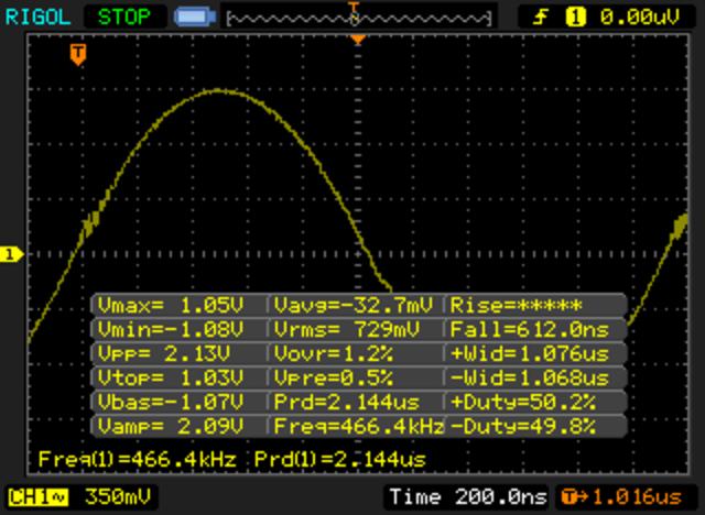

Some pictures of my amp working,I'm getting around 150W,4ohms Load,+-37vdc ,Fosc 450KHz.
Does the IRFB4020 could be suitable to get 350W@8ohms ?
ty!
