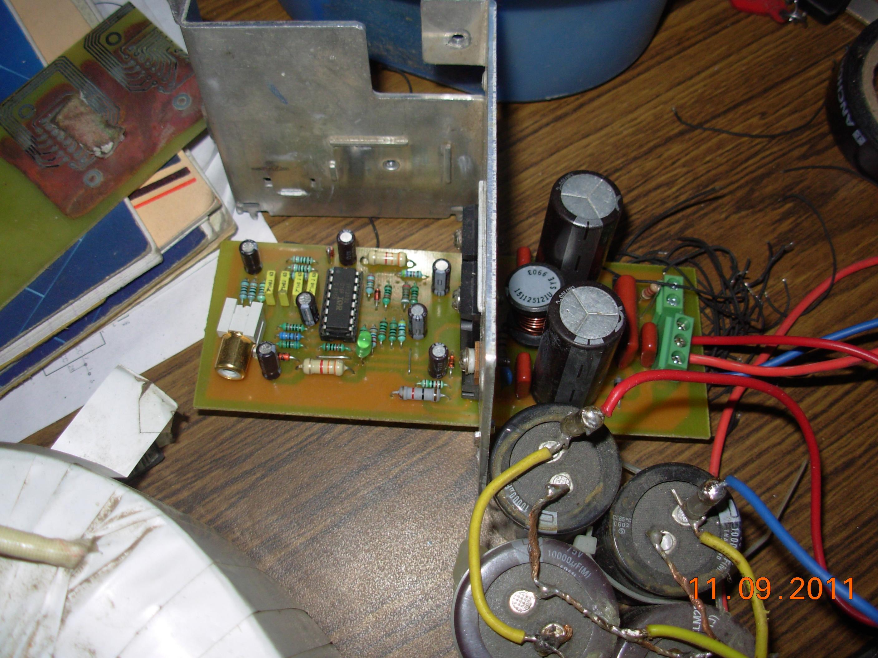

hi everyone,
this is my new IRS2092 through hole desing. sounds excellent. working voltage +-45. negligible heating.
hope you will like this.

The IRS2092 does sound pretty good, I cant tell the difference between the 2092 and a class AB amp. My layout is through hole too. Its easier to replace the 2092 if its in a socket.
you are right, i am neither a good audiophile, but this amp sounds good and should be given a try for those who doesnot like bulky transistors and heatsinks and transformers.

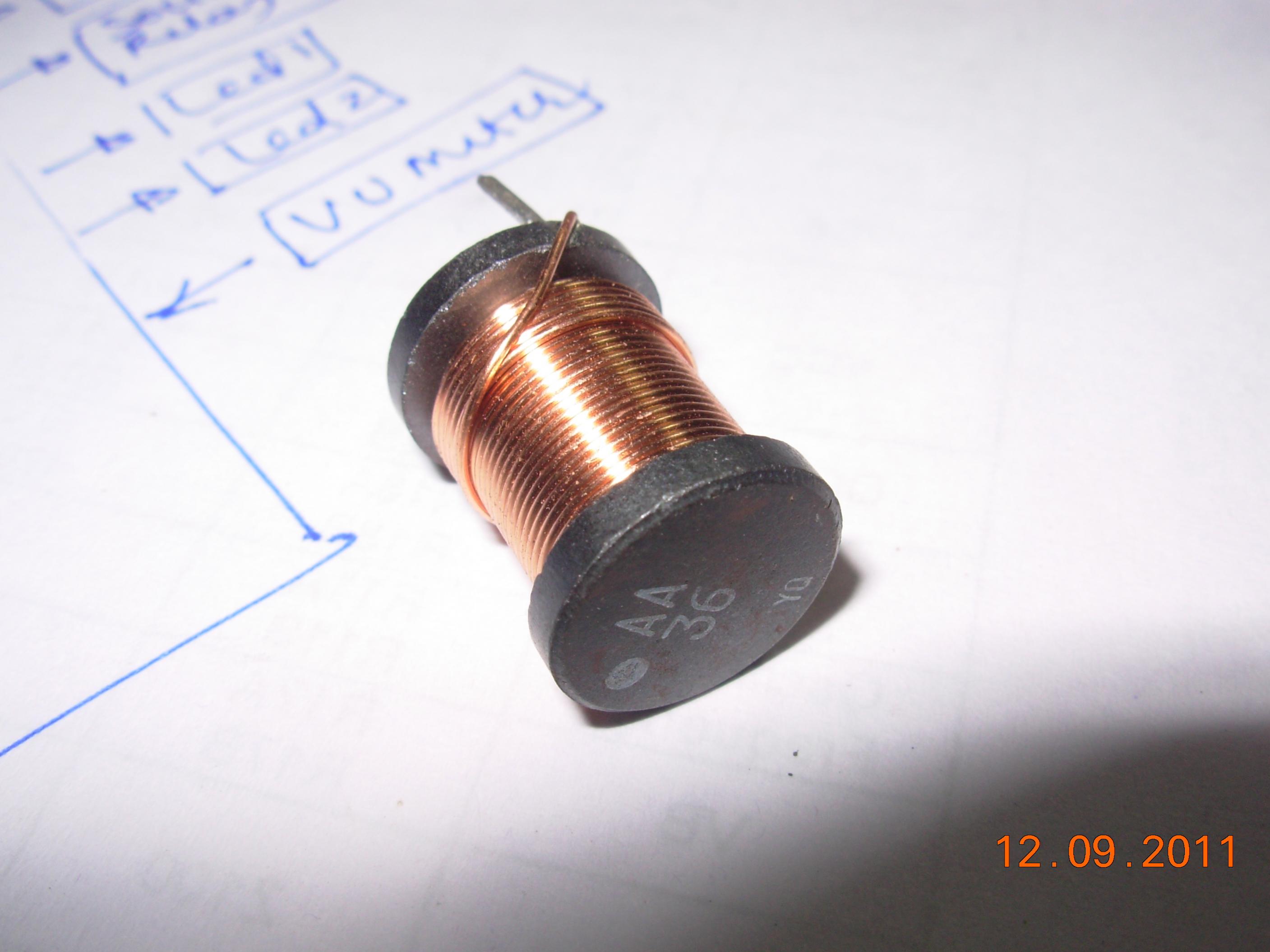

What inductor did you use for the 22uH, 17A? Sources
for the components?
Thanks!
In fact i didnt found any sources, so i managed to get some cores locally and rewound them.

I naively used power inductors for the core to start with. But they got red hot 120 degrees C ! I was advised to use a t106-2 core and that worked great and barely got warm.
Through hole is fine for the 2092, I had problems with decoupling but that was my poor layout rather than a datasheet error. The output mosfets needs decoupling closely and across, b+ to b-, b+ to gnd and b- to gnd.
I also had a few problems with glitches on the VCC rail, so I decoupled this close to the 2092 and everythin gwas then fine.

Yes there might be lot of heating in the inductors as well as mosfets if the core is incorrect. I also have to hit and trial many cores since here in india it is hard to find a specific core material.
