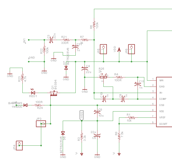

I have been designing a class D amp based on the IRAUDAMP7S rev 1.0 and I cant manage to make it work.
It seems that when the MOSFETs are connected the power supply shows as being shorted.
What are the things that could cause this? I have checked for shorts in pcb, modified dead time and didnt seemed to help.
Thanks in advance =)
Edit: Typo mosfet is IRFI4019H

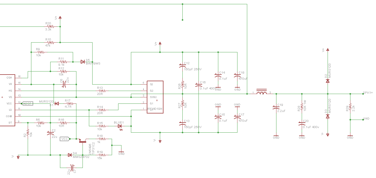

Yes I have an oscilloscope, I managed to make the circuit to work but driver outputs are always off.
Two dual power supplies are being used (each one with outputs at 25V) to have +/-50V in power rails.
Mosfets and driver are always cool, so it seems to be a problem with decoupling. But Im not sure what to do....
It might help but in stanby circuit draws about 10-20mA from the power supply.

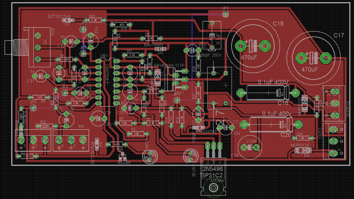

I attach photos of the pcd, and the schematic I have used. It should be the same as the one in IRAUDAMP7S rev1.0 but different LPF component values.
Any advice on making a good pcb? Whats wrong?PCB Layout completely wrong ...
A Class D amplifier requires a much better PCB Layout.
The easiest way is to use a pcb layout and circuit designed by IR.
There are some in the data sheets.
It took me a few revisions before I got a pcb to work, even then I had to scale back the voltages for over current to get it to work loud enough.
Decoupling is vital as close to the mosfets and IC as possible.
Tracks need to be as thick and as short as possible.
