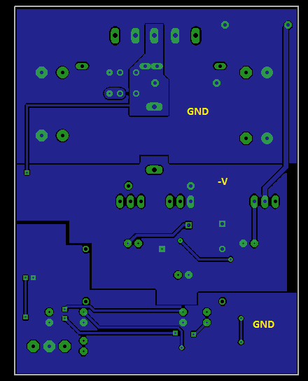

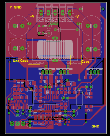

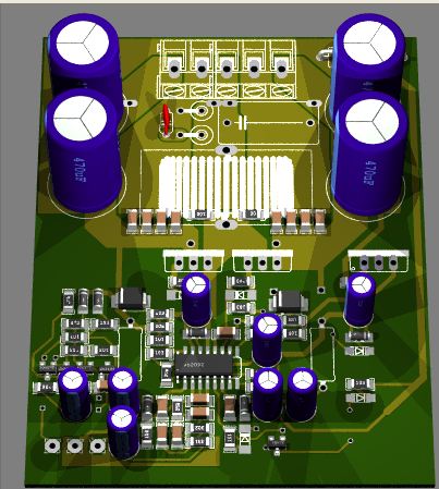

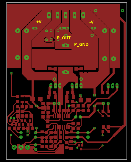

Sync terminal added.
I have some IRFB4020 mosfets.
This will be the prototype, It also include the basic protections.
DCP.UVP.OVP.
Decoupling capacitors as closes as posible.
470uF electrolitic
1uF ceramic
0.1uF ceramic
