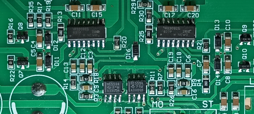

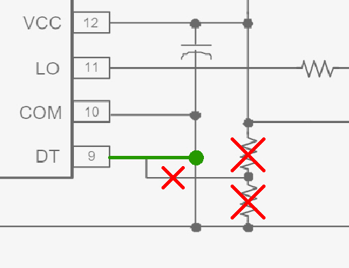

Hello, I have Class D amp with IRS2092 from China. There is a pin9 (DeadTime) connected to pin10 (-B). Is it normal? I haven't seen it anywhere.

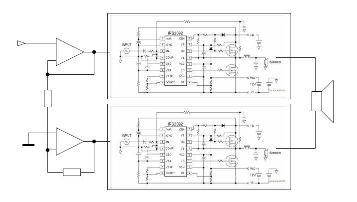

The amplifier is generally weird. It's 2 x (IRS2092+2xIRFP4227) bridge mode. Input circuit is like a radio jammer. It's Aliexpress IRAUD2000. The sound is good but the terrible interference !!! When I disconnect input signal cable interference is gone. But cable is OK. It's awful.
My experience ....IRS2092 is a very problematic circuit, and I don't want anything to do with him.
Class D is fussy about layout and decoupling.
Also, gate driver and dead time takes a lot of care.
My early attempts at getting it working failed badly.
Even after I got it working with irf4227's on power down it would squeal then give an an almighty bang through the speakers !
IR said I had to much smoothing so answer was a reset circuit that monitored VCC and if out of spec held 2092 in reset.
