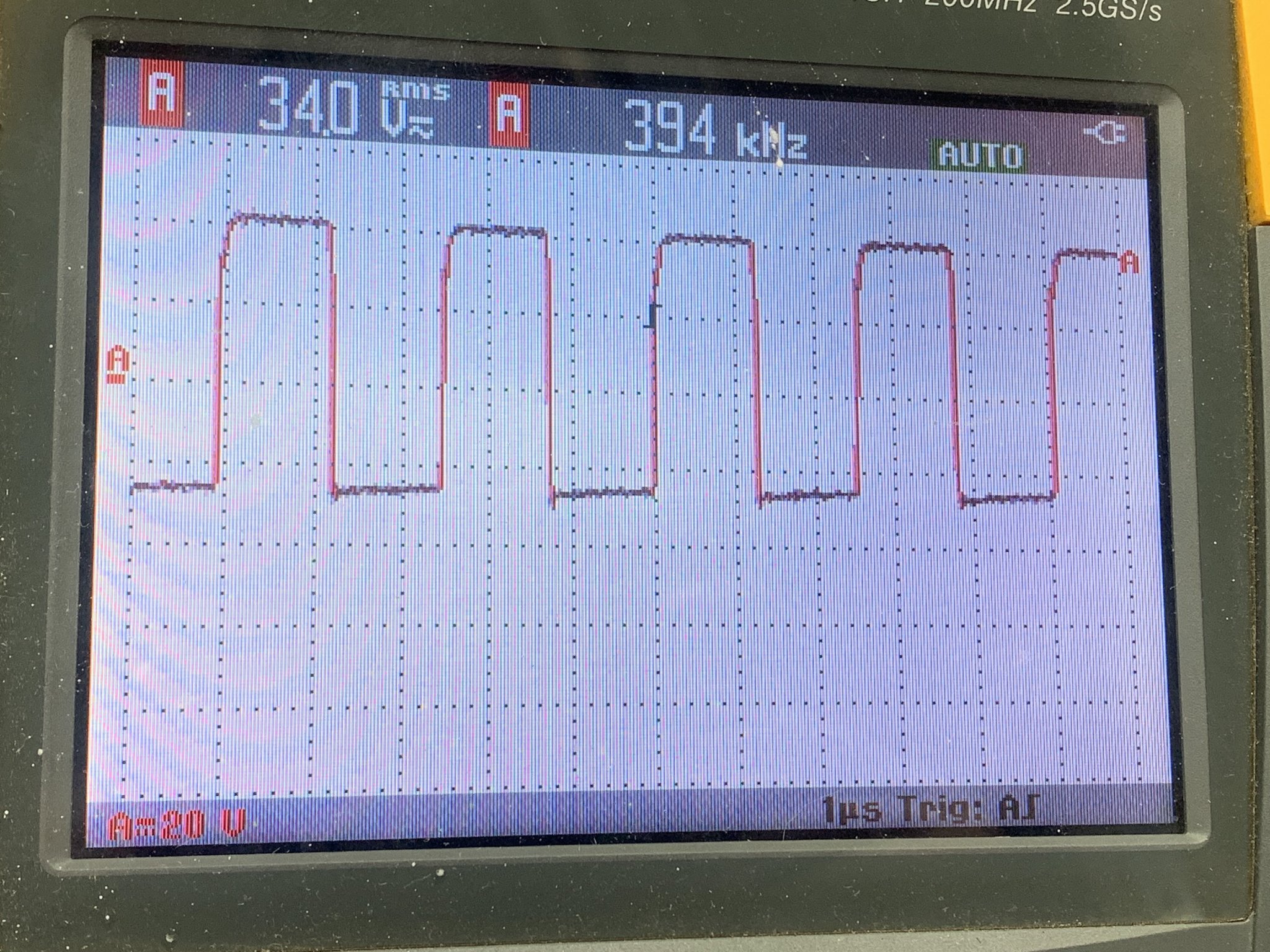

Taramps; shorted outputs in three channels, replaced IRS2092 and output FETs, two of the three channels powered up ok, good R-R oscillation, however the third channel appears like it wants to start R-R oscillation, zooming on the scope it does have sq waves before it flatlines and it repeats this until the unit is turned off.

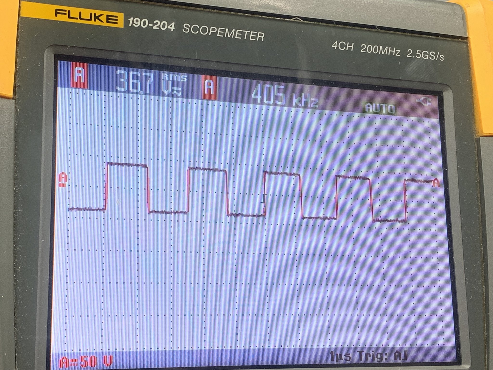

DS18 X5B; 3 units came in, each with similar reports of sub channel not working. One unit uses CSC3120 and the other 2, IRS2092. Each unit appears like it wants to start R-R oscillation, zooming on the scope it does have sq waves before it flatlines and it repeats this.
Thus far I’ve only messed with the DS18 with the CSC3120, I’ve replaced it with a new IRS2092, and used various values of caps for pin 4 to alter the oscillating freq, I’ve measured the resistors around pins 7 and 8, both are with spec. I’ve compared these values with the other two DS18 amplifiers, measured and all measure around the same resistance.
In the one unit I messed with, I replaced the resistors with new. All to no avail, the unit remains the same and shows as if it is trying to start oscillating. All other components around the FETs/output of the drivers are testing ok.
I’ve attached a couple of scope screen captures to aid with my description of what’s happening. Anyone ever saw something similar and remedied it?

#3: only the Taramps had shorted output FETs (IRFB4019), these were replaced with new from Mouser, for the three defective channels, of the three repaired channels, one is displaying this attempt at start up.
On the DS18 with the CSC3120, the output FETs (SVT20240NT) tested ok both in and out of circuit. I replaced the 3120 with a new 2092, after checking resistors, i replaced the SVT20240NT FETs with IRFB4019. All changes were to no avail.
The other channels in the taramps are oscillating around 400khz.
I looked at older DS18 amps I repaired, and the sub channel is also around 400khz.
The first pic is from the Taramps, and the second an older DS18 amp sub channel.
From looking at the IRS2092 application note and resistor values for pin 4, around 400Khz seems about right.
