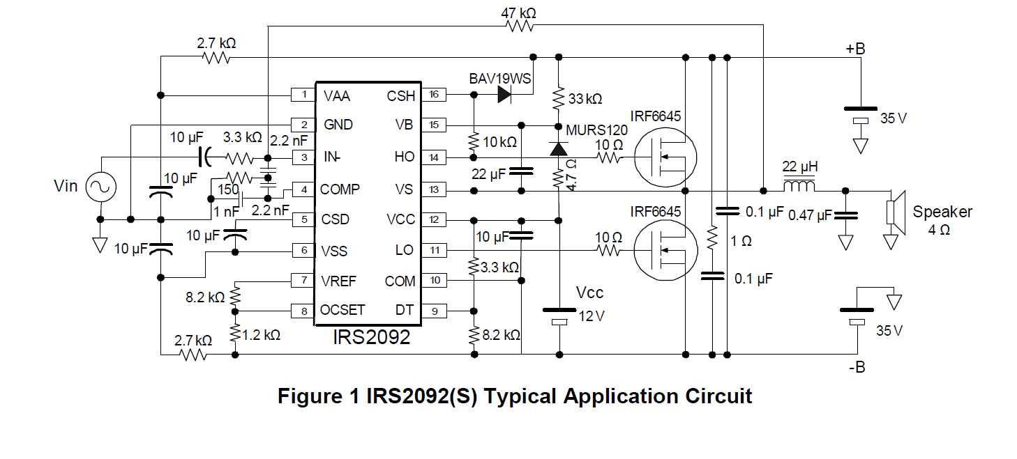

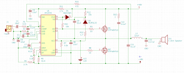

Hey, I have tried to build a Class D power amp from the reference design in the IRS2092 datasheets and other reference notes. I am attaching the schematic as I've built it. (the reference used different mosfets and B+/B- of 35vdc but I found a few 48VDC so I changed to some 100VDC 50A mosfets (listed in the schematic). I used my desktop power supply for the 12V VCC.
I powered it on and it gave me some periodic pop noise but nothing else. I then realized I'd not connected the input sides GND to the output side so I jumpered them together. there was a pop and the magic smoke came out of the IRS2092. I'm unsure of why this happened, and was hoping maybe some of the class d guru's here might have suggestions?
I'm attaching the schematic with the values I used.
Thanks!

I guess I realize I didn't actually ask a question....
Does anyone see anything wrong with the schematic as noted? Again this came directly from the reference design from infineon, seems pretty straightforward to me, but I come from the tube amp side of things and solid state stuff is still new-ish to me. I understand how mosfets/fets/transistors work, op amps work etc, but just haven't done any deeper digging into a circuit like this to understand why the IC died...
Thanks!
~Phil
I connected the 12VDC negative to the B- rail as shown in the schematic.

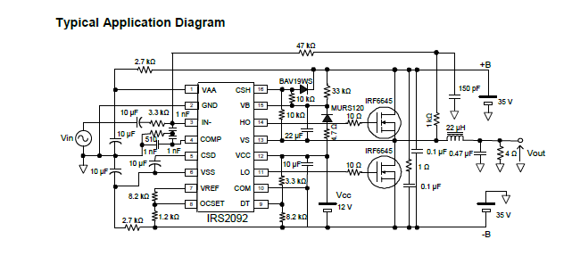

I did get an update at eevblog that made me note that one version of the reference document doesn't have a 150pF cap to ground on the NFB line, but it does on another, and that may be part of the problem, I'm attaching the two versions I now know of, the one w/o the cap to ground on NFB was the one I used, but I just found this other one that has one. Maybe they found an error in their reference design and added that cap to fix it? Does that seem like a logical problem that could cook the IC? If it started oscillation of some kind?
~Phil

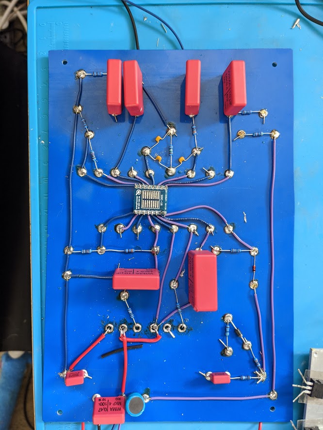

Here's the board, no PCB, just FR4 with eyelets, I usually do Tube amps so this is what I had at hand to easily prototype it.
Not sure how it will be oriented, but the mosfets burned when i did some testing post smoke out. The mosfets empty holes are on the output side, the input is the opposite, I used a pcb to through hole mini board so I could mount the IRS2092 easily in this format.

wait are you serious ? you cannot expect this to work right? you just used a tube layout on a class-d amplifier.
I am serious. I have no context telling me why it wouldn't work. Yes I'm sure I'm the noobest moron that's ever tried something. I do think, though, that probably telling me why it won't work is better than showing incredulity at my imbecilic attempts to learn.

So again based on my very limited experience with solid state amplifiers, slew rate seems to be related to how distorted the output would be compared to the input. but at this time I had no input, I just powered it on to try to and see if it even worked... The input jack was not sending anything 'in'.
I might be talking about the completely wrong concept because simply throwing out slew rates for something I've never done or needed to understand is like throwing out gravitational constants to bees.
If I could get a basic understanding to a pretty much layman (I have built, repaired and played with many circuits, but my audio experience was in the past limited to tube amps) that would be greatly appreciated.
