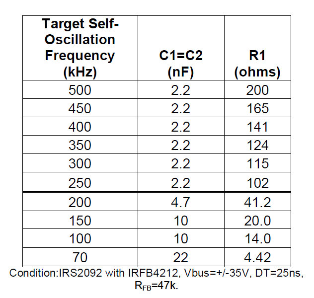

I am also planning to build IRS2092 amp. I checked your
schematic and found that your self oscillation frequency
is intended to 400KHz which is given form IRS's application
note AN-1138. I am attaching the table of frequency set up
from that document, herewith.
Related to this circuitry, C4(2n) and C7(1n) are in parallel in yours.
I don't know the suitable value of these capacitance, but the
reference designs don't use such big capacitors, usually 1n is
used.
Regarding to CSD voltage, I think +4.9V is enough to activate
the CHIP ENABLE.
