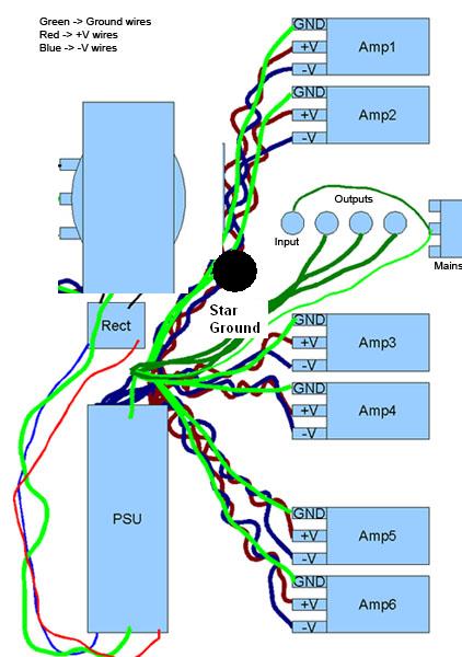

For me the problem is just one: the two noisy channels are exactly those that are more far away from the star ground.
I'm always insisting on this: the ground wires must be as thick and short as possible. And ideally at same distances.
I made some edit on Devius' layout.
From the star ground point to the PSU, it must then go one thick wire.
When I say thick, it's 2.5mm multi-strand, 1.5mm minimum (not recommended here).
I would also change the position of the trafo, rotate 90º.
PS: I would disconnect mains earth, definitely not good for audio. I was once sent to Texas for saying this, but it's my experience, and it will always be my oppinion.

That would be ideal, but those wires in reallity are even closer to the transformer than the drawing ones and it is absolutely impossible to route them any far from the tranny. The only way would be to route them through the outside of the box 🙂 lol
You are correct as to the distance to the transformer. Both pairs are at the same distance, but since I can't route the wires, I'll attack the other difference between them: PSU wire resistance
hoping that it'll reduce the noise intensity just enough to make it acceptable.

...to try re-routing them so that they don't pass so close to the transformer. the problem may be that the transformer is inducing noise into the PS wires.

carlosfm said:For me the problem is just one: the two noisy channels are exactly those that are more far away from the star ground.
But when he moved the transformer away the noise went away, the ps wiring would have remained the same....... I think it is more a proximity issue. even if those wires were the shortest, but passed that close to the transformer, my bet is that those would be the channels with the problem.... I could be wrong though 🙂 just my gut feeling.

wintermute said:But when he moved the transformer away the noise went away, the ps wiring would have remained the same.......
Yes, there are two problems there, I adviced that at least the trafo should be rotated by 90º.
The gound problem will become more clear when he connects the signal to all the 6 channels. 😀
maybe use the input furthest from the transformer to connect to amp's one and two and see if that changes your noise level in those amps??

In response to Carlos post, I'll try rotating the tranny. Actually I was convinced that the rounded sides of a transformer were the ones that radiated the most. I already tried rotating it 90º but it was the other way. The connection pins were facing the input plug.
And I'm already in the process of making one very thick ground cable. It is about 4mm in diameter.
Hmmm, that kind of sounds like a problem we had before😉 If I could just dig up the threadI just finished building a pre and a power amp. The problem is that upon connecting the two there is a buzz. I've done all the usual procedures to eliminate any earth loop. The strange thing is that the buzz only shows when the signal cable from the pre-amp is connected to the power amp. There is a phones output on the pre and it's completely silent. Also, when the two are not connected, the power amp is also extremely quiet. One last detail is that the buzz is only present when there is soemthing connected to the input, so if one channel is connected but the other one is not, the connected one produces buzz but the other doesn't. If this was an earth loop the buzz should be always present right? Any ideas??

I have attached a picture that shows signal input wires (blue and green cat5) from rca plugs to amp PCB are very sort. The cat5 signal earth going from rca plug to PSU star earth may be a problem but I didn't think so.
I've used these toriods in lots of amps and haven't had this issue with them, so I don't believe my toriods generate significant interference.

Greg Erskine: That is quite a mess!! :O Try twisting psu wires together (+V/-V and GND) and all other wires that are complementary and see if it helps.

Devius said:Greg Erskine: That is quite a mess!! :O Try twisting psu wires together (+V/-V and GND) and all other wires that are complementary and see if it helps.
Hi Devius, please note I just editted my previous post stating that the problem I had on Tuesday night has disappeared on Sunday morning with no explanation.
It may look a little messy, but I have found that the only result is a very small amount of hum that is only noticeable when you place your ear against the speaker. I have used a common star earth on this test rig, its just the wires are all over the place.
It looks like I have been chasing my tail and I need to start from the beginning again if the problem comes back.

Greg, you may have a bad solder joint somewhere and by moving the wires, or something like that, fixed the problem, but it may comeback later on. Check all connections very carefully. Besides an external source of noise that's the only explanation I can find to tour (now extint) problem. I only wish my buzzing went away that easily lol😀
Hi Devius,
Bad solder joint, not bloody likely. 😀 Without sounding too pompus, I achieved expert soldering status 20 years ago. Now, could the alligator clips make a bad connection, likely. Could I have two wires touching that weren't supposed to, yes.
I have tried everything to re-introduce the problem, wrapped input wires around and across the toriod, moved the 240 wires in parallel with the speakers wires, input wires directly over the CD switchmode PSU etc. Nothing of course. 😕
Very strange, it must have been a bad earth connection somewhere. 😉

Greg, you were really lucky 🙂
Today I managed to achieve a satisfying situation regarding buzz. I replaced the wires in amps 1,2 with thicker ones, installed the transformer as recommend by Carlosfm and also installed a shield in the transformer. The buzz is gone although there is a hissing sound audible at close distance to the speakers. Amps 5,6 have additional low level hum besides the hiss, but I suspect it's because I haven't replaced PSU wires yet.

glad to hear you finally got it solved Devius 😀 I guess the thicker wires are harder to induce a current in with a given level of magnetic field.... seems to make sense, I suspect the transformer rotation and sheilding all helped too. (I might have to go back and look at my 100W amp which has a buzz in one channel... though I have tried heavier wiring on it (up to 8gauge 😱 ) with no luck... I think it is mostly the position of the torroid... but it's given me hope that it can be solved 🙂
Carlos, I had the exact opposite with mains earth. When I had the chassis earthed and did not have the amp connected to chassis I had buzz, when I connected the amp to chassis it completely went away.... admittedly I didn't try with amp connected to chassis and mains earth not connected (for saftey reasons), though I did install an earth loop breaker for when I use with my PC which is also connected to mains earth.
