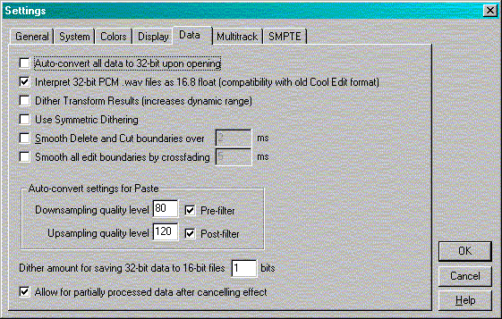

Competent software users
First, apologies for going OT again, but...
Take Cooledit, generate a 0dBfs sine wave, attenuate by 96dB, observe resultant 1k signal, and it's level, using the 'analyze' FFT function.
Andy.
Andy.

Koinichiwa,
Disable Dither (Options, Settings, Datatab - see attached picture) and voila, attenuate by 96db and you get digital silence....
Attenuate by 90db and you get the usual expected picture. Attenuate by 91db and you get digital silence.
I have included the original 0dbfs Wave File plus screen shots from the settings in a zip archive located in the file area of my Yahoo Group.
http://groups.yahoo.com/group/Thunderstone_audiophile/files/The -96db Dynamic Range of CD myth exploded.zip
Please amuse yourselves, all of you who doubt that you CANNOT encode anything below -90.3dbfs UNLESS you use Dither.
Now look guys, I have been a good sport, but my patience wears MIGHTLY THIN by now. Can you instead instead of insisting black is white please all go and do the darn experiment yourselves properly please?
I have so far indulged all this tomfoolery as I know what the facts are. But after this I will not respond any further, as this has really gone far beyond the pale. I am sorry if you all lack any clues to reality, honest. But if you do not wish to listen to the voice of reason, hey - who am I to argue. Do as you please, for me this topic is finally and permanently booked under QED.
Sayonara
PS, may I suggest to the Moderator to move this little subthread out of the main capacitor thread? That one after all is also really QED's as far as back-2-back 'lytics go but who knows, maybe there is some life left in it yet.
