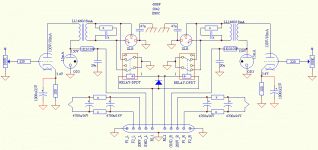

Still working on the details...this is what I plan to be working on. PS will be on a separate chassis.
Possible tubes are 6H6P, 6H30, 5842 and E88C (different bulb per channel). I guess usual suspects like the 12B4 may also be tried. I'll kick off with the first two, as I already have them. Cathode bypass may marginally be omitted. Any thoughts are welcomed!

...... Any thoughts are welcomed!
never omit grid to gnd 1M resistor .
if pot goes south (from any reason) without that resistor - your tube will follow it , even further to south ......

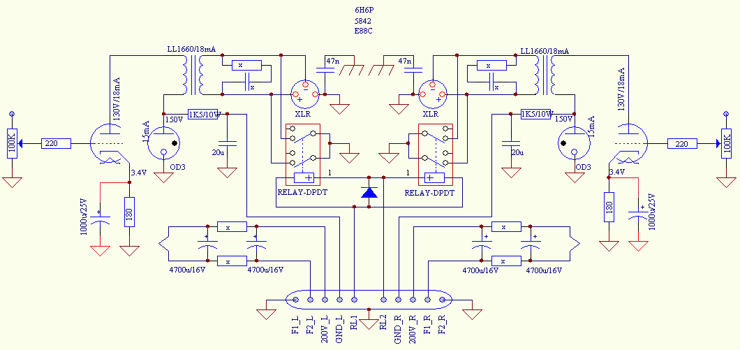

5842 into LL1630 works like a charm. 0D3 returned to cathode and fed by ccs. Do a search (Davitsk).
returning to the original SE iron loaded pre......what about a 76 loaded by a 1680 (4.5:1)? datasheet says ideally 15k driving impedance 76 is at about 10k.....? anyone?
1. I prefer LED biasing to bypassed electrolytics.
2. CCS to feed the OD3. Compared it against a resistor and there is simply no comparison. TO be honest the OD3 didn't stay long and i replaced it with a Salas shunt.

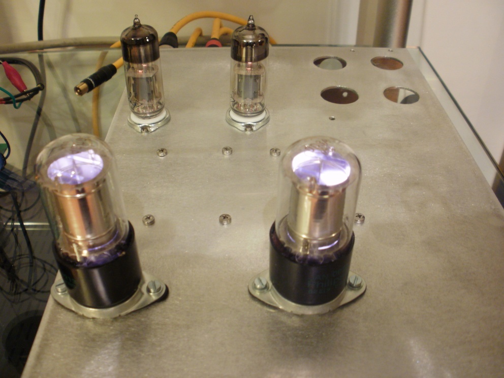

Just hooked it up yesterday and made some hasty measurements. Tubes are 6H6P with 180 Ohm unbypassed cathode resistors. Anode current is 18mA, gain is 11.5dB, Zo is 450 Ohms, all nice save for the nasty peaking at 85KHz. I managed to tame this completely with heavy output loading, but I'm taking Analog_SA's word, and settled for 8K secondary load. At least, to start with. Low frequency cutoff seems OK, definitely below 10Hz.
As is obvious from the picture, the preamp is in a very preliminary state, there is not even a volume control. I could not resist connecting just a resistive divider at the input, my CD player and power amp. I know, not least because of my previous failed preamp attempt consisting of a tube LTP, that first impressions are very important.
I only listened to Cat Power for about five minutes as volume was quite high, but that really sufficed. This machine sung right from the first second. I especially noticed that my cd player's harshness was gone and imaging was waaayyy improved, seriously less mental effort required to tell everything apart.
More work is definitely under way now, but spirits are up! Check out that gorgeous purple glow of the 0D3s! Stunning!
Probably due to the high volume setting from the fixed divider and the acoustic programme, it seems that I missed the lack of bass in that first listening test that is now quite obvious. Subjectively, it sounds like -6dB at 20Hz-100Hz. What's even worse is that there seems to be little difference whether the cathodes are bypassed or not, which tells me that it is the tranny that limits the BW, not the source impedance driving it.
I played around with the PS too, heavily decoulping the front side of the 0D3 load resistors, with very little effect.
Treble is not sparkling either, but I could live with that. The mids are good, but the low end is not acceptable...
I am thinking of ditching the 0D3s and decoupling at the trannies' primary, although really I don't expect much.

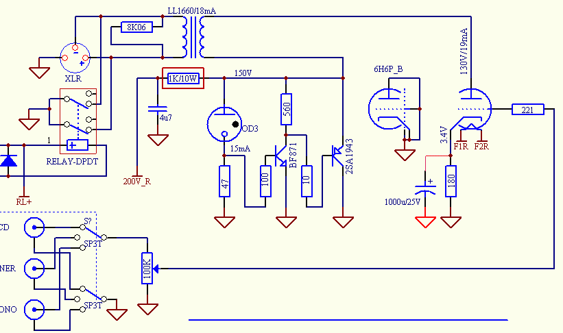

Well, I ain't giving up just yet! Attached is my new take. You see I'm not prepared to eschew the 0D3's glow so fast...
By experiment I determined that the critical factor for good bass performance is how low a shunting impedance to ground the transformer primary sees.
With the addition of the dirty silicon as per the attachment, impedance has gone down from like 100 Ohms to ~300miliohms. Bass is quite acceptable now, but I've still to fight with the cathode bypass cap.
What was really striking is how much worse an Alps pot sounded, compared to the DALE RN65 resistor divider.
Also the 1K resistor may well be replaced by a current source, which could also make the preceding regulator redundant.
