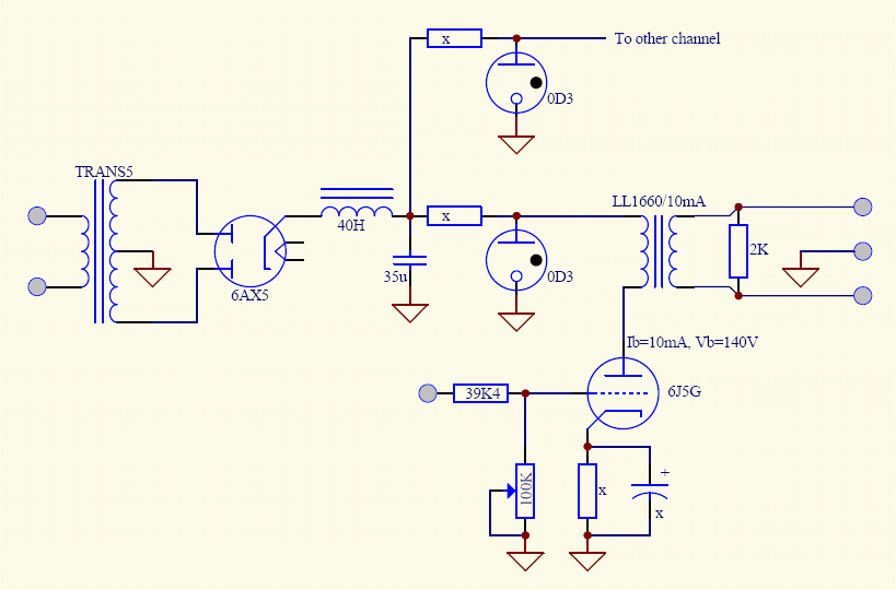

Mind you, them 6j5's, they don't go cheap eh? Not to mention the god**mn Lundahls, but will it play music?
did you calculate gain ?
anyway - I like big xconductance tube in that position .....

x19 from 6j5 = 25.5dB
-2.5dB from shunt volume control
-13dB from tranny
=9.6dB, if I am correct.

I built a transformer coupled pre that was originally going to use 6j5Gs but sticker shock got me to wire it for ½ 6sn7. I still used two tubes but set it up so that the two channels used opposite triode sections. That actually worked out pretty well as I was able to get some good tube matches by swapping channels.

After much frustration with a 6H6Π LTP design intended for SE to balanced conversion, this is my new line stage plan. Please openly comment/suggest!
What about the LTP 6H6Π circuit frustrated you so thoroughly? Just curious, I'm currently listening to a linestage with 6S4Π-EB as LTP and loaded with 20k:600 output TX's and find it quite nice.

Nothing wrong with the 6H6's. It's just that the LTP has IMHO an achilleas heal, namely the very high impedance point at the cathodes. High impedance - read very picky, unpredictable and sensitive. I found the current source dominating the sound, to the extend that I was solely listening to its effects. I tried bjt, mosfet plain and cascode and never was pleased enough...It's good to hear you have got good results out of it, but it is not my cup of tea...
The 1660 loaded with 2k sounds so horrible, you won't believe it.
Agree, don´t load with anything more than the following amp. The squarewaves won´t be as good as with loading but it will sound great.
revintage,the very high impedance point at the cathodes
the cathodes junction is supposed to be a very high impedance node, or the CMR and output balance suffers and the raison d'etre of the LTP ceases to exist.

How is the tranny best loaded to tame its resonances? If it sounds horrible by a seamingly half-sensible loading, it seems to me a can of worms has been opened! What would you suggest?

-----the cathodes junction is supposed to be a very high impedance node, or the CMR and output balance suffers and the raison d'etre of the LTP ceases to exist.
That is not entirely complete. Each cathode sees a parallel combination of the CCS and the other cathode. The CCS is very large compared to this value so it is not so high afterall.

Tough question hollow_man. Having played with both 10 and 18mA 1660 i don't think i really like them. Quite recently i tried the 18mA (4.5:1) again in a line stage, this time with a 6H30 and ended up prefering the sound of a choke loaded, cap coupled stage. Interestingly, using a proper Lundahl plate choke produced absolutely no ringing and bandwidth of almost 100kHz while using the 1660 connected as a choke rang as hell. Loading the secondary certainly helped with the ringing but the bandwidth was much lower.
I think i agree with Mr Davenport's experiments - it's better to parafeed a nice transformer than to eliminate caps but use an ugly one. Anyone interested in two pairs 1660 cheap? 🙂
Forgot to mention that a resonable compromise between sound/square wave is to use snubbers instead of resistors. Not quite sure of the exact values but something like 10k in series with 4.7nF seemed to work at the time.
No way...too many stories of ringing 1660's for me( both locally and on line ). Now if the price could compete with an interesting rock I could always use another paperweight.

Who could have guessed all this about the 1660...and nobody on the other side, too! Now I am totaly confused - better this than sorry though. Thanks so much for all your input.
