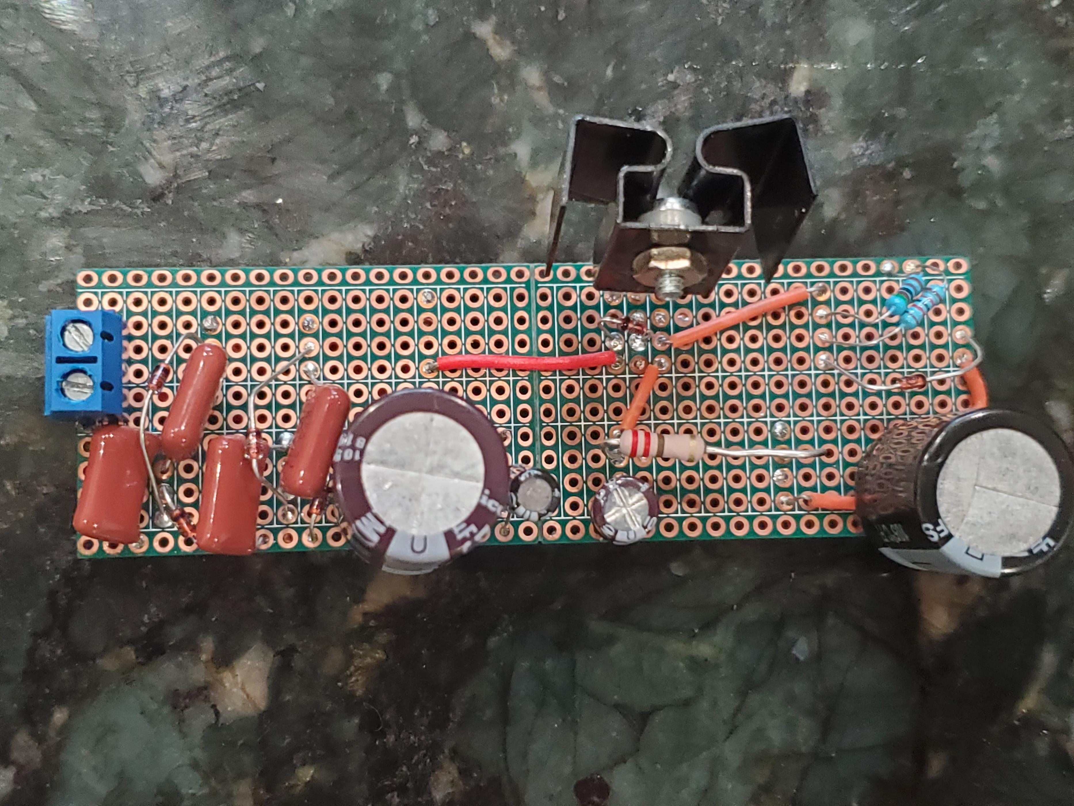

I managed to rebuild it and everything sounded good, but I found that I have a 60 Hz or 120 Hz hum. When I put the amplifier on battery it dissappears. I need to do a better layout on the PSU and report back.

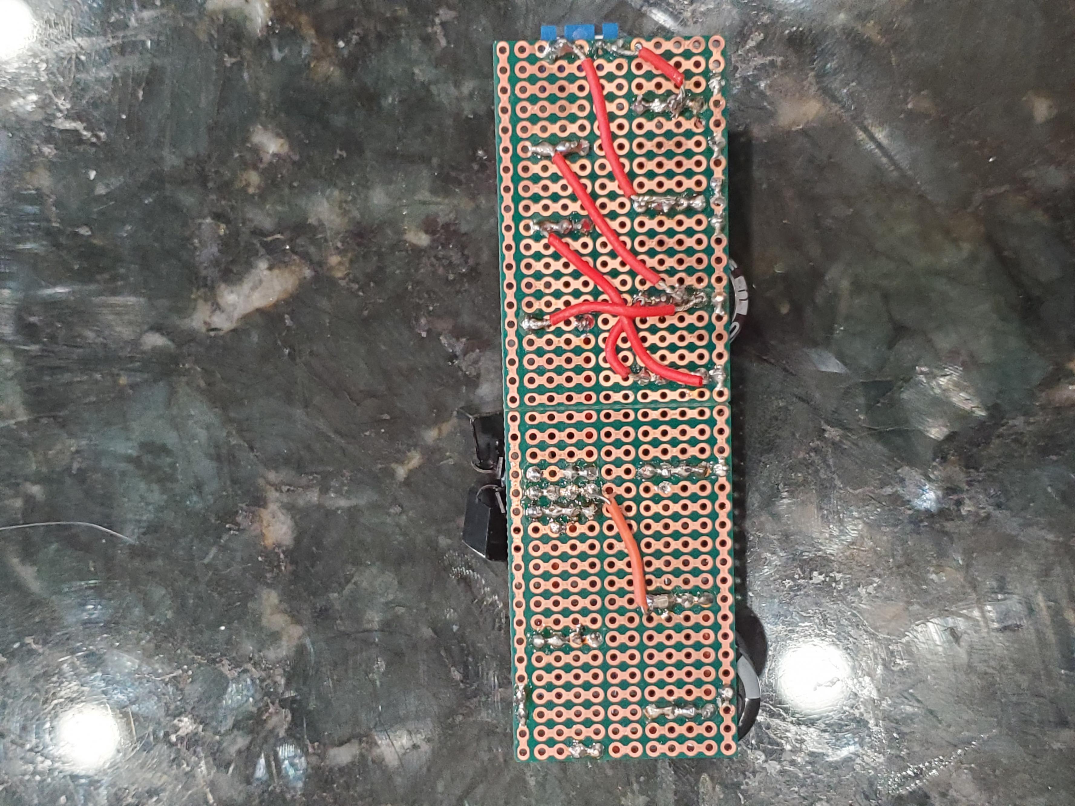

I finally built my power supply for this amplifier and immediately blew the fuse. Is there anything obviously wrong with my as built PSU from what you can tell?

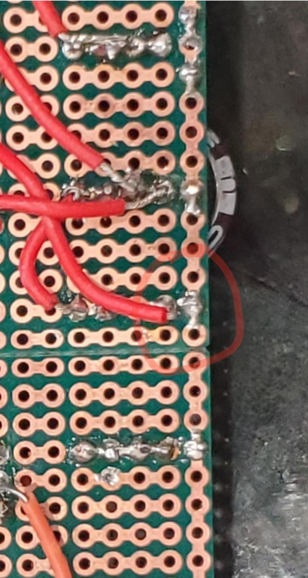

Just revisiting your previous photos of the board that let the smoke out.
Can't help but wonder if you had a short at the circled area:
attachment.php
Hard to tell by photos sometimes.

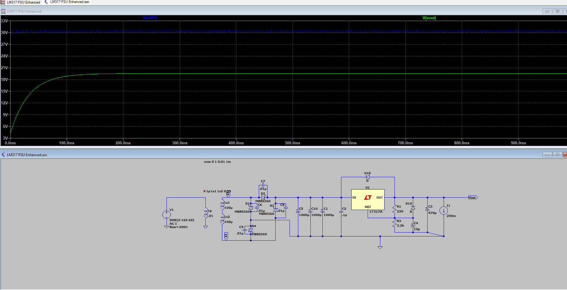

Based on some more reading, do you think this will be a better design with regards to ripple, PSRR, etc.? I want to have a better design, layout etc. before I try to rebuild the PSU.
  • LM317 PSU Enhanced.asc

Everything looked okay, but it appeared to be an issue with the diodes as well as some poor soldering. What do you think of this as a new PSU?
What failed in particular?
The diode cracked straight in half. I will be using 1N4007's from now on. Have a look at the new design?

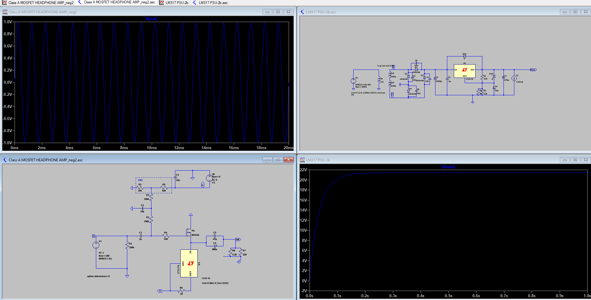

If you're concerned about PSRR then put the current source (I'd use a discrete one for lower capacitance) to the +ve rail and swap the FET for a P-channel one. Then the whole circuit draws a constant current, irrespective of signal.
What about the PSU now?
