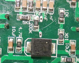

OK ... next step ... parts came in .. replaced wrong 20k with 10k didn't help .. and after checking the caps over carefully and comparing to new caps in the same range, I discovered that my meter was giving me bad readings because of both zero and span errors, and that the 4 10uf caps are at least 8 uf ... also that they are all ceramic caps and hence nonpolar .. I mistook the dc rating of the cap for an assertion it was polar .. resoldered every joint that looked questionable, didn't help .. so started looking at the circuit. The iraud350 was able to drive the transistors, why not the iraud200? So I looked at the iraud350 ... only one 10 uf cap ... so, how did they do the design without more of them? Look harder ... aaah ... it has 3 47 uf caps .. there are no such on the iraud200 ... Looking them over, comparing to suggested circuit schematics and tracing them around shows that one of these doesn't need to be very big ... it only stabilizes a tiny voltage reference current. A second one is the protection timer, so don't change that. A third one stabilizes Vcc and a fourth stablizes VB... Increasing the capacitance stabilizing Vcc and VB seems to shrink the ripple and allow my meter to read it more reliably. I can now see clearly that Vcc and VBS are both 12 volts solid as recommended and the unit still heats up. What that means is that a: Dead time is at maximum b: gate turn-on power supplies are good, so there is some other reason why it's heating up. .. Transistor gate charge not draining quickly enough? More entertainment to come.

So I have examined the differences between the two boards as well as suggested circuits to look for more clues. At this point, in other words, after stabilizing Vcc and VB, there are two major differences between the iraud200 and the iraud350 that I can see. The first is that the iraud200 has a much larger, but similar looking inductor (with the same nominal value). The second is what I currently believe our problem is. The iraud200 engineers have re-worked the feedback loop. ... DRASTICALLY!!! In the original circuit designs, the feedback loop has a 150 pf delay capacitor that charges through a 1k resistor, so that should add around 300 nanoseconds of delay each on/off cycle. This will considerably slow down the switching frequency. The iraud200 has no such delay capacitor, and in stead of using 51k total loop resistance, they have reached to 205k total loop resistance. What this means is that a: the feedback loop will cause significantly higher switching frequencies and hence higher switching loss. Notice also: they rate it for 50 khz audio range .. .. so this is an indicator that they are aware of the high speed. They are probably using something close to the full 0.8 mhz switching frequency and b:the speed-up could be responsible for some cross-conduction as well as high switching losses both in the transistors, and irs2092 chip and c:there may be some increased sensitivity of the circuit to ambient noise. The sales person asserted that 70 volts was a little high, even though it's rated for 80. That tells me that at say +/- 40 to 60 volts, this thing might be ok because of reduced stress on the components. Personally, I will be driving sub-woofers and would feel happier if the switching frequency were considerably lower. However, it may be good to retain 20 khz response for possible future use, so something similar to the original feedback loop seems to be in order. .. That means I will be ordering some smd components like 1k resistors and 150, 200 and 250 pf delay capacitors. .. a little delay switch would be cool, but not feeling that adventurous. also, 47k, 100k, and 3.3k resistors .. and I think that assortment will wrap up the problem. OK, next adventure on the way .. if/when I get this figured out, people won't have to research it all themselves.

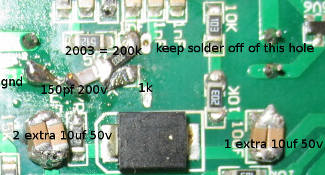

Success!!!
OK, my next batch of parts arrived today ... basically, I injected a 1k resistor in front of the 200k resistor, and connected the 150pf capacitor from the joint of those to the nearest ground. Turned it on and dreams started to come true. I'm sure the 50khz rating is gone, but no one needed it. I'm sure it's around 20 khz now. The board did heat up quite a bit in the first 5 minutes, but it did not overtemp. (I greased the heat sink to a much larger heat sink) I connected it to a 600 watt driver (a 12 foot bass horn) and started to push. harder, harder, harder, teeth rattling .. still no overtemp ... pretty soon I am smelling voice coil .. whoa whoa whoa back off. So I let it run and run and run at low volumes, and amazingly ... the hot heat sink began to cool down. ... Something changed (for the good amazingly) and I don't know what. That bothers me and excites me at the same time. this board is now working perfectly ... yay ... and btw I feel much safer switching the transistors at only 300 khz or so because that's way less stress on the whole circuit... it promises me longer life of the board. In a day or two, I'll come up with a photograph.

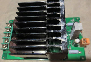

more success!!!
I used 5 ferrite beads .. two on one 0 volt line and 3 on the other. I believe this enabled both boards to get along with a single 0 volt line, cause it is working, and historically, 2 of these 2092 boards together on the same 0 volt for me always had trouble. Also note however, THE IRAUD200 HAS AN EXTRA RF FILTER ON THE INPUT That's right ... an extra 1nf capictor and 200 ohm resistor across the input lines. So this thing has already taken measures to shield its self from rf on the input. Once again, these two boards with ferrite beads are functioning together flawlessly. Yay!!!!!!!!!! All except for one single thing.
When I first start up the boards, they warm up and get quite hot, even with a lot of extra heat sink. ... but only for about 5 hours, at which time they cool down and so far it appears that after the initial heat-up, they cool off permanently until the next time you power them up. This is like really weird. I'll be looking for clues to this behavior. I have some foggy ideas, but ... well, not just the main heat sink, but the inductor ... heat up in sync. At one point, I thought there might be some kind of trade-off between dumping energy to the inductor and dumping it to the transistors, but no ..both are either hot or cool. This is suggesting to me that the 2092 chip may have some microcode or something that makes some kind of measurements and adjust its behavior over time, but no memory to remember what it learns. ... Just an idea that could be totally wrong, but these boards have two distinct behaviors ... hot and cool, and they both do it. The difference is huge. Even the heat sink I put on the inductor got so hot that I couldn't touch it more than 1/4 second. Next morning ... cool... and still working. If anyone has any ideas how this happens, please let me know as I would like to know and hopefully even stop it from heating up at the start. So, now I will drop a series of images.

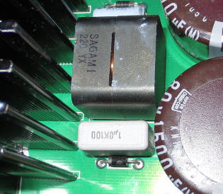

this image shows a large, white 1 uf capacitor. After running the boards for some time, they cooled off ... what I however didn't see because it was covered by the inductor heat sink is that that capacitor went bad or was damaged. It basically partially melted and squirted silver goo out the top. (I'm lucky it didn't short through, that may have destroyed the board) .. Reading the caps while the board is wired in doesn't work ... had to totally disconnect the boards to read them... after doing so, one of them read at 1uf as labelled, the other read at 0.5 uf. The 350 uses 0.47uf here as suggested by the original drawing .. The 1uf idea does suggest they were anticipating more current. (2 ohm) ... I suspect that the caps overheated the same time the other parts got hot .. probably the first time around when the inductor had no heat sink because the cap is right next to it .. in other words ... I wouldn't run this thing without heat sink for the inductor... fact that the inductor got hot proved that the output filters were working hard, which would also effect the caps.
Checking the inductors left me informationless as they read at 0.000 uh by my meter .. it doesn't read that even with shorted leads, so obviously something about the board is messing with the readings. The inductors still attract a magnet, so I know they aren't destroyed even if they have been altered by high temperature. Ferrite/iron powder Inductors can handle up to around 350 fahrenheit I'm guessing these are iron powder. I would expect that for higher frequencies like 800khz. I suspect that the larger caps may have something to do with the boards getting hotter in hot mode than the 350 did.
The boards were working beautifully and not getting hot .. I just dismantled them to start considering reconfiguring and remounting when I noticed the damaged caps. Inspection indicates they are rated for only 100 volts wheras I have other caps here rated for 275 to 400 volts which sounds a lot more convincing, so I opted to solder them out and replace them. .. but I think I definitely don't want to put in anything over 1 uf .. what I have available is 0.47 uf. I think if you are going to order parts to upgrade this board, I would look for high speed nonpolar 0.47 or 1uf caps rated for 200 volts or higher ... A great reason to want higher voltage ratings is that these caps are going to be punished by hf, so strong is good. Removing the cap showed that the board only called for 0.47 uf. It also shows that it calls for 200 volt, which the manufacturer failed to provide. I'm going to guess that since the board was designed for both 4 and 2 ohm operation, 1uf is the right choice for 2 ohm. I think the reason the manufacturer chose a 100v capacitor was probably based on size. my better, smaller caps fit into the same space and are bigger,. actually, anywhere from output to ground including across the resistor on the other side should work. One option would be to ring-terminal a cap onto the input/output terminals. Second thought .. I think I'll do that. Getting new caps into the holes was quite difficult because the top ground plane sucks heat and won't let the solder melt. Finally resorted to use of a very small drill bit and a drill. Then, my strategy of using ring terminals to attach caps to the output/ground terminals double payed off. I left the cap disconnected on one side and was able to verify that during hot mode, both the inductor and the main heat sink on the 0.47uf board ran cooler than the 0.96uf board. The boards agreed because shortly thereafter, the 0.96 uf board overtemped. It had been on for about 2 hours. Because the temperature of hot mode is my chief concern, I think I'm going to consider switching to 0.47uf ... then if I want more filtering, maybe I'll add a third filter pole .. a 10uh or so inductor at the output. It might even work to move to a four pole filter with two inductors and two caps. I'm looking hard to cool the board during hot mode or eliminate hot mode altogether. Anyone with clues is welcome to pipe in. I'm beginning to wonder if the inductors are properly doing their job .. if they drop to low inductance, the caps will start to look like a short to ground. There will be a lot of current flow and heat.. How the board can exhibit two distinct behaviors I still don't understand.

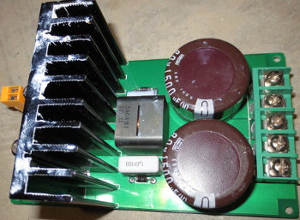

My red board arrived.
Didn't test it yet, because i'm waiting for the new batteries.
The output filter makes me wonder....
The inductor is a 'double-inductor', its print says '220'.
So this should be two 22µH inductors connected in parallel.
So the right replacement part should be a 10µH inductor with high voltage rating?
This would be much easier with knowledge about the switching frequency, because of a possible swap of the capacitor, too. (my output capacitor looks even worse than mgshightech's)
Are ring-core chokes a good choice on those boards?

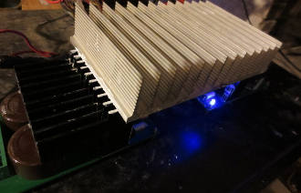

btw ... if you want kickass heat sinks to mount these boards onto for cheap ... heheheheh get this ... go to ebay and look up antminer s1 ... you will see that people are unloading tons of old bitcoin miners for considerably less than the components are worth. You can get $130 of heat sink/fan for around $40. I took one of these antminers and re-configured the location of the heat sinks. I have an old pioneer sx1250 that is powering these boards. It has a transformer good for around 1200 watts. If I grease this heat sink/fan to the top of it, I'm sure I can get more like 1600 or 1700 out of it. Later on I'll show an image of the amplifier with two monster heat sinks mounted to the top side of it. Its power rating will have risen from 160/200 w/ch to 600 w/ch. It will represent multiple pieces of history ... the 1970s hippy music days, the switch to class D amplification, and the cryptocurrency revolution. BTW .. the cryptocurrency revolution is totally legit, so take it seriously.
