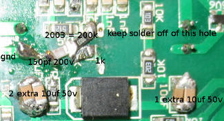

priority #1 get a heat sink on the irs2092 chip and make sure the transistors are heat sink greased and solidly mounted before you even dare power this up or all the fun will not last ... also .. I would not try doing this without 7 amp fuses on each incoming power line. If something goes wrong, those fuses will likely save you.

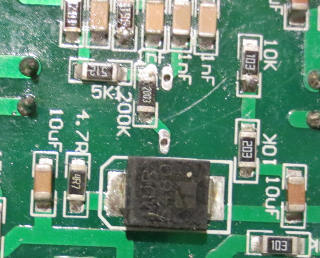

priority#2 mod the feedback loop (the 200k resistor .. there's only one on the board) as shown on the image
it's close quarters, so testing with your meter will help you to know what's dangerous. That resistor labelled 512 has one end that can be allowed to accidentally attach to the end of the 200k resistor (not the 150 pf cap) because it's already connected in the circuit layout. The tiny hole right next to that connection however is absolutely off limits. One tiny thread of solder to that hole and you'll have trouble .. I think you'll burn the fuse cause it will instigate exclusive positive feedback. One of the transistors will turn on solid. All of this detail is visible on the image that shows the feedback loop mod.
When you get the board, the 200k resistor connects the transistor outputs straight to the rest of the feedback circuitry. De-solder it and very carefully put it on an angle so you can connect the 1k resistor to the connection closest the main transistors that you just took the 200k resistor off of. The 200k resistor remains connected at the end closest to the rest of the feedback circuitry. Angle the two resistors so that they meet each other and solder them together at that meeting .. then connect the 150 pf cap to that junction and point it towards the little ground pole. It won't reach the ground pole, so you have to add some solder or a little wire and some solder to get it there .. Check carefully for stray connections and errors this is the hardest part of the mods cause those tiny parts wiggle all over..

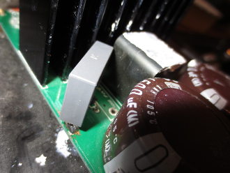

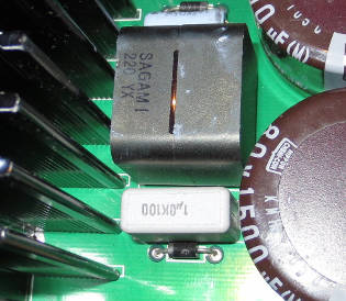

priority#3 swap the output filter cap for 0.27 uf as on the parts list and add the dampener circuits as shown on the images. One of the dampeners is 0.1 uf with around 3 ohms in series from top pole to bottom pole .. the important one is 0.22 uf with 4.7 ohm, 5 or 10 watt in series from speaker output to ground .. also 0.33uf with 4 ohm 10 watts is what I moved to .. both options work. Least important dampeners .. 2 small .01uf caps, each from one of the power poles to ground.

priority #5 add additional 10 uf 50v ceramic caps to the floating power supply so that it stores plenty of charge.
use heat sink plaster to attach heat sink to irs2092 chip
use heat sink grease to attach heat sink to inductor until you're satisfied everything is aok .. then remove heat sink grease and plaster it on. I would not use heat sink plaster to attach an additional large main heat sink .. in stead I would use screws or .. in my case, I'm going to use heat sink grease and a string and some springs for the final setup .. for the test setup, I just set the heat sink on top, with heat sink grease. For a fabulous set of heat sinks, go to ebay and look up "antminer s1"

the output filter cap needs replacing .. original one is 1uf 100v .. change to 0.27 uf 275v as listed on the parts list The new cap has to be angled to fit, and the ground leg won't fit in its hole, so scrape the ground plane with a razor and solder straight to the ground plane
the dampener circuits shouldn't need pre-post images .. the images are already shown .. they are the glued-on looking capacitors and resistors some to the underside of the board some to the speaker output. These dampeners kill the parasite. Also, the post image for the feedback loop mod shows additional 10uf 50v ceramic caps soldered to the pre-existing floating power supply caps.
