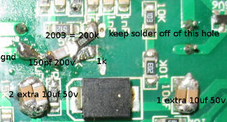

3. The fudgers did not follow the proper feedback loop specs from the example docs. Don't know why, but they made several changes. First, they eliminated the 150 pf delay cap and accompanying 1k resistor (really bad idea) out of the feedback loop. Second, they slightly adjusted the ohmage of the floating ground (no biggie) third, they eliminated the input capacitor and allowed you to direct DC drive this board .. it should in fact be able to output DC current (interesting, may find uses for this later) . You can forget about the DC input/output option they built in pretty much and not worry about the tweaked floating ground except that I think it adds a little hum to the output. The killer is the elimination of the delay cap and resistor in the feedback loop. This exacerbates the problems we already have, trying to drive the high gate charge of the irfb4227 by boosting the feedback switching frequency to around 800khz. It also feeds the parasite OUCH!!!! This thing is trying its hardest to burn out the irs2092. Turns out that the iraud350 does the same thing. If you have either board, you will want to fix the feedback loop.
To fix the feedback loop, order 150pf ceramic caps rated at at least 150 volts and 1k surface mount resistors of the proper size. This board has a single 200kohm resistor that acts as the feedback voltage reducer. You can continue to use it, only you have to put a 1k resistor between it and the transistors output, then connect the junction between those two resistors to ground through the 150 pf capacitor. This slows down the switching frequency and in my case allowed the board to run without overtemping. However, it was still very hot and it made me nervous to run it/them.

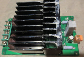

irs2092 heat sink ... just search for the words: heat sink 10mm x 10mm x35 mm

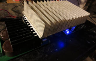

big heat sink/fan system to keep multiple main heat sinks cool .. only necessary for 2 ohm operation, and smaller options may work fine: look up the words: antminer s1
or for a single sink to mount to both boards try searching for these words:
heat sink 182 x 100 x 45mm
heat sinks for the inductors: look up the words:
heat sink 55mm x 50mm x20 mm or:
heat sink 40mm x 40mm x 20mm or:
heat sink 75 x 50 x21 mm (slightly wider than the board and cheaper than the others)

first set of mods
modb2s.jpghere you can see the additional 10 uf ceramic caps soldered in to support the floating power supply. I didn't add any to the first cap in that charge transfer chain cause I didn't think it would need it, cause its being fed by a regulated voltage, but it wouldn't hurt to put one on there as well. All three of these caps are sort of in a row. there is another 10uf ceramic cap closer to the end of the board .. it's related to the boards input and doesn't need any support. Also visible here is the feedback loop mod with the 1kohm resistor and delay cap. Notice the blob of solder leading over to the ground post. There was a ground right there so I used it. A short piece of wire may help to get that solder in to place. Be very careful not to get any solder into the hole as noted on the image, and also ... if you accidentally disturb any of those caps near the top of the image you could have a problem. In my case, after one of the mods, a tiny invisible thread of solder connected one of them to another one ( they had been disturbed and I separated them, but an invisible thread of solder remained) the thread sent the board into exclusive positive feedback which turned a transistor permanently on and burned several fuses before I recognized what was up, and eliminated the invisible thread by running the soldering iron through it. Of course, I had to measure in order to know the thread was there)

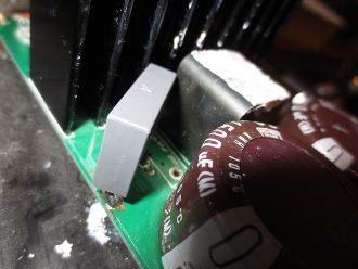

new output filter capacitor
the output filter cap was junk and caused trouble this shows the 0.27 uf cap I replaced it with. It was not the right size, so I ignored one of its holes as you can see and turned the cap on an angle. The second hole only connected the lead of the cap to the ground plane, so I shaved the ground plane with a razor and soldered the second lead straight to the ground plane (after cutting it about 1/8 inch shorter) as you can see. I raised the cap just slightly up over the diode so it wouldn't touch it. The legs were long enough, and the cap didn't poke up higher than the inductor, so it's good. It works

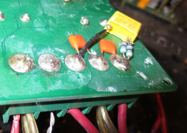

the second set of dampeners
less important than the first dampener, you can see the 0.1 uf cap coupled with a resistance and the two small 0.01 uf caps properly positioned here these caps help kill wigglies that may make it to the power supply rails on the board.

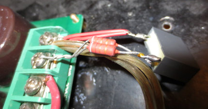

the crucial dampener
One of two things will happen .. this dampener (cap and resistor connected to the board's output) will kill the parasite, or the parasite will kill the dampeners resistor. I used a pair of 8.2 ohm 2w resistors in parallel and 0.22 uf 275vac (on the order list), the order list shows a 4.7 ohm 5 watt resistor to replace the two 8.2 ohm ones. When you power up the board, keep your eye on that resistor. If it starts to smoke, (could happen in seconds) then immediately power the board down. Or, even better, power the board up with only one lead fastened in, and then touch the lead that goes to the output terminal (right side of the image) .. Hold it for a few seconds.. if the resistor holds without smoking, you're good .. if it doesn't (never had that problem with this version of the dampener, cause this was the winning solution) then there isn't enough dampening, and the parasite is going to destroy that resistor in short order. Disconnect the resistor and power down the board and somehow get around 2.2 ohms, 5 watts between the output filter caps ground lead and ground. Then restart the board, only this time with both dampeners in place. If the resistors don't hold, I would be very surprised. In fact, I would be surprised if this dampener as shown doesn't de-parasite the board.
