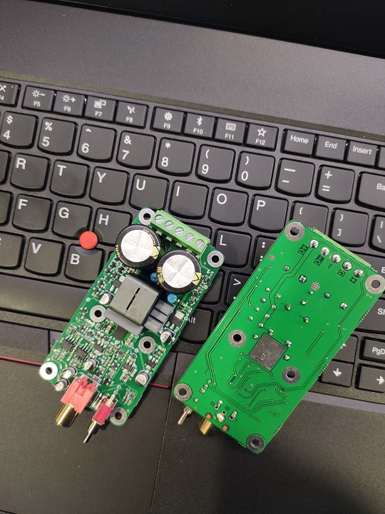

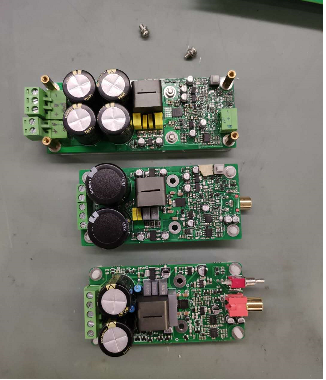

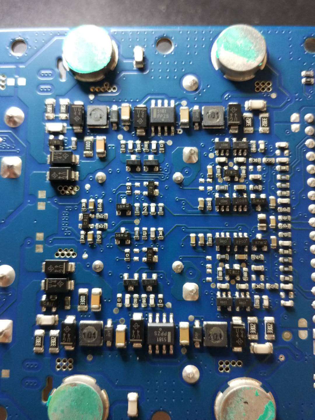

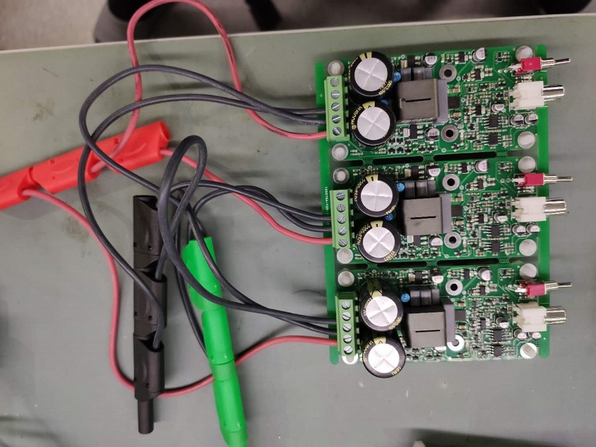

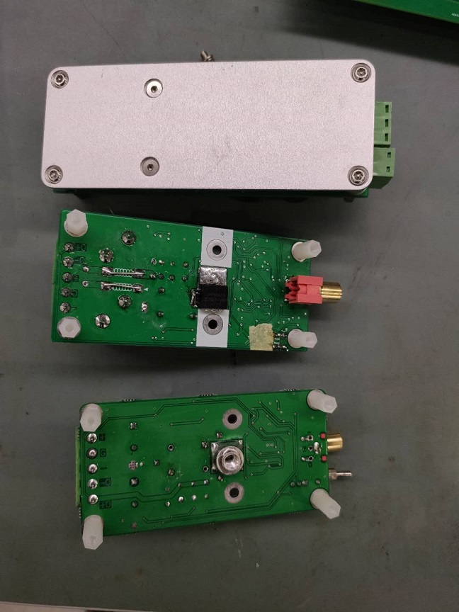

Actually, this chip is not so efficient as it mentioned in the application note. It do need the heatsink with high power output.
I make some boards with this chip, with dual 32V supply, it can get 120W @ 1% THD with 4 OHM load if you dissipate its heat well.(I use the SMD stud and burnt TO-220 transistor as the heatsink🙂)
I'll show some pictures as below.

Erica.C the IC is on the top layer? if so I think significant reductions in thermal resistance from the junction can be made. Did your board do 120W continuous with the pictured heat-sink?
Here is a load of testing data on a bottom side package:
https://gansystems.com/wp-content/u...rmal-Design-Guide-Enhancement-Mode-031815.pdf
the thermal vias are the largest contribution to the thermal resistance so covering a larger area than the package and using a thinner board can make a big difference.

RDSon is about half the value compared to TI TPA325x. Besides this the split supply and the DIY-unfriendly case make these chips not attractive for me. I prefer a single supply full bridge as preferrable topology for battery operation and for the lack of bus pumping as well.

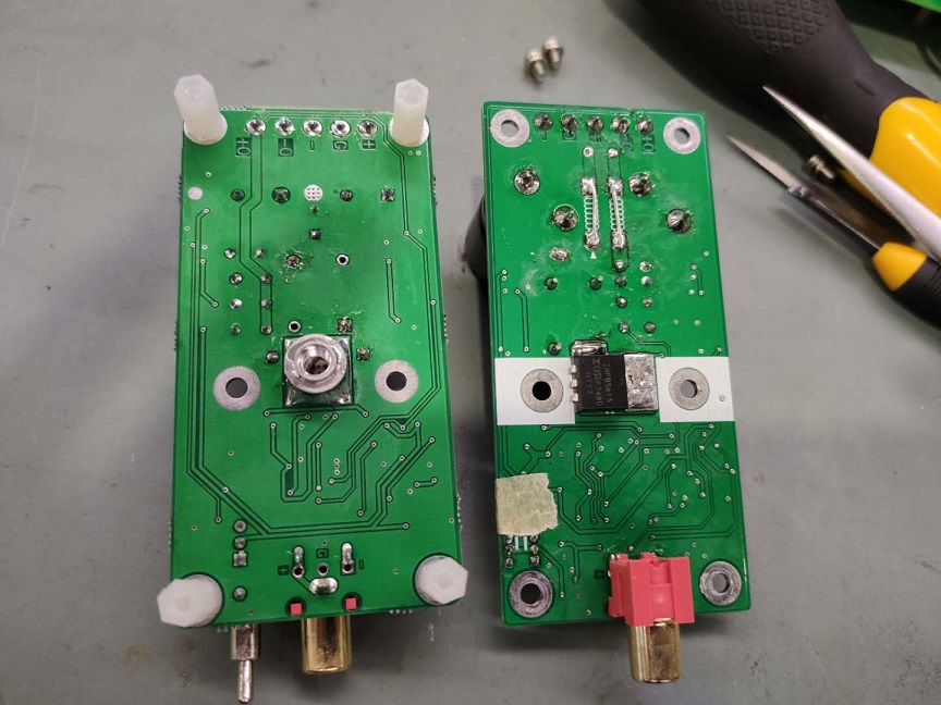

Yes, the AMP IC is on the top side, and some Vias connect with the VS pad, then the bottom side SMD stud is connect with these vias to dissipate its heat, with this stud on my board, i can get near 30W continuous power output with 4ohm load under open area. i think this is enough in reality.

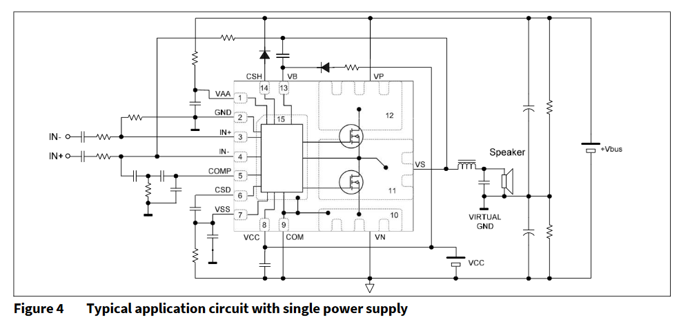

I have been working on my implementation of this chip. I was a bit perplexed at how brief the datasheet was but it turns out there are a number of helper documents:
https://www.infineon.com/dgdl/Infin...N.pdf?fileId=5546d46258fc0bc101598b13dd7d2d56
https://www.infineon.com/dgdl/Infin...N.pdf?fileId=5546d462533600a40153559b1bcc115c
https://www.infineon.com/dgdl/an-1164.pdf?fileId=5546d462533600a40153559a9bd31120
In my single supply design I have: CSH =64V, VAA = 9.6V, GND = 4.3V, VSS = 0V so that the floating analog supply is referenced to 0V and I shouldn't need coupling capacitors for the differential input to the IC. I think this is OK as per the datasheet limits? I will share a schematic of the alu daughter board when I'm done.
Nice boards :up:
I kind of like the stud idea. Have also seen this used in e.g. Powersoft LiteMod amps ... see picture ..... but these need to be solid alu or copper I think.
The upper side of a TO220 will not conduct heat very easily .... 😉
Have been looking for these kind of studs or spacers ... what is it for a alu stud you are using? ....
if you use a heatsink directly, the side of the PCB needs to be without components and through hole components ....
Also designing pcb mounted power components one should use as much copper area as possible for heatsinking directly from the PCB itself
PS. How do you solder the IR43xx chip ... hot air?? .... have been looking to buy a cheap hot air gun on ebay ... but not sure if they are any good ....

hmm I think now that the floating analog supply (VAA/VSS) must have to be centered about 1/2 the DC bus voltage otherwise there will be a DC offset present at the output due to the feedback resistor Rfb.
Using the floating supply capability is in many ways a simplification but seamed a bit power inefficient. The recommended floating supply zenner diode current is 1 - 15 mA (a bit of a big range!) and worse case 1.2W dissipation with a 80V supply. No indication of an optimal value I guess I will have to reverse engineer some dev board schematic!
Well the mystery deepens. The IRAUDAMP17 design runs upto 27mA of VAA/VSS current at its maximum 54 volts which is beyond the absolute maximum rating of its internal zenner diodes (20mA) and so it has external zenner diodes! so perhaps performance isn't very good at low zenner diode currents? I shall start with the minimum 1mA @ 30V supply and work up from there if I have issues.

I'm glad this design can give you some hints. And I use the hot air gun to solder this IC. It's not so difficult if you have some try.
For the stud heatsink, I use the PCB SMD NUT, it's standard part, try to google it, you'll get a lot.
BTW, my design of this IR4301 amp module is not follow the application note. It's the post-filter feedback. Indeed, the IR4301 is IRS2092 + powerstage, so you can implement it with the post filter design.
