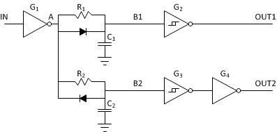

Sorry, for not included more information. The schematic can be seen in the pdf. I change the dead-time to the one in the second page. I added the deadtime after the LM311n comparator. I need to design a H bridge hence the reason for the deadtime. I have a common ground in the circuit, this ground the low side MOSFETs and the scopes at one point in the circuit. This voltage drop I'm experiencing means the driver is damaged or the driver's undervolatge lockout activated. When the 12 volt supply is not connected, the PSu reads 12 but when connected decreases to 4.9v.

What family are the logic gates (Schmitt triggers and inverters) you showed in your deadtime thumbnail? If they're slow (compared to MOSFETS running at 30kHz), the extra full-gate delay may be causing unexpected trouble. They need to use the same supply voltage as the 2110's Vdd, pin 9.
The 1N4148's across the 10R gate drive resistors as shown by rayma is probably a more reliable and direct deadtime solution than the RC/Schmitt trigger delays -- especially since a Gate-stopper resistor is needed anyway.

I am using a cmos hex inverter (CD4069), but I think I will try a Schmitt triggers hex inverter (hef40106bp.
Will the diode over the gate resistors be sufficient for a H bridge configuration?The 1N4148's across the 10R gate drive resistors as shown by rayma is probably a more reliable and direct deadtime solution than the RC/Schmitt trigger delays -- especially since a Gate-stopper resistor is needed anyway.
If you're already running Vdd at 5V, I'd change to 74HC14's or similar -- but it really HAS to be a Schmitt trigger. That delay technique is clever and handy, but yields inconsistent delays. Also, the positive-going threshold is different than the negative-going threshold, which complicates design. Still worse, 4000-series parts are dreadfully slow on 5 Volts. If you want to continue testing before fitting an HC Schmitt trigger, just bump your Vdd up to the 12V Vcc or even 15V. The 4069 will then provide adequate (for testing) speed.

Sorry I'm just getting to your full schematic from post #3 ..
The 4070 XOR is better than a 4069 could do -- that way there isn't an extra gate delay in just one path. Still probably oughta run it on more than 5V.
I hope the actual delay is implemented more like the thumbnail schematic, and not like the full schematic. In the latter, C5 and C6 won't affect the delay until RP1 and RP2 are so low that the driving gate is excessively loaded, which will add more jitter and unpredictability to the timing. And the delay will be similar for both edges (except for differences due to threshold asymmetry).

When I tried the Xor gate circuit with the ir2110, it resulting in a lot of overshooting in the outputs and also between the MOSFETs. That was the reason for the change of dead-time circuits.

When I tried the Xor gate circuit with the ir2110 ..
I didn't mean to recommend the XOR circuit as is. Just observing that it can provide approximately matching delays when one channel becomes two -- one Inverting, one Not Inverting. Not sure what you mean by 'overshooting in the outputs', but within one family -- 4000-series, 74HC, etc -- the wave shape coming out of the single-edge-delay circuit *should* be the same. The capacitor-in-series/trimpot-to-ground won't do what you need. The approach shown in the original thumbnail, signal passing through paralleled diode/trimpot then to small capacitor with its other leg grounded, WILL.
