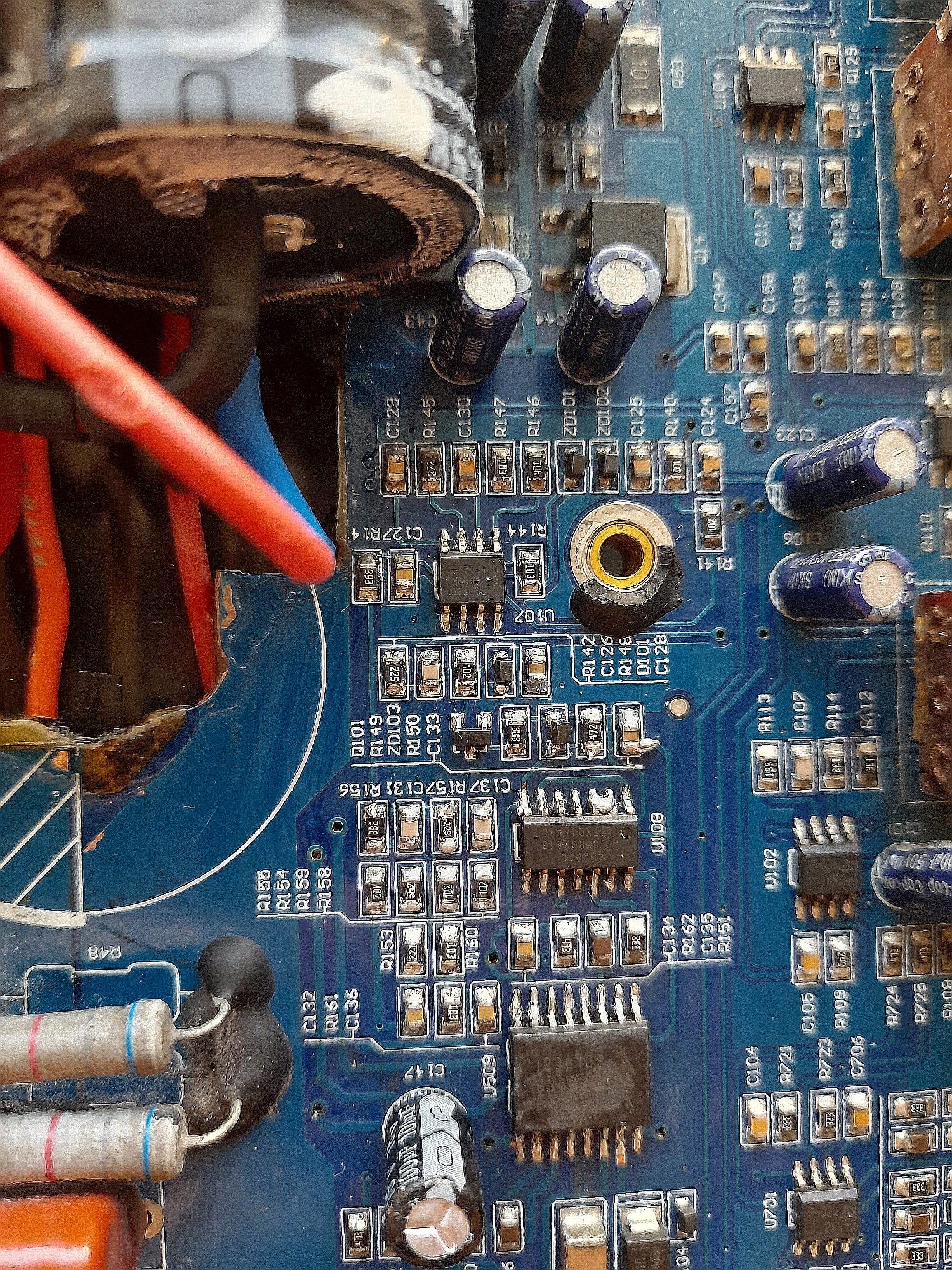

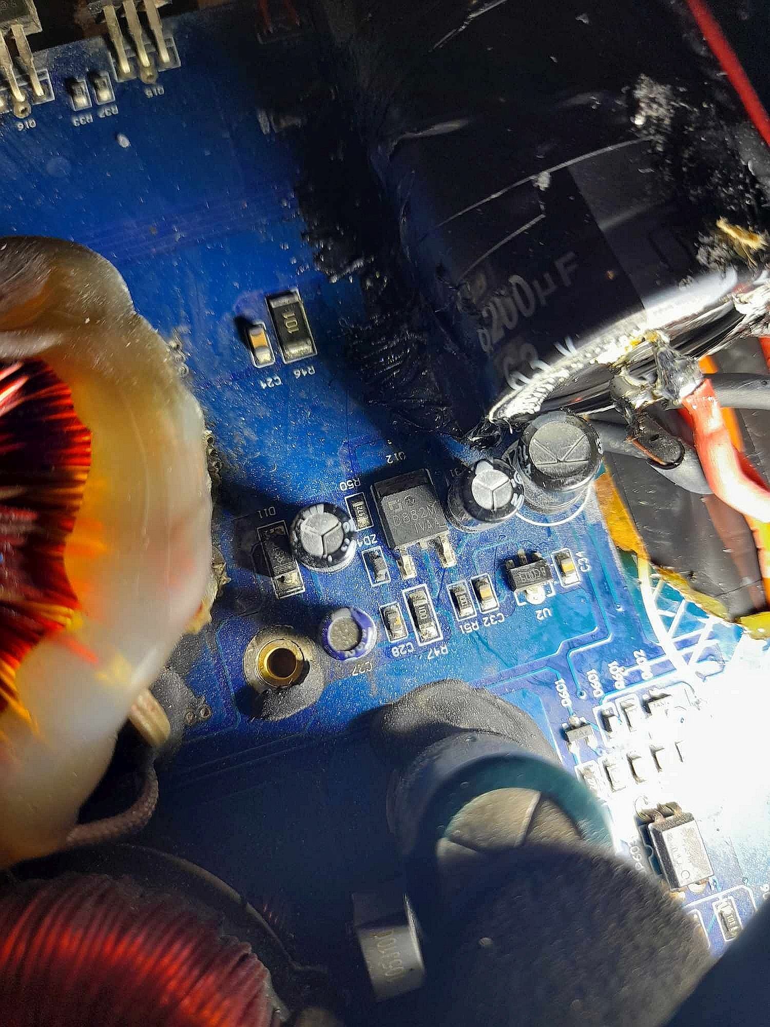

IR2010 burnt traces
Do you have rail-rail oscillation when there is no excessive current draw? = NO
But if I remove the output mosfets and play some sinewave thru the RCA I can see nice square waves at the low side gates as they should be.
Is the circuit before the IR2010 like the one in the diagram I posted? = in general mostly yes., but there is no lm311, lm555 and u16 (74AHC1G04 Inverter SOT-235)
U9 + U16 are actually the same as 74hc02d in my case.

Okay, I've just noticed that if I rotate even slightly the LPF filter knob, it goes excessively overcurrent immediately, with no load and no RCA plugged.
My theory is that maybe during the rail filter caps explosion some of the small SMD ceramic capacitors have been damaged (I've already changed 2 of these as the original ones have fallen apart, and since I do not know their capacitance, I just used the 100 nF highest voltage rating I had) which are being used in the preamp and the class D section due to their proximity to the rail caps. But without the service manual, there is no way I could know their voltage ratings and capacitance.
I've changed a couple of smd caps, taking as a reference the infinity schematic and looking at their values. Pulled the mosfets out. At the low side gate I can see square waves at 68Khz. I suppose it's self-escalating design. But once I fit the mosfets in...it's not stable at idle anymore. Draws a lot of current and the mosfets are heating up really fast. Is there any information in Your guide Perry how is the deadtime set or it is more like design/driver ic related ?
