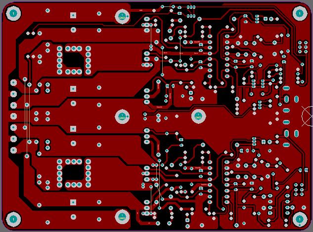

Bremen, I agree with you. And I will explain my POV a bit later, with the risk of being of-topic. I'm a European living in Cxina so I see the things from inside out.
Currently I have just two such boards: Connexelectronic on stock and there are little chances to make a new batch anytime soon while my cost is as least as the selling price of any iR7 amp clones found on fleabey or tobao and the sales of this board is not that hot as it was before. Why I call the others clones ? because their PCB's are 100% prints of the IRF gerbers. At the time when I made this board, I completely remade the layout, I just kept the position for the components and remade the layout from zero as can be seen in the attached image. Several components were changed, others upgraded, so I could get 500W on 4R on each channel and if the board was supplied at +-86V even 700W+/4R. I use only 100% genuine and best quality components, pcb and accessories (heatsinks, heatslugs) and this combined with a low production quantity (50-200 pcs each lot) cannot be competitive with those which are made in bulk quantities with the main target being lowest cost no matter what parts are used. Is not a secret anymore that some boards sold mostly on ebay and taobao use the cheapest components available often from unverified vendors or doubtly quality. They certainly not do-it without profit. Even if the prices are so low, often below good-sense threshold.
Trying to keep myself on the wave, I made the following two boards which are an example with a very tight profit margin, below 10 usd for first and around 5 usd for the second. If the price for one essential component will rise, such as the IRS2092 IC, or the output transistors, or even the assembly cost (the wages had doubled here in the past 4-5 years) I found myself in loss.
Connexelectronic
Connexelectronic
Why I'm doing them so cheap ? Recently most of the customers if they have to chose among let's say, 3 vendors which offer class D amplifier modules (I not give names) first of them has very good sound quality, second has a very high efficiency and low EMI and the third has a very compact size and shape, most of the customers would chose the fouth one, the cheapest, and often with no regard to quality. and after several attempt to mod this module, often solded with failures, will eventually buy one or more modules from the above mentioned vendors.
It might sound foolish, but with these modules, I tried to make a compromise between all the 3 mentioned vendors products at the price of bulky sellers. If the idea might prove successful, I will add few more other boards too, otherwise I will stop selling them when the stock will be finished.
Connexelectronic
Connexelectronic
