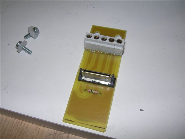

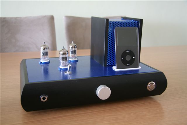

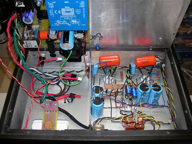

I've been doing some research on this because I want to build a tube amp that will be able to charge and play my iPods/iPhones all from the 30-pin connector. The pinout you posted is the same one I've been studying and it seems to be pretty accurate from what I can tell. The iPod needs 5v/500ma DC for charging so this is what I've come up with:
I purchased this cable: 3.5mm Audio Line out+Usb Dock Cable for iphone ipod - eBay (item 290447626660 end time Sep-20-10 06:25:27 PDT)
That will take car of audio portion...you can just clip of the 3.5mm plug and use as needed. Now in order for the iPod to charge, you will need to do something with that usb plug, and supply it with the power specified above. These easiest solution I've come up with is to use the guts out of one of my old Motorola phone chargers, which have a mini-USB plug on the end. These chargers supply the perfect charging voltage for any USB device (iPods/iPhones included). I'm sure you could find one of these chargers for a dollar or two since they are so abundant. You'll need to clip the mini-USB plug off the end of that charger cable and then cut the female end off of a standard USB extension cable. Wire these two together using a standard USB pinout (very simple, only two wires need to be connected to the correct pins). At that point, you'll have a standard sized female USB socket to plug the USB portion of the cable into. This is the easiest way I've figured to make this work. As you do more research into the iPod pinout, you'll see that it's not as simple as it seems (certain resistors are needed in certain areas and certain other pins need to be jumpered to ground for it to work)....that is why I don't really recommend trying to make your own iPod connector and to simply use one that's already made and then modify it. Although I haven't completed this yet, I see no reason why it wouldn't work. A pic of my Motorola charger:
-Wes
