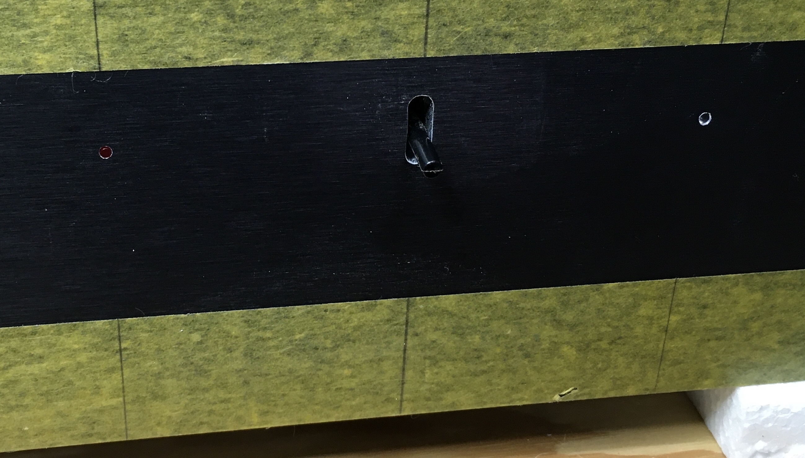

I just drilled a 2 mm through the front plate (10mm) with my handy hand-drill with no issues at all, LED flush to the edge. (The backside was another story though [emoji15])
Wouldn’t hesitate to go 1 mm, but lower than that I guess some other tools would be necessary…
OK Understood.. The front one.. yeah that's a though one.

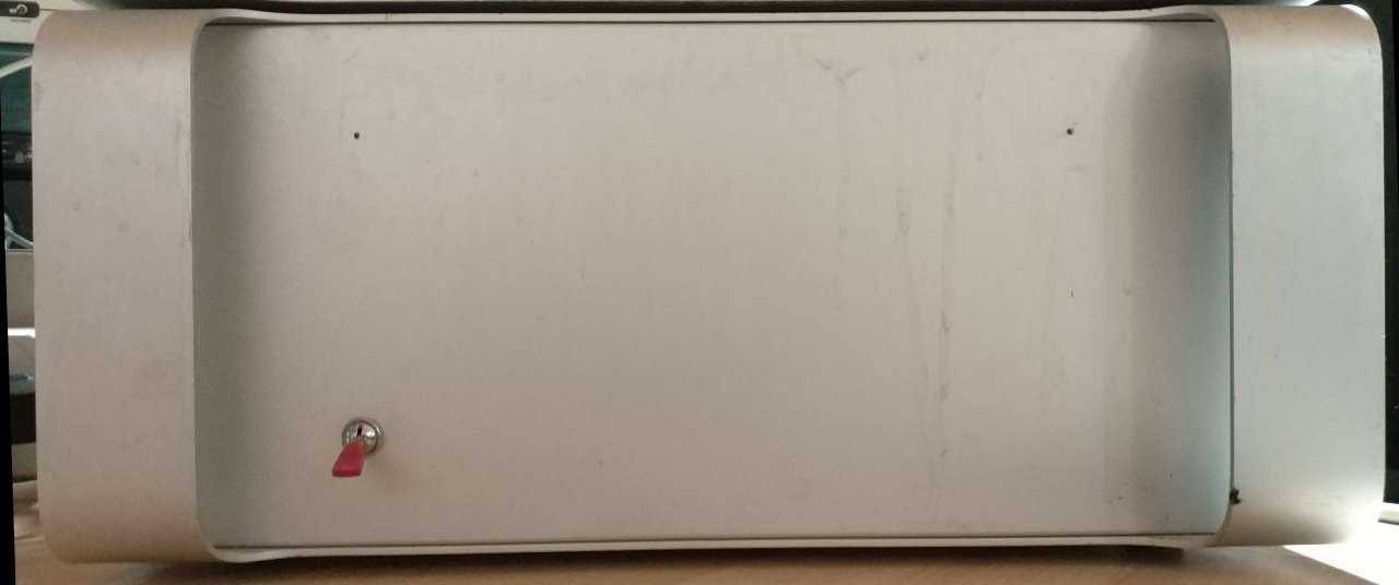

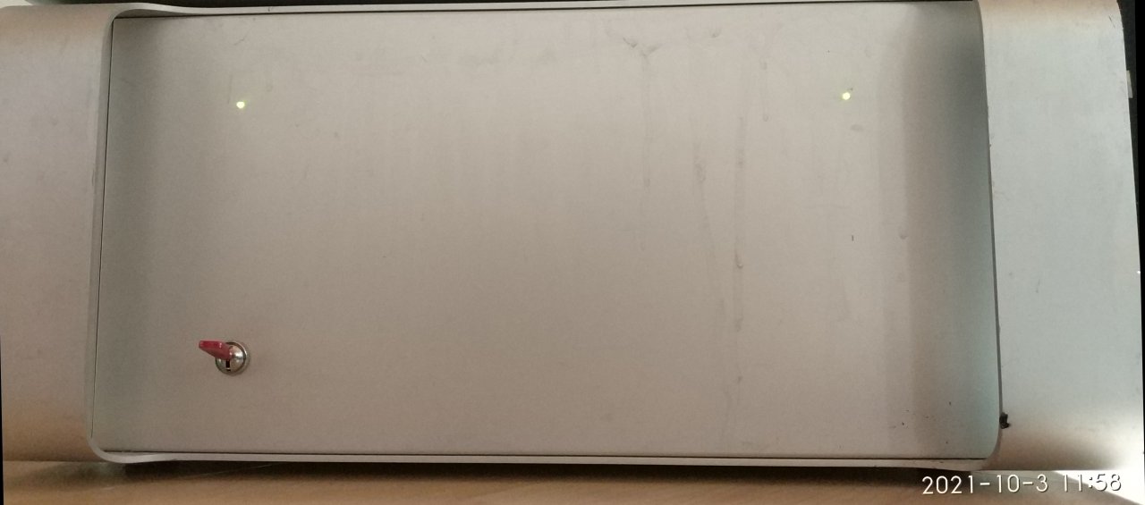

Pic shows Front of a Class A I build in 2013 first without and then with light..

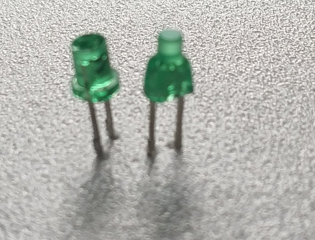

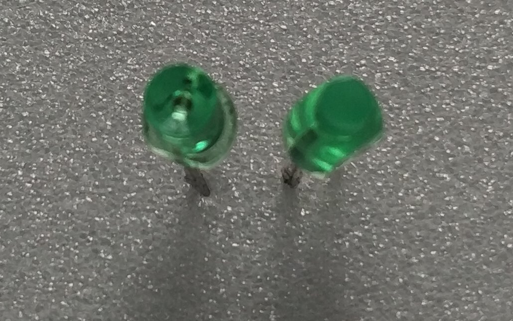

The other two pics are the LED I USE . so all one has to do is to drill first 2mm and then the shaft of it which is 4 mm.. then the LED can be just nicely inserted,, also no need to glue and it will look nice from in as well from the outside..
LED I bought several different colors.. Usually I use blue or white.
