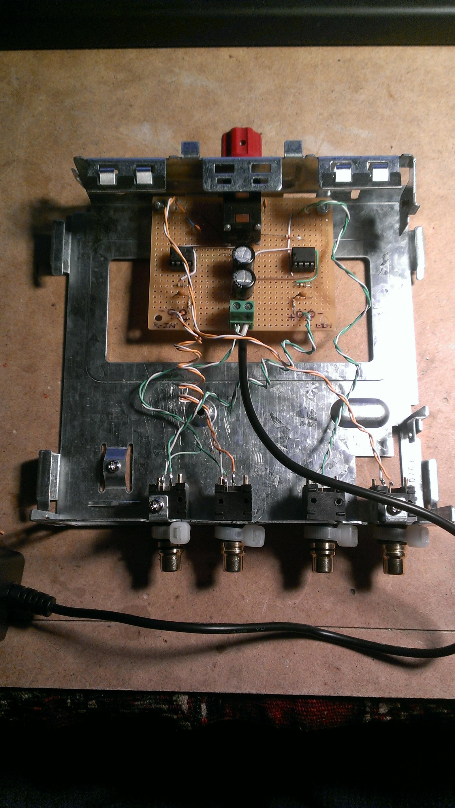

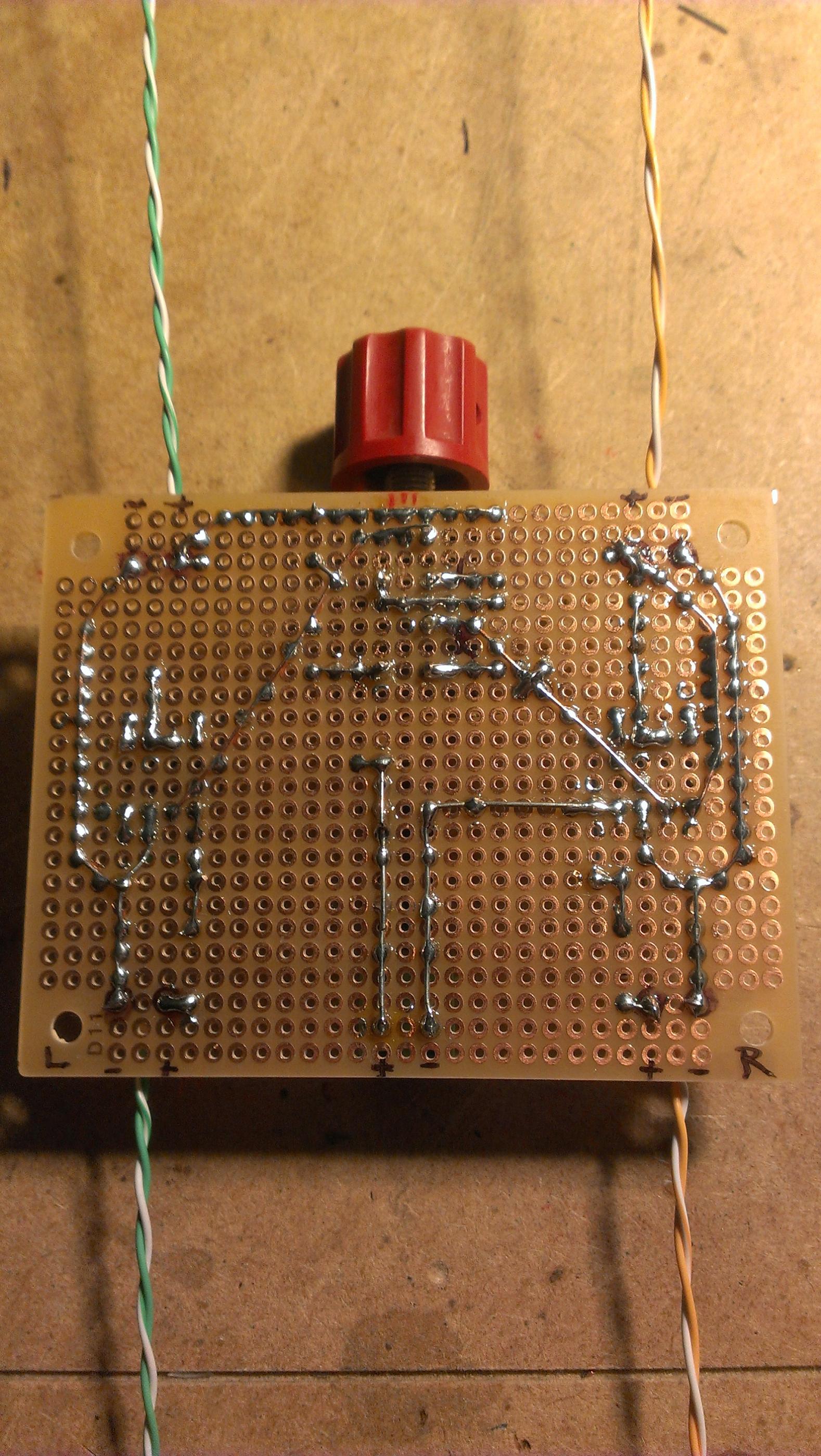

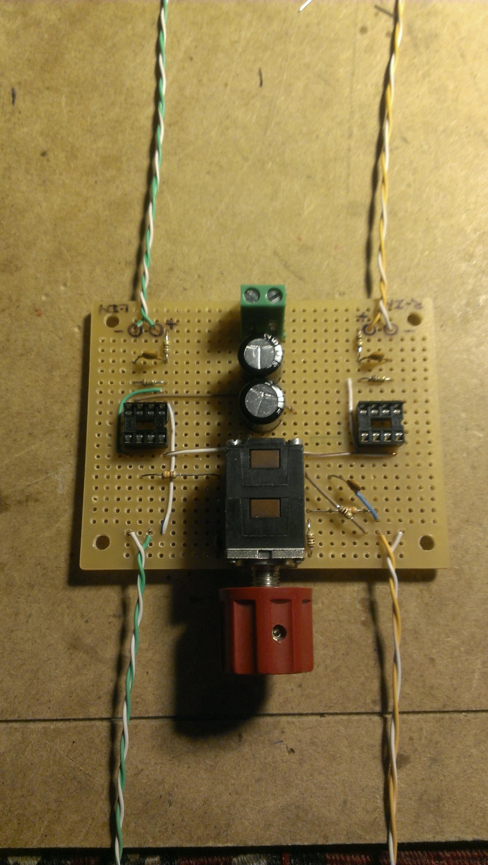

This circuit is known for decades and allows gain setting over a bigger level range than with a passive pot provideing a good noise performance as well. You can find it in analogue mixing consoles.
Nothing esoteric with it.
But the potentiometer they use looks like some el cheapo low quality stuff, anything else but high-end.
Fast Eddie D, I would like to know your circuit. We are here to provide ideas and circuits that work.
It's just a unity gain buffer behind the volume control. It's as simple as a wikipedia circuit. Provide local bypassing on the board. Capacitor couple what you need to for your circuit. You can even configure it for gain with the addition of 4 more resistors.
It just varies the gain of the active circuit. It's very useful.
This is the issue with the circuit. If the potentiometer displays any intermittent operation, then the circuit goes nuts. Any scratchiness is amplified in a nasty way. Any nonlinearities in the potentiometer are amplified.
