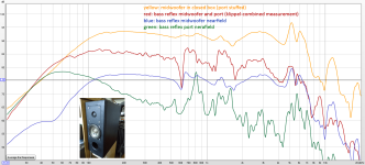

my interest in port resonances started when during the pandemic and after nearly 20 years I finally started working again on a set of two-way-speakers that I never completed. these boxes have (or had) some severe flaws:
- tweeter mounted centrally and even with the same distance to the top baffle edge
- air leaks around the woofer basket
- similar height and depth of the enclosure
- quite resonant and too large 5 cm diameter bass reflex port mounted on the front baffle
this is how the NF-response of the midwoofer looked like, with open and stuffed port:
lots of bad resonances and cancellations between 550 and 2000 Hz!
