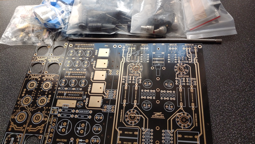

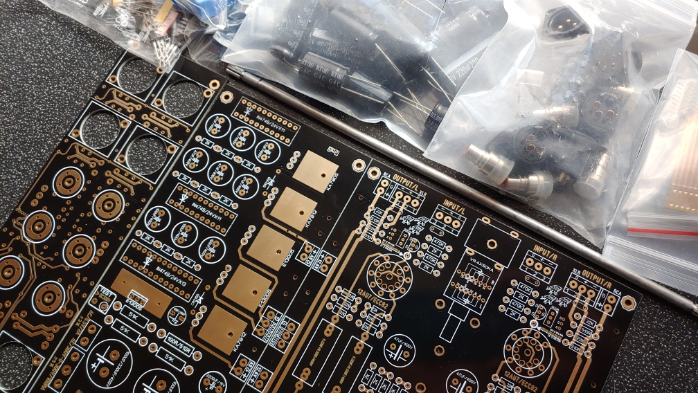

I bought this kit some time ago. Just getting into it to start the build. For power transformers i wanted toroidal to keep electrical noise down. Had to get two separate ones. I am currently located in the Uk but will be moving back to Canada at some point so also needed duel primary voltages which was a bit tricky to find.
For the moment i am only interested in balanced inputs and outputs so didn;t bother getting the 600:600 transformers.
Just going over the boards and components it looks pretty good. Would upgrade the coupling caps and tube sockets. Also will upgrade the in/out connectors to gold plated and signal relays to better units.
Will post what else i find.

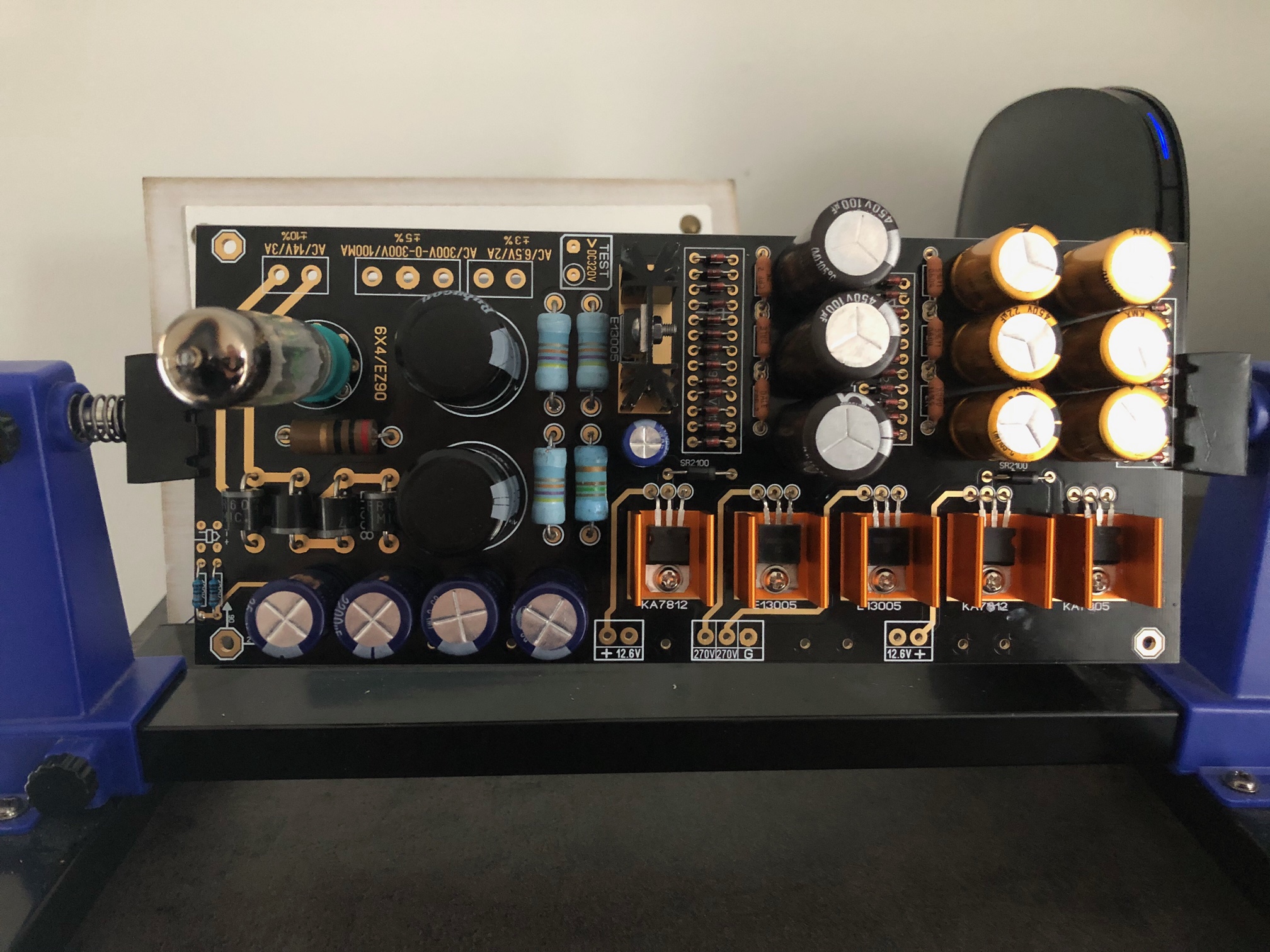

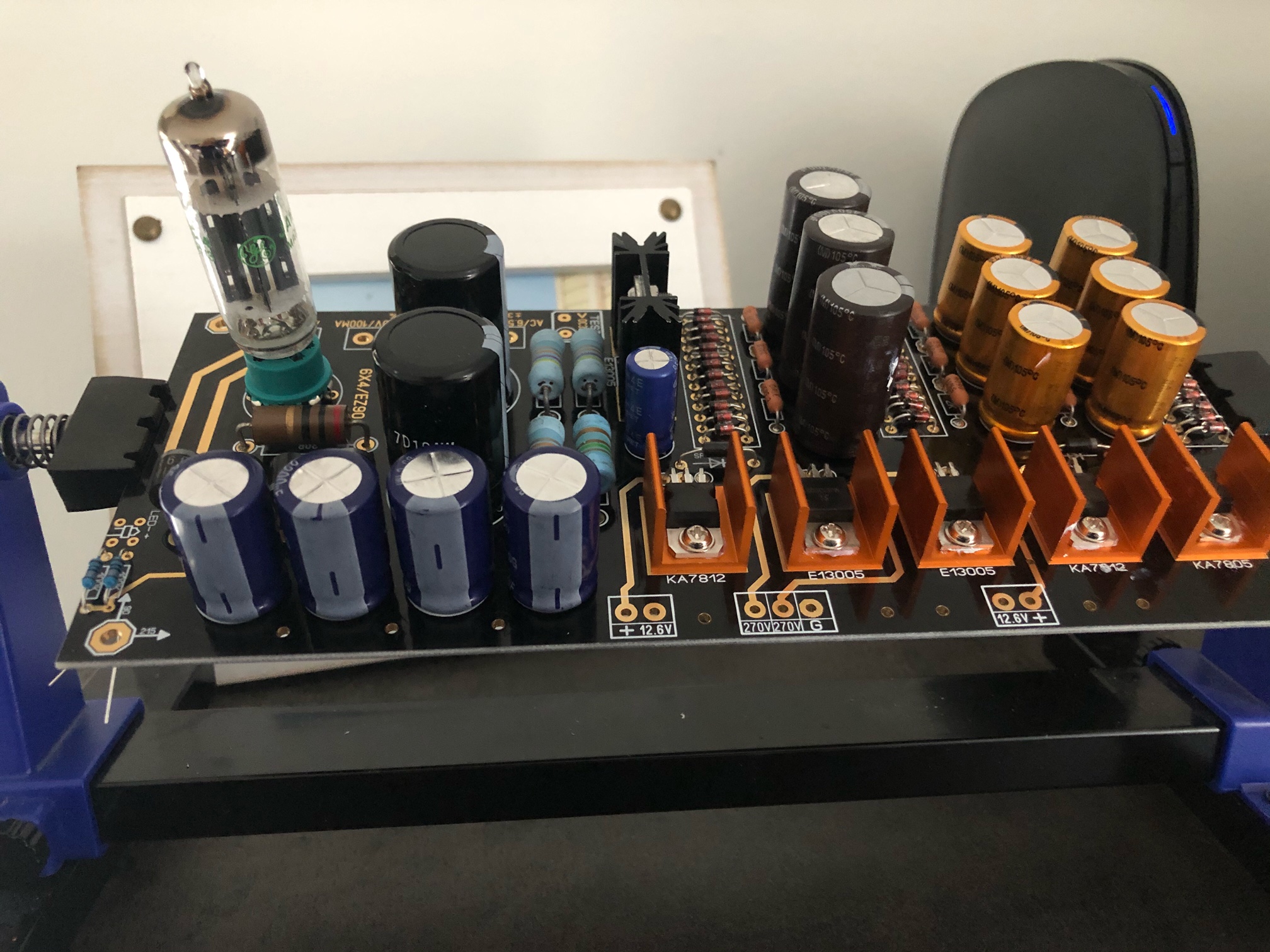

Power supply built
Last week finished up the power supply board and powered up. Blew the first fuse (1A fast blow). Switched to a 3A slow blow and all ok. Probably just a bit low rating on the first one.
Output voltages all very stable, although no loads yet. It's a clever design with very stable voltage references (series diodes).
Some of the capacitor values supplied are not quite the same as the schematics. They suggest spacing the components off the PCB a bit for heat dissipation which seems like a good idea as tube amps run hot.
I'm using a Toroidy TSTA 220/001 power transformer. Might not keep it for the final build.
Now on to the amplifier board.

Very appetizing pictures. The boards look like a good quality. What is the clever part, the defined voltage drop over diodes?

The diodes provide a very stable and predictable voltage reference for the valve plate b+ supplies. They just put enough in series to get the required reference v.
The PCB's seem to be of good quality, at least to my eye.
I do see some areas for improvement on the audio side, mostly with component quality. Will eventually get better coupling caps, switching relays and audio connectors at least.
The pcb's have the valves mounted on the same side as the rest of the components. It's clearly designed to be mounted inside a case, that is, with the valves inside and unseen. If you like the look of the valves being visible then different mounting and connection will be required.

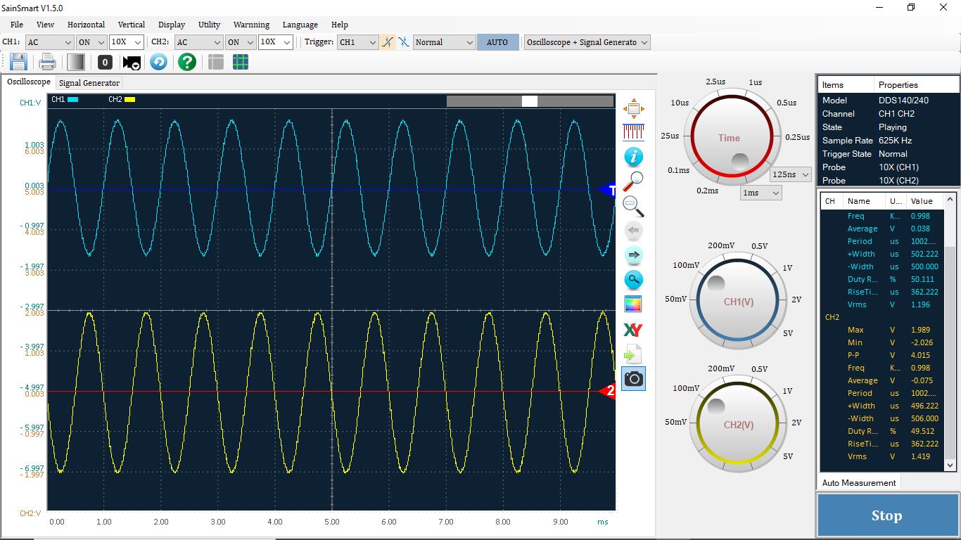

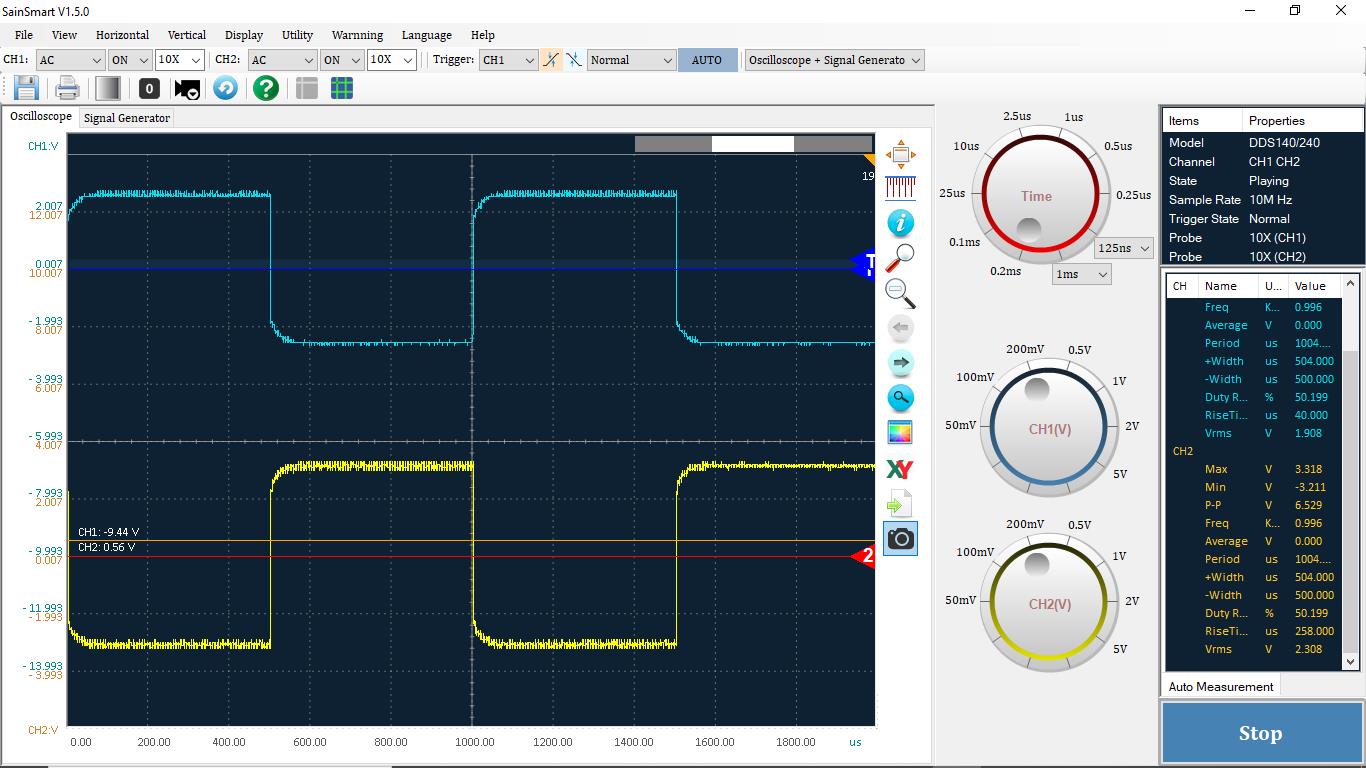

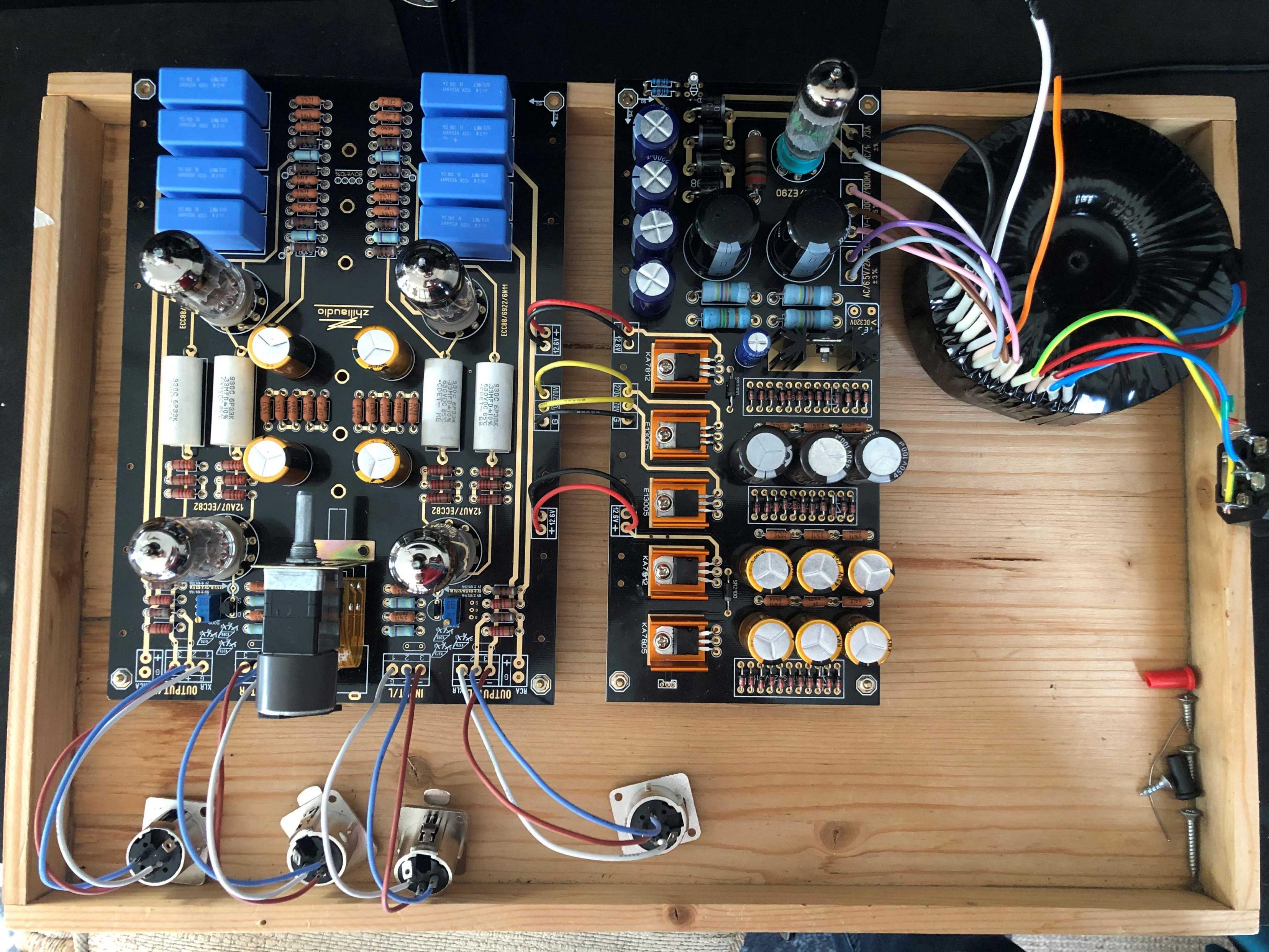

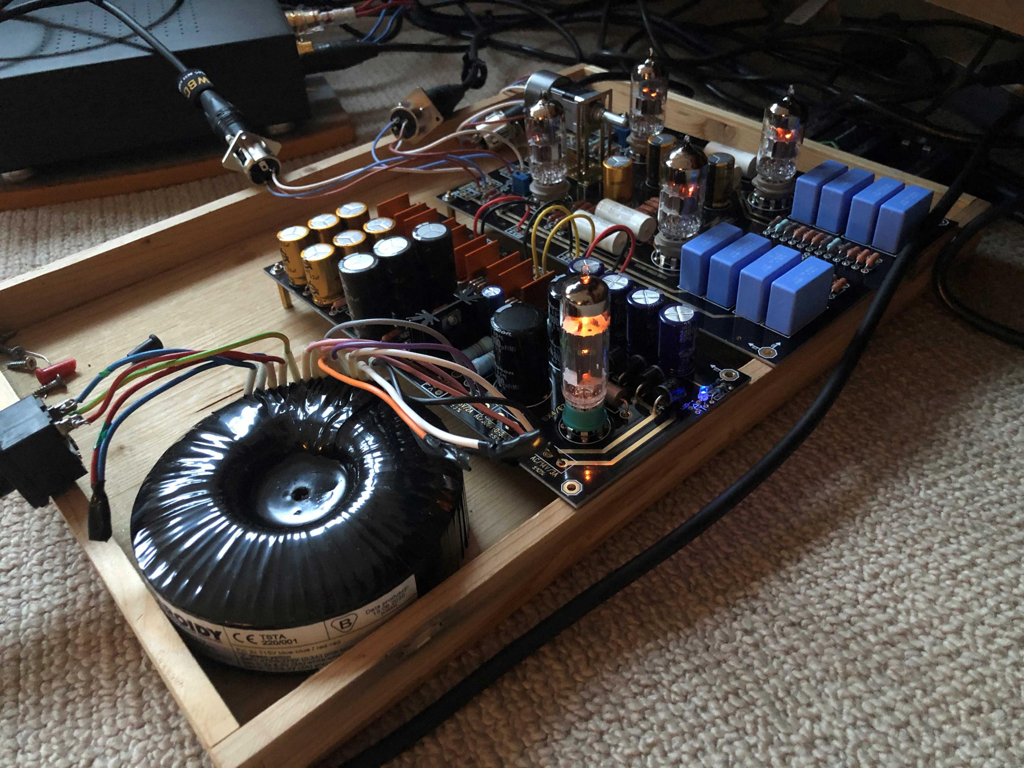

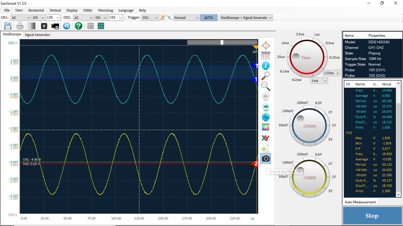

Audio board build and test.
Finished the audio board, bench tested and listened.
It tested very well with essentially flat frequency response from 15hz to 24khz. Didn’t bother going any further. Waveform very clean. Also did well with square waves with no ringing or overshoot/undershoot. Could not get it to clip or distort at any volume.
Listening test: Very quiet and clean. Fast. Maybe not as “tube” sounding as some might like. Drives my Class D monoblocks very well.
I hooked up the in and out connectors directly. Still need to build the input/output board.
Really happy with the results. Definitely a keeper.
Attached are shots from my (admittedly) crappy scope.

For the test build I picked up a Toroidy TSTA 220/001. It has 2 primaries so I can use both in the UK (current location ) or in Canada where i will eventually return( I'm Canadian). Also, I like toroidals for their low EMF. I wanted a very good, quiet preamp.
The amp wants these inputs:
AC/6.5V/2A (±3%) > Transformer Secondary 3
AC/280V-0-280V/100MA (±5%) : Transformer Secondary 1
AC/14V/3A (±10%): I put both Transformer Secondary 2's in series for about 13v.
The amp seems happy with all this. Not sure if i will keep this transformer for the final build as it is physically a bit big.Just starting to look at cases and final layouts.
All tubes and better sockets from Watford valves as I am located in London UK. Great place to do business.
6X4WA-GENERAL ELECTRIC (General Electric)
E88CC/6922-JJ TESLA (JJ Tesla) x2
ECC82/12AU7-JJ TESLA (JJ Tesla) x2
9 Pin B9A Belton Micalex Valve Socket PC Mount VT9-PT (Valves Sockets) x5
Good for testing purposes. I'm sure there will be tube rolling in my future.

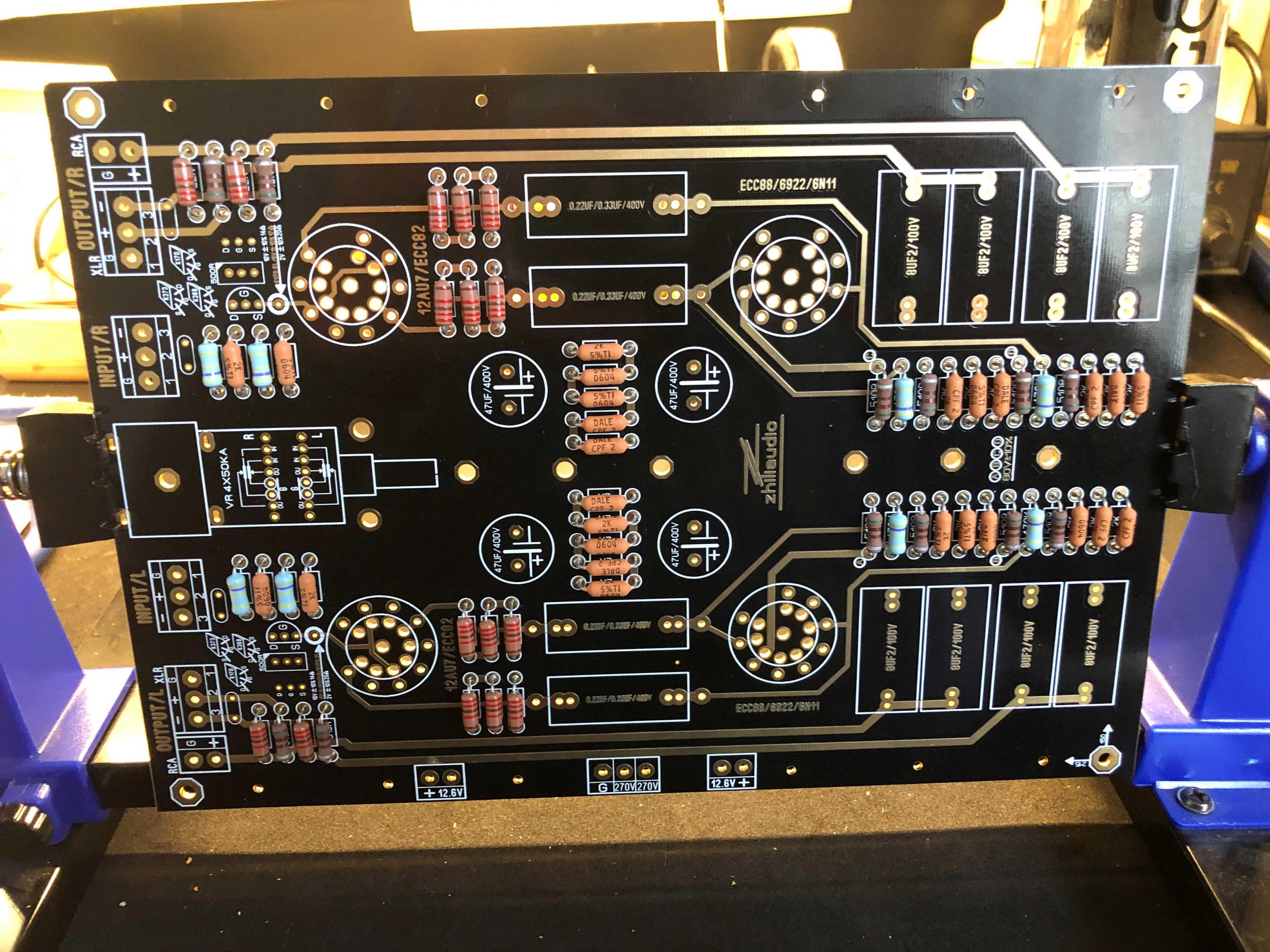

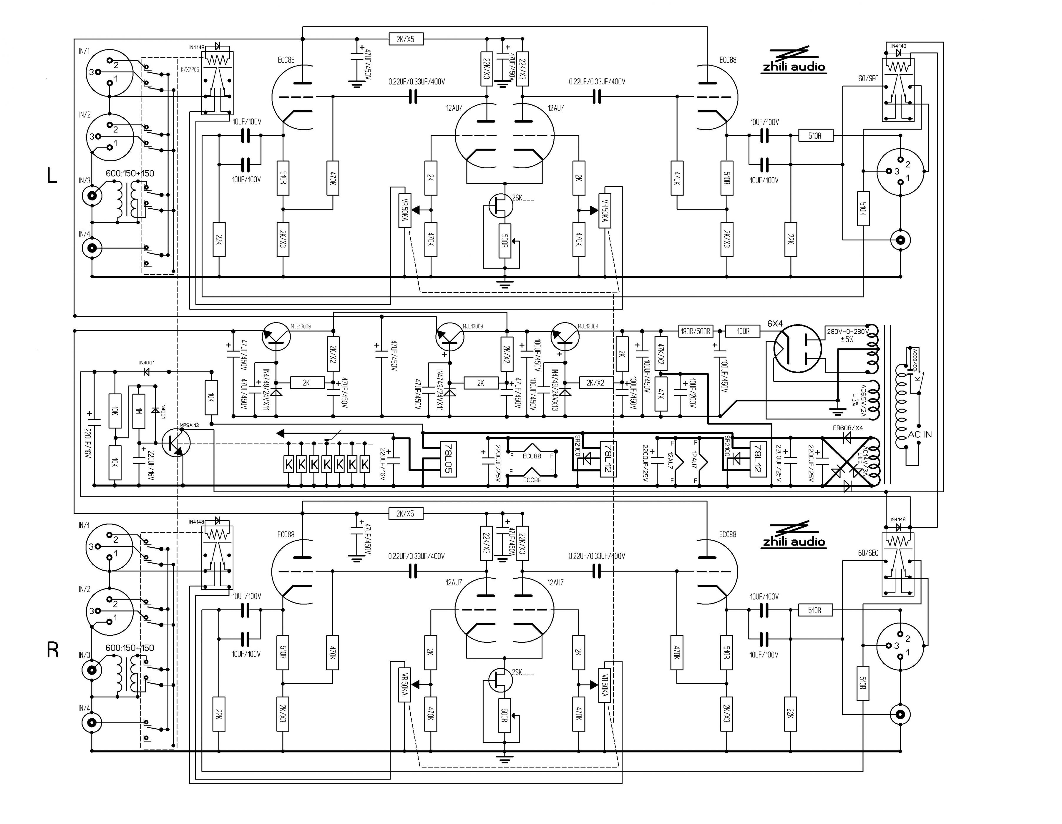

Hi guys,
I bought this "Ali-ARC" kit before few days - is it possible to find somewhere a schematics for this pre-amp?
I try to redraw it by hand from PCB, but it is not easy as PCB seems to be 4 layer board.
At discussion above was mentioned ARC model LS22, but it seems to me rather as lamp-stage of LS16 (not LS16mkII).
here" https://audio-circuit.dk/wp-content.../audioresearch/AudioResearch-LS16-pre-sch.pdf
Thx, Jiri

Hello!
See schematics in picture.
Reactions: 1 user
PCB&parts for sale
Hi all,
as mentioned earlier, I have bought PCB and parts, version with XLR and coupling trans.
Because I found meantime that circuit differs from ARC16 remarkably and there will be no easy to modify this PCB, I decided to sell this set.
Meantime I used a few (very usual) parts from this kit (24V zener diodes, few resistors, one 7812, two LEDs, etc. - but all "exotic" and special parts for this kit, like pots, power supply trasistors and all capacitors are here; please note this kit when new did not contain tubes and its noval-sokets).
Currently it cost at Ali about 200,- EUR + transport.
so I guess my price let say 50,- EUR (+ transport from CZE - I prefer shipment at EU).
If someone interrested, please send PM.
thx Jiri.
