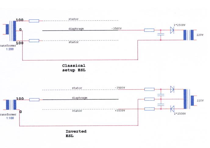

So im having a weird thing. if i follow the schematic one on one and i use 10Mohm resistors for all resistors and 0.047uF capacitors, i get hardly any sound.
when i remove the resistor at the green circle (attached image) i get sound. another weird thing. if i use 4 caps in series instead of normal 2 to increase voltage rating. i get more output. but ofcourse it did cut the 0.047 into 2. so lower works apparently better for me... but why and why does it not work with the resistor on the audio signal not going to the panel ?
also in this image it looks like they used a transformer for the high voltage with a 0 lead ? in my design the 2 cascades are fed by an inverter for cold cathode tubes. i have this wire (orange circle) connected to the beginning of the first stage of the multiplier, where it is still AC

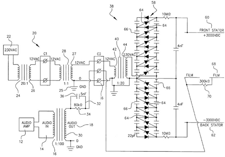

That inverted circuit you posted is from the Final Whitepaper and is incorrect, incomplete, or may intentionally miss-leading as shown. The green resistor you circled should not be there or should at most be 100K or so. The other two resistors should be 10Mohm, but should be on the other side of the 0.047uF capacitors. Attached is image from their patent which should hopefully make more sense.

Thank you Bolserst ! so i did exactly what actually suppose to be the schematic 🙂
i indeed put the resistors before the cap directly on the HV cascade output then to the caps. and from caps to stator.
i can imagine a few K on that green might reduce potential huge current to occur when flashing over? i noticed it works a bit like a low pass when using bigger values just like it would on the membrane.

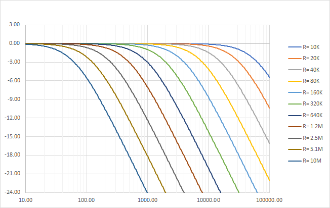

It will definitely help keep the current draw down which could save your amplifier if it doesn't have good over-current protection. Yes, the resistor produces a first order LP filter in combination with the panel capacitance. This can be used to help equalize the naturally rising HF response of ESLs.i can imagine a few K on that green might reduce potential huge current to occur when flashing over? i noticed it works a bit like a low pass when using bigger values just like it would on the membrane.
The 3dB down point is: f = 1/(2*Pi*R*C).
An example plot for 250pF panel with range of R values is attached.
ah nice bolserst, as in my final design i would not use any resistor i gues , since i wnat to devide it on the foil, and the less i use the smaller semgents i can use i guess. so a tiny one for 15khz and up etc etc etc
