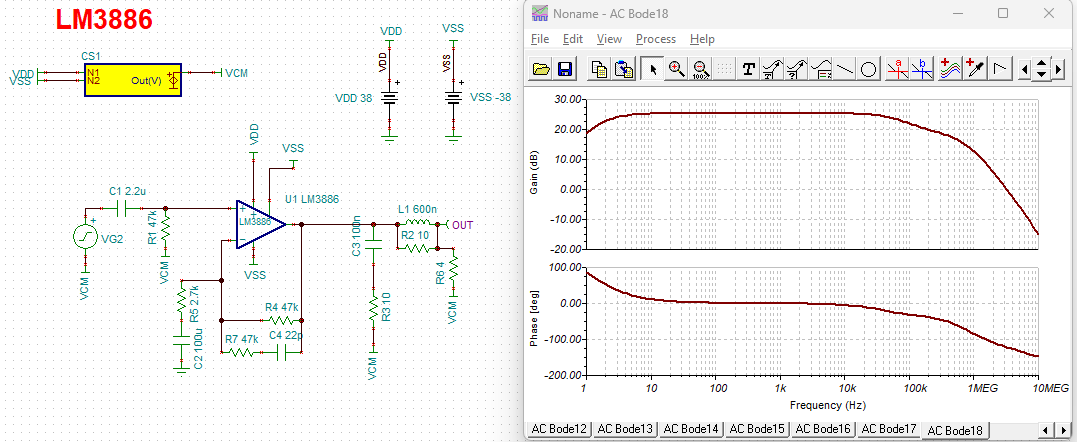

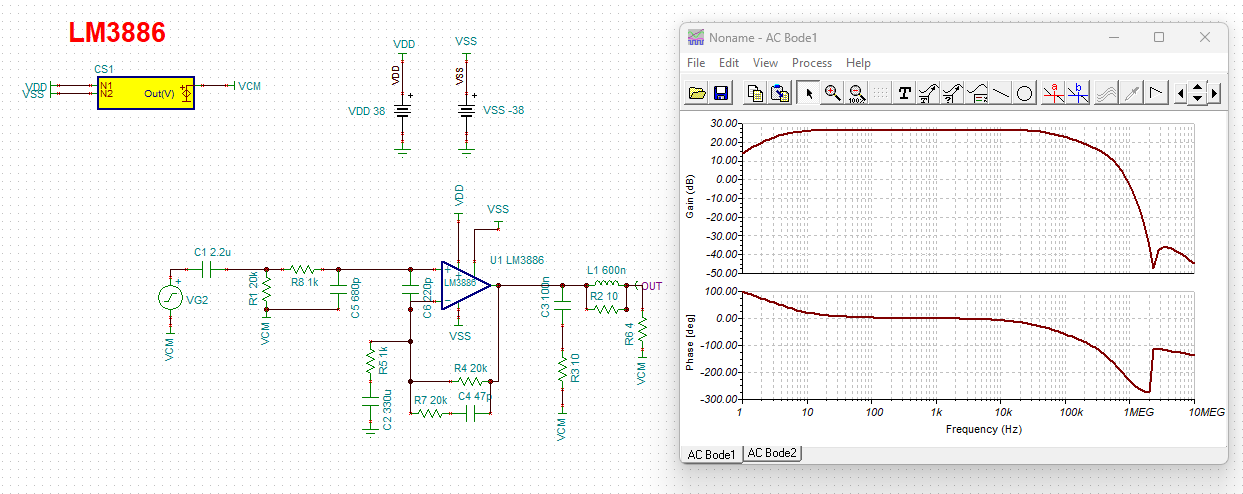

I'm playing with TINA-TI and here result for all suggestion for problem #1
1. Original circuit (Cc = 220pf)
2, Cc = 470pf series with 330R
3. Cc = removed, but I add 220p from pin 9 to ground (try to limited high frequency to enter the chip).
What do u think?

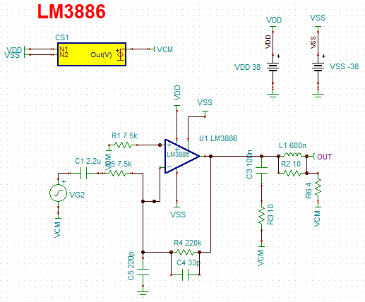

Circuit of the last case

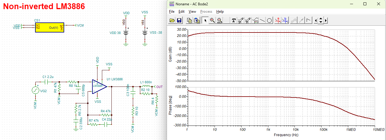

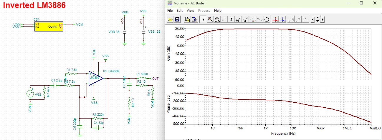

What do you think about these two schematics? I found info about adding LPF at the input of 3886 (at CircuitBasic) to limit HF response and experimenting with them.
1. Inverted design, I moved Cc 220pF to inverted and ground instead of between inverted and non-inverted inputs. This forms an RC filter with cutoff frequency at 96k (220pF and R7.5k). The phase response seem better (close to 180 in 20-20kHz range). This is an easy mod for me (this doesn't solve low input impedance problem though).
2. Non-inverted design with LPF (at 234kHz, value from CircuitBasic). This design doesn't suffer from phase shift issue.

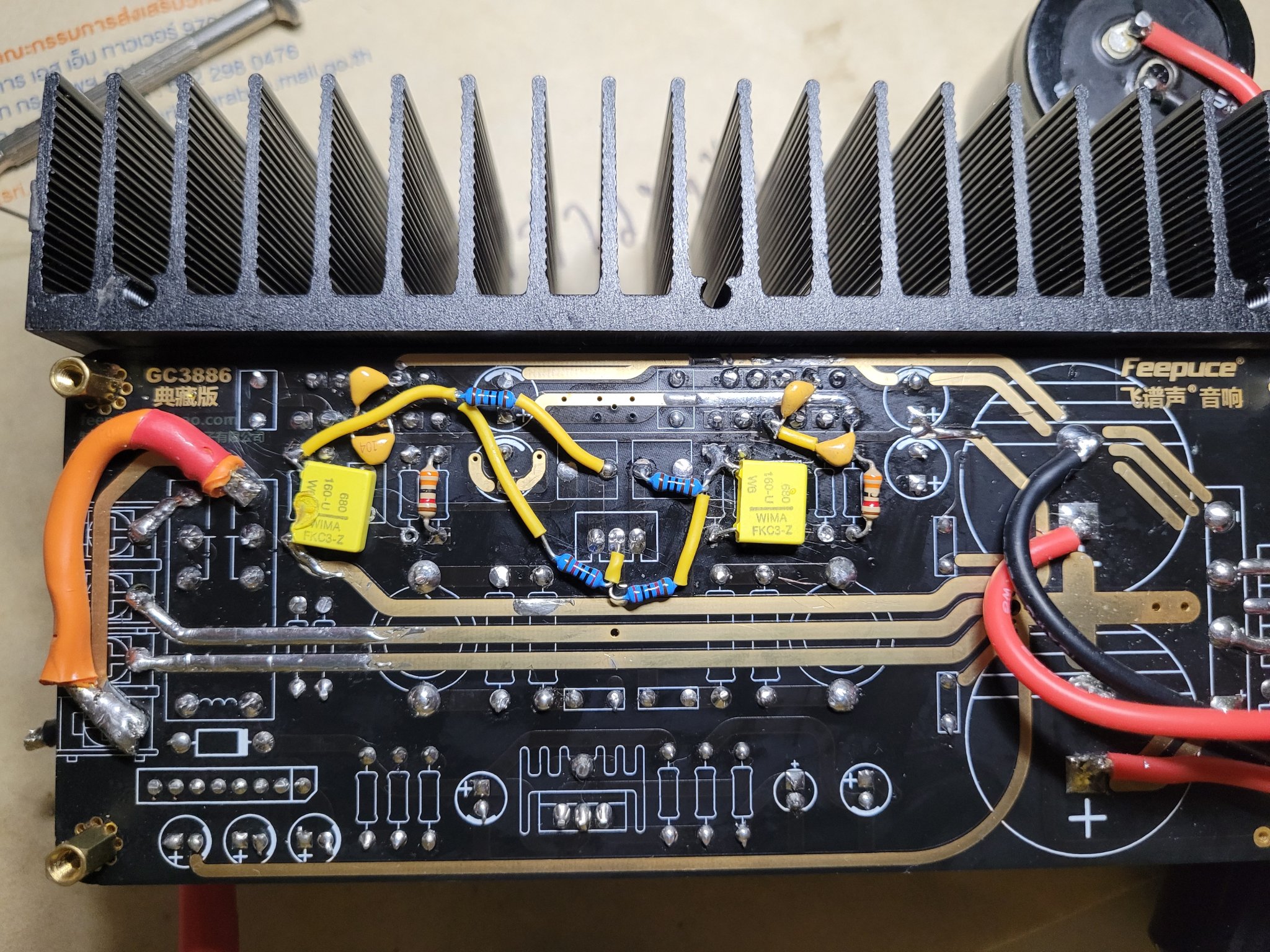

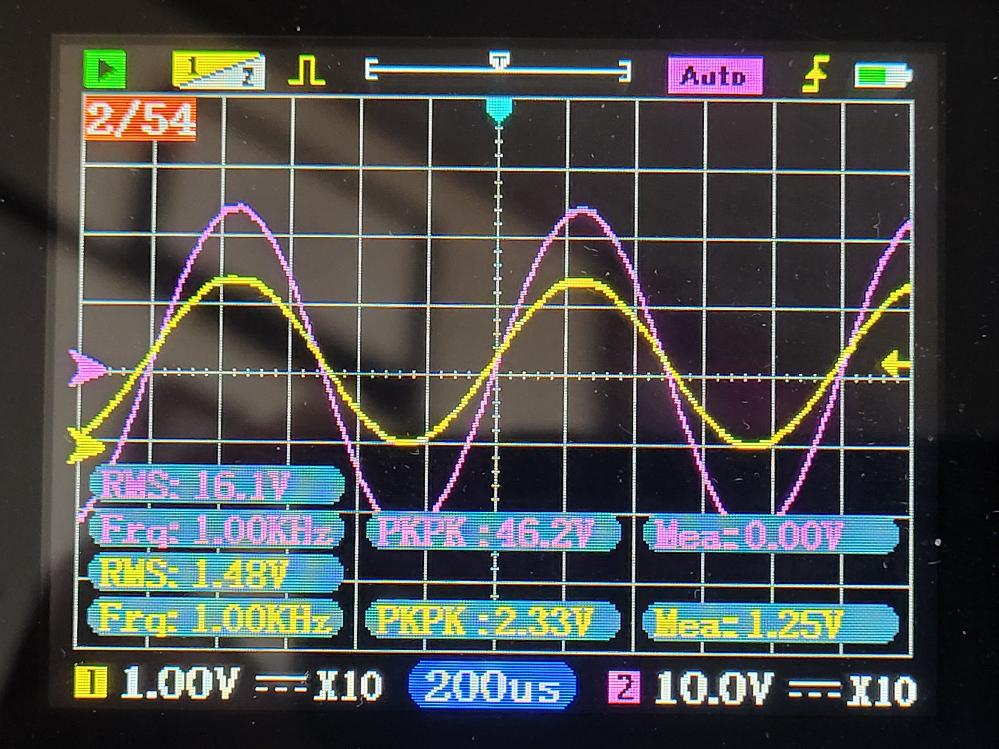

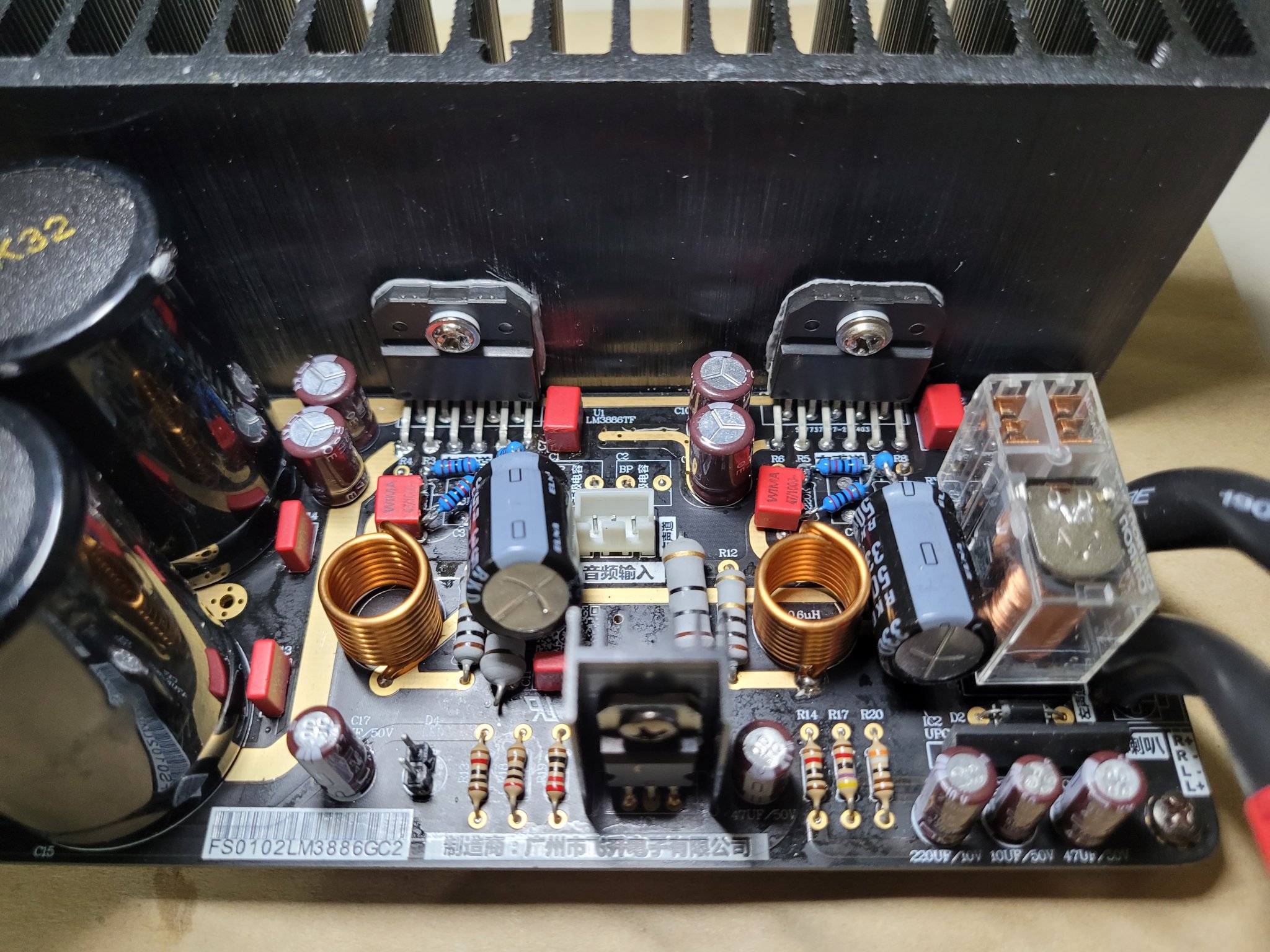

Just wanna post an update on how I resolve this.
I decided to un-inverted my circuit and retest. I got very similar performance as the inverted circuit. So, I decided to swap the chips and it solves the problem.
4 ohms load, got around 64.8W before clipping (it got some slight ringing oscillation).
I have tested at 15, 20,100, 1k, 10k, 15k, 20k, 25k and power are not varied much.
8 ohms load, same test, got around 42W, and I hit the limit of my sig gen voltage. I think the actual power can be higher.

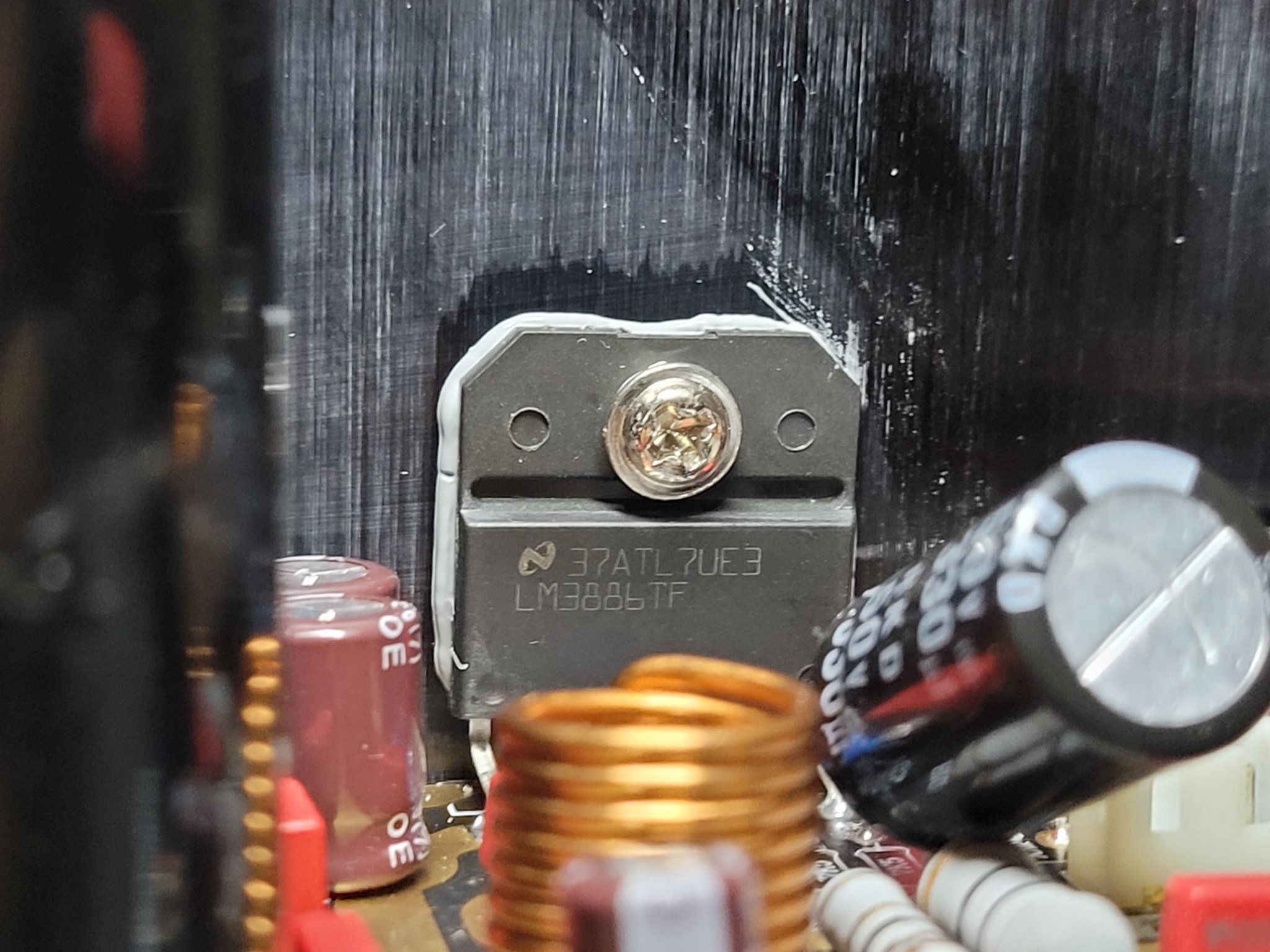

Here's pics of replacement chips and modified circuit.

So you changed the chips and problems are solved? Would be nice to post a picture of the chips that didn't work.
Thank you!
Thank you!
Here they are.. https://www.diyaudio.com/community/...-and-genuine-chip-lm3886.422929/#post-7913357Hi!

The chips you show in this thread look like the ones I got from Mouser last year. The other one, here: https://www.diyaudio.com/community/...-and-genuine-chip-lm3886.422929/#post-7913357
just screams "fake". Even the white paint is ridiculous.

My main voltage is suppose to be 220VAC but it's always measured 230+. However, voltage should be fine with 8 ohm load since the datasheet said it can do 50W at +-35V.
BTW, this is the final schematic I used. Just a reference for future reader. (I omitted the supply decoupling caps in schematic, they are 100uF electrolytic and 100nF/0.1uF MLCC as shown in post #32).

I got them during COVID when it was hard to find. The thing is, I paid almost TWICE the price of the authentic chips I acquired later on. Now I've just need to get more authentic chips to average out LOL 🤣...The chips you show in this thread look like the ones I got from Mouser last year. The other one, here: https://www.diyaudio.com/community/...-and-genuine-chip-lm3886.422929/#post-7913357
