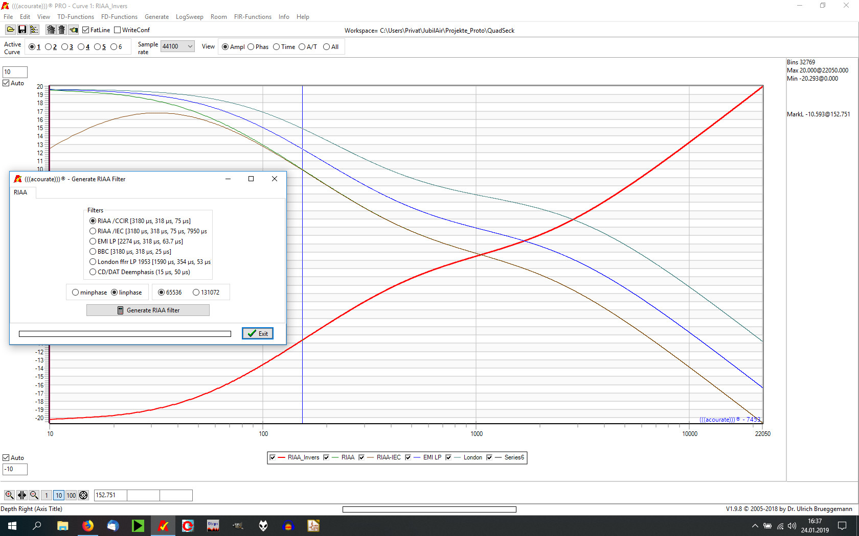

Give a try to a DSP-/Soundcard-Solution, maybe also have a look at Acourate (Introseite - AudioVero).
