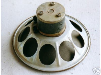

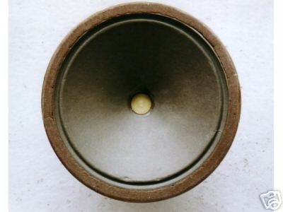

Instead I post photos of the lovely Philips 2278-00 driver. It is a 12" driver manufactured in the beginning of the 50´s for use in cinema.
It has a quite large magnet and phenol-spider. There is no available information about this unit on the net. I guess that it was probably
not made in very great numbers. One of the three units I have measures: Fs=50Hz Qms=14,55 Qts=0,27 Vas=155 Impedance=16ohm.
The driver is not a real full range driver, but extends with fine resolution to around 5Khz.
The sound with these drivers is very present and brings me close to the music.

Philips 2278-00 12" driver
Hi EC8010,
The drivers do not have dust caps. A diminutive circle that looks like old glue next to the voice coil, suggests that maybe once there was dust cap. It is however quite usual to see this kind of drivers (Siemens/Klangfilm etc.) without no dust cab. They are, as far as I know of, removed in order to improve high frequency extension. And indeed this driver plays with good resolution to around 5Khz, which is quite high for a single cone 12" (?). This Philips driver is quite rare, I haven´t seen it on the net. I checked with the danish Philips full-range expert mr. Ole Chistensen (http://www.sitecenter.dk/otc/nss-folder/philipsfullrange/), he didn´t see this driver before. They remind more of the mentioned German drivers, that came in 8", 10" and 14" sizes, than of the well known other Philips / Norelco drivers 9762M / AD5200 driver with whizzers, and the alnico magnet on the 2278-00 is also slightly larger and has phenolic spider.
I will be soon be making large sealed cabinets, and then eventually experiment with an aperiodic port.
Sometime I would like to try a real full range driver. Saw the Exact 6" driver on the full range speaker forum. They look pretty exciting...
Regards, Thomas
