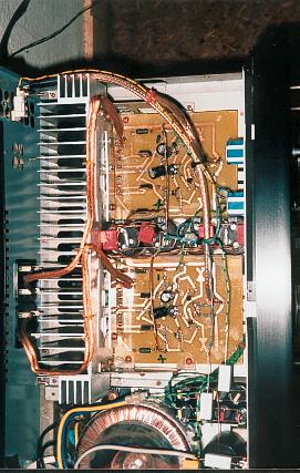

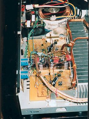

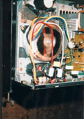

As for that hum it still surprises me as well I've spend hundreds of hours with my scope hunting for possible ground loops, build a psu of some 190.000 uf which was very good, used shielding, starwiring to the max, in short I tried everything.
As for the possible comparison That will have to wait since two months of bad luck cost me my preamp, speakers and cdp. The only things surviving are the monster and turntable. and i'm very busy at the moment as well. I can try to post some pics of this first monster though.
