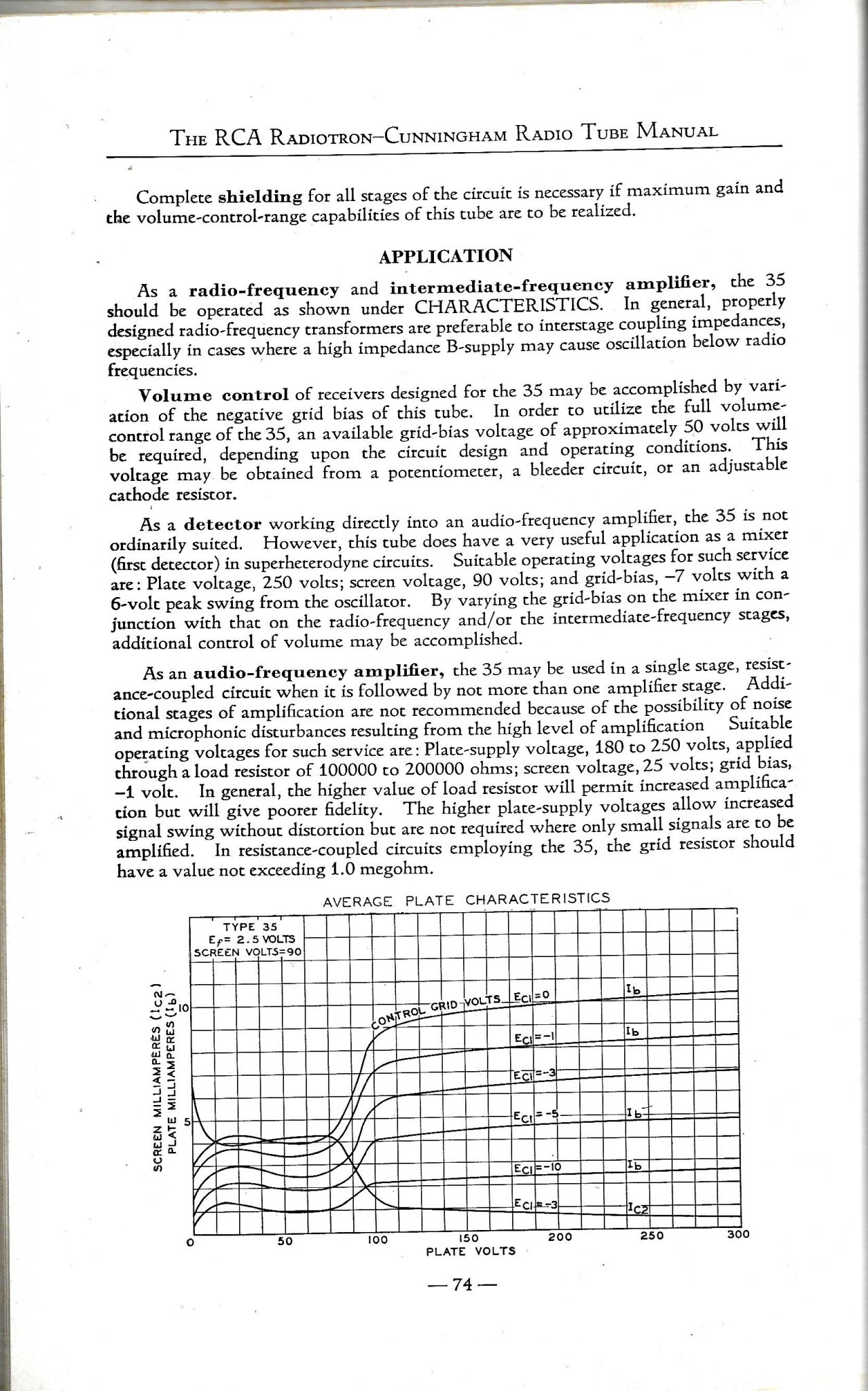

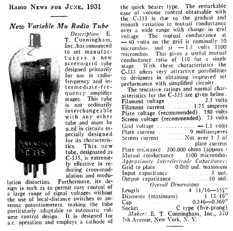

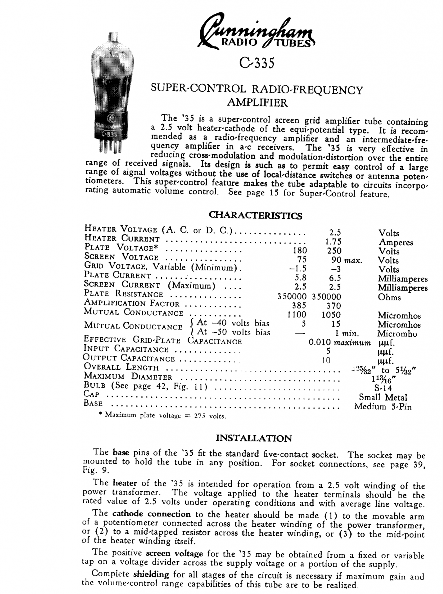

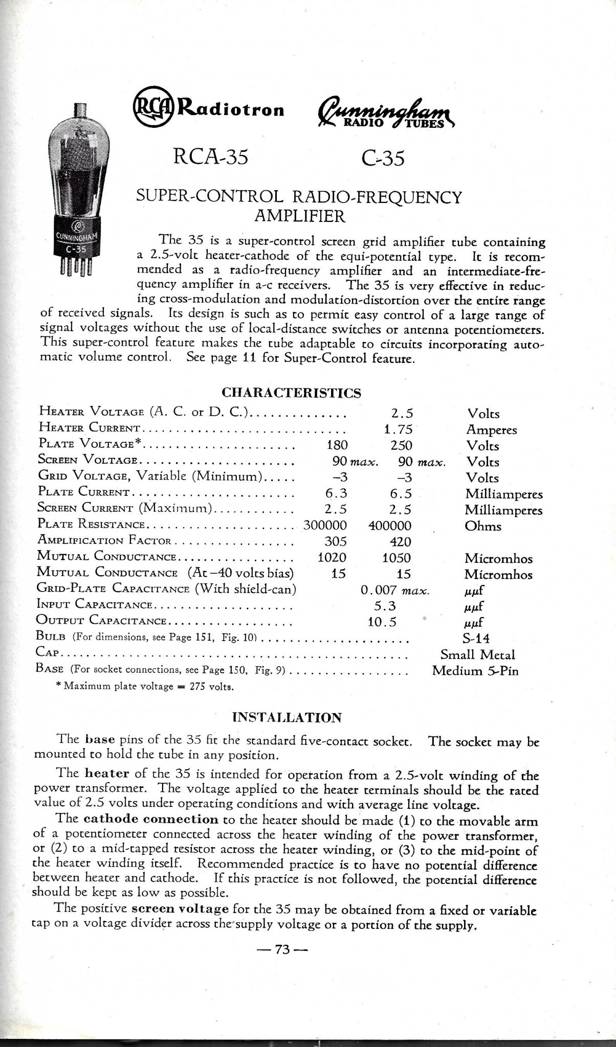

Type 35 is the first example of a remote cutoff pentode.
Details see Tyne "Saga of the vacuum tube" page 160ff.

The "variable Mu" tube has a still-ongoing place in the history of audio, as gain-control in limiters; which greatly improved both disks and film.
There is no big mystery. RCA was a patent-license office with Davey the telegraph-boy dreaming big. Elmer was a production wizard. Also skilled at keeping production workers compliant and docile. At getting police and newspapers on RCA's side when the workers walked-out and needed beatings. His influence could still be felt at Camden, and in the memories of old workers, in the early 1960s (though he had not been in town in years). See also Ford and Sorensen.

- introduction of Variable Mu tube
