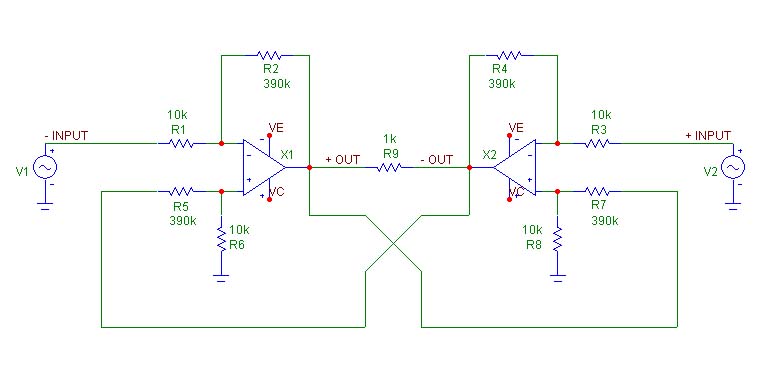

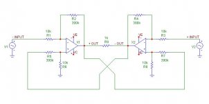

Bricolo,
I have given your last scematic some more thoughts, and I tend to believe that you have got some X, not because you have drawn it, but because it seems you get the noice produced in each opamps to apear on the diffrential outputs in common mode and thus cancled, and kept the signal in differetial mode, in this way you have separated noice and distortion from the signal. But how well the noice and distortion is canclled, I don´t know.
I have to think it over a little more and the intresting thing is that you achieve the X in a little different way.
But I am also afraid that you will get the hall of mirrors effect, wich in turn can destroy the sound. But give it a try.
Nice try🙂
Nice try🙂

My previous answer was a joke! 😉
what is the hall of mirors effect?
From the patent:
The amplifying process is recursive and iterative in nature, so that any error on the part of one amplifier stage in reproducing the error in the other results in additional error correction on the part of the original amplifier stage. In the absence of any coupling loss, the iterative process could go on indefinitely. If this were to occur, the small, but not insignificant, phase shift involved in the transit of the signal between the coupled amplifier stages could lead to a kind of "hall of mirrors" effect where the outputs -OUT and +OUT, when viewed non-differentially, would exhibit excessive distortion and noise, even though it might still have very good differential performance. The individual out-put signals would no longer resemble the input signals, especially at high frequencies, requiring a load at the receiving end having especially good common mode rejection to obtain the differential signal.

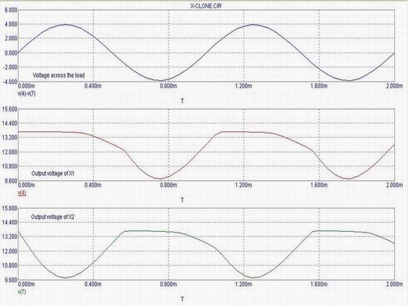

Notice how distorted are the output voltages, but the distortions
are simetrical and canceled on the load. I don't know what occurs such a heavy distortion, but when I increase R5 and R7 to 391k, the distortion is gone!
I'm going to try to explain what I understood from X:
Imagine an amp, made of two symmetrical sides, one amplifies the "hot", the other the "cold"
at the output of one side, you have x.hot+a.distortion (x is the amplification factor, hot is the input voltage), on the other side, x.cold+b.distortion
that we want to do, is reinject a.distortion in the cold side, and b.distortion in the hot side, by taking an amount of the hot output, and inject it in the cold output (crossed feedback)
so on the cold output we have: x.cold+b.distortion+a.x.distortion
and on the hot output: x.hot+a+distortion+b.x.distortion
after that, we fix the feedback resistor's values to obtain b=-a.x and a=-b.x, so each sides's distortion (remember that each side hasn't exactly the same distortion, if they would have, X would be unusefull) is added to the other side's output

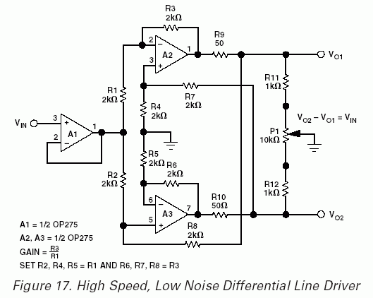

Fred was beating on my cage about this, so I spent some
time analyzing this. No, it doesn't qualify as an X, at least
as I can make out. (Anyone with a simulator is welcome
to prove me incorrect).
A2 functions as an error correction mechanism for A3, but
the function of the two is not symmetric. A2 typically
operates at a very low level, ideally only correcting the
output of A3. It does not carry signal otherwise.
A3 carries the main load, and in this regard is much like
the classic error correction circuits.
If you were to make a power amp of this, I would expect that
A2 would be a low voltage Class A and A3 would be a high
voltage AB, with both amplifiers having the same output
current rating. This description corresponds roughly to the
never-made-it-to-market Dayton Wright XEC1000 amplifier.
