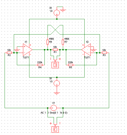

Ah! That's why lowering the "crossed resitors"'s values increased the gain
As a correction, I don't see anything else that connecting the "crosses resistors" to the non inverting inputs (that won't be connected to ground anymore, but certainly to a grounded resistor)
Another idea, Mr Pass?
Hmm.. I don´t get it, to me it seems like the errors actually will cancel as the chips is in inverted mode... no?

The general idea is, that you one way or the other, isolates errors from signal in such a way that the signal from one side is fed reversed and the errors fed nonreversed to the other side, then the errors appears in common mode and thus canclled and the signal in difrential mode thus amplified.
In your scematic I can´t see any separation between errors and signal wich is the first step to X. It works but no X.

are you talking about my first shematic, the second, or both?
Briccolo
I am talking about both.
X is hard to understand, an it is also difficult to describe in general terms, but the separation between errors and signal is the first fundamental condition as I se it.

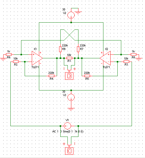

Oh,, whops! Now I see it, the frist chematic is "inverted to inverterd", no good 🙂
The 2nd seems to do the job.

Bricolo,
A few months ago I drew a schematic that is almost identical to your second (only different resistor values), and I'm pretty sure that it can qualify as a X-amp.
Tell me what the X-qualifications are, explain the X rather than suggest, X does not come by it self, still I can´t see it.
Henrik said:Tell me what the X-qualifications are, explain the X rather than suggest, X does not come by it self, still I can´t see it.
don't you see an "X" on the shematic? with the crossed resistor wires? 😉
