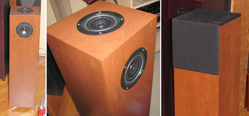

to paraphrase Bob & Jim after some extending listening to numerous variations of EL70 from mini-monitors to dual front firing, to bipole BVR & the micro-tower pipes, what we have here is a chameleon
FWIW, my personal favorite (to date) was the "castle" microtower - EnABLed, wired in series, and driven by a highly modified ST70 (mr Geek's "Dynamutt") - Gregg, please post a picture and description of the driver stage
