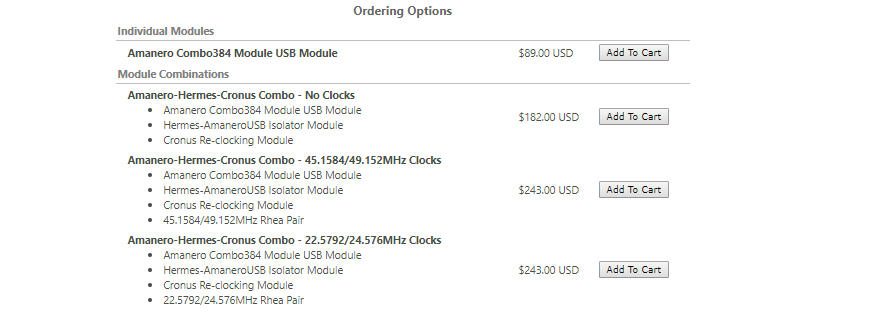

Hi im interested in buying this but im dont understand the options for clocks.
I am building a Soekris Rev 4.0 DAC and im planing to use your Amanero USb I2S + Crono + Hermes. but i dont understand the options that you have on your website for variuous clocks.
If it matters i plan on using the built in volume control in Soekris.
i want the usb interface and i want the isolator, i saw the reclocker and i thought that would be nice to have as well but i dont understand its options and i also dont know how to power it. i have one Ultra BiB for the DAC board and one Reflektor D at 3.3 Volts for the USB interface.
oh do i need another 5 volt power supply to power the reclocker? darn. what about Hermes, does that also need another power supply?
I will not pretend to know what clocks you need for the Soekris DAC, but generally, the clock choice depends on the audio frequencies you are planning on playing. Someone with more experience with that DAC can probably be more useful.
As for power, the Amanero is powered by the USB bus, not an external supply, and also provides power for the non-isolated side of the Hermes. You need a supply for the Cronus (5V ideally, as it has an onboard 3.3V regulator), which also powers the isolated side of the Hemes.
i dont get it. the Soekris dac, jusat like any other modern dac, supports and plays all the samplerates from 42khz all the way to 192khz and DSD and for that the reclockjer also needs to support all ofthe common clock speeds not just one or two. im not sure what ya'll mean.
Well the Dam1021 reclocks all incoming signals before the dac. There is no way to synchronize the master clock from the Hermes with the Dam1021. So the benefits of a reclocker before the DAC is debatable. Mostly it comes down to how good the clock signal is that you feeding to the DAC. Some have noted changes from the RaspPi which does not have a good clock.
Yeah actually the reason i started looking at it in the frist place was to find a USB to I2S solution that is isolated, the reclocking part was somethign that i saw there and i thought yo myself what the hell lets throw that in too, what i really would like to have is the isolation.
It sounds like you just want the Amanero and Hermes. Power for the isolated side of the Hermes is 3.3V and a few mA. I am guessing you could tap that from the DAC somehow.
on your website, on the page for amanero usb interface, and anywhere else really, you dont sell the hermes separate or in a combo with amanero, you sell the amanero by itself, or as a combo with the reclocker. i already attached a picture of the page.
It's listed separately on the Cronus page. I will add it to the Amanero page as well.
[EDIT] Done.
[EDIT] Done.
