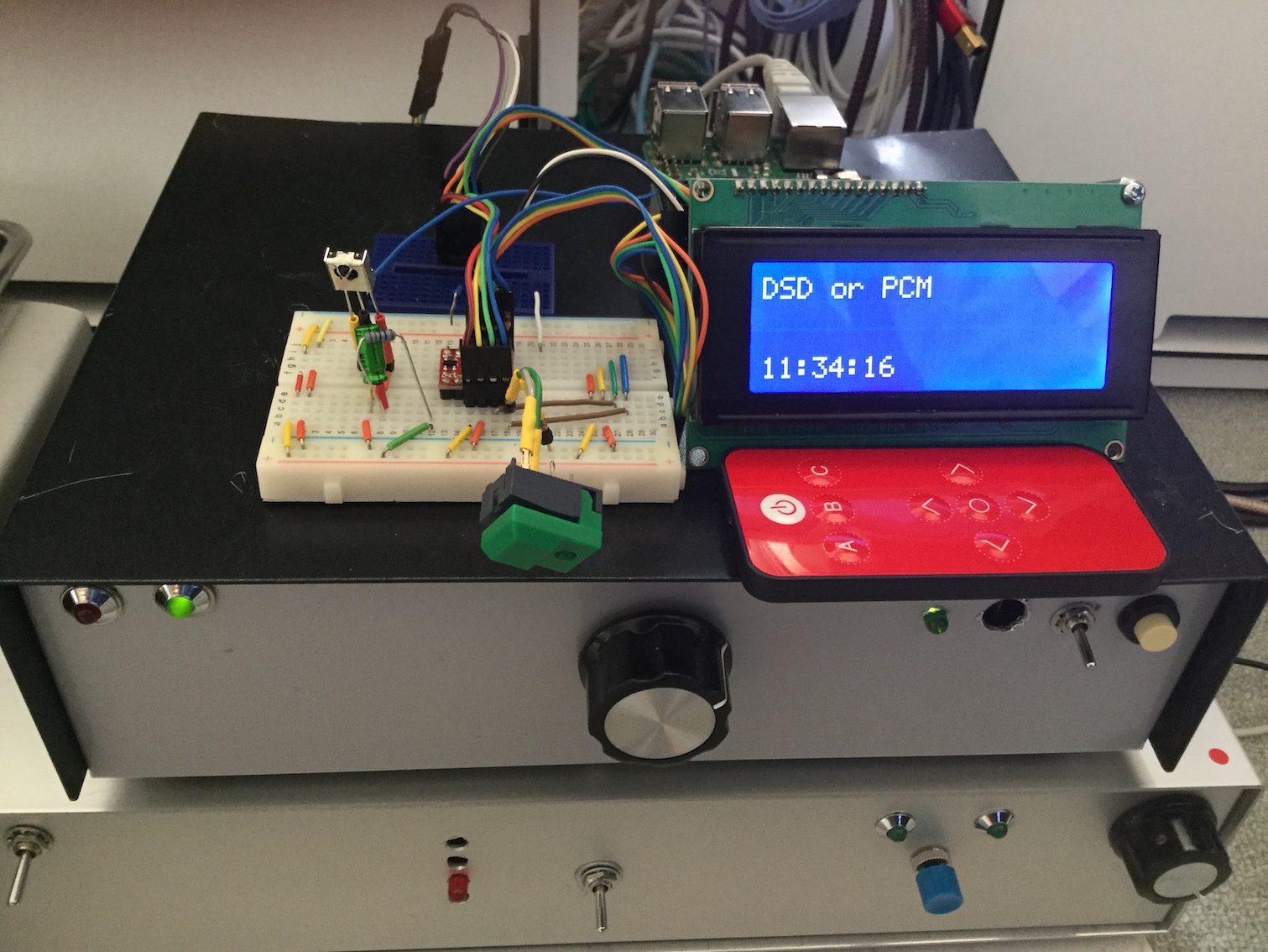

Hi there,
Since January, I've been deploying I2C control of my B3SEpro DACs via Hermes-BBB in 128fs mode (so called PureSync or TrueSync), setting the DAC registers by shell scripts or python scripts by francolargo (Thanks, Frank!); no need for on-board firmware (whether original or beta).
For more interactive control, one solution recommended by Frank was using NetIO, which appeared very attractive, but I looked for more old-fashioned methods such as using an infrared remote control which can send IR codes to execute shell scripts or commands on the I2C-connected computer with the DAC.
An LIRC (Linux IRC) package can be used for this purpose but unfortunately there is no appropriate lirc serial module like lirc_rpi on the current debian BBB system.
So, I gave a second life to my old RasPi B+ as a device to control both of I2C and IRC. After confirming the IR receiver connected to the RasPi works well, I set up an LCD to verify and display the results of executed commands.
This LCD was also connected to the RasPi via I2C by an I2C expander (PCF8574) and also converted to a member of device files as /dev/lcd0, so that the input of simple words or sentences can be directly displayed on the LCD screen, making far easy to write executing scripts.
After that, I prepared various combinations of small scripts grouped into five categories: Input selection; OSF setting, Automute setting, DPLL setting and FIR setting. These five groups were assigned to the individual buttons on the IRC so that they can be executed by irexec (a binary from LIRC) running on the RasPi. Each group has more than one command scripts but the config file of irexec can make it possible for them to be toggled each other within one particular button, quite convenient in a limited setting
The picture below is the prototype of this system. The result was quite good and now I'm enjoying semi-interactive IR control of the DAC as shown in a sample movie here. The DAC is set to 128fs for DSD sources and please notice that it can be set to SPDIF mode on the fly.
BTW, the I2C-connected DAC in this movie is a B3SE9028pro, receiving audio signal (DSD512 from HQ player) via an isolated USB to I2S/DSD PCB (XMOS 768kHz with 45/49 MCK from DIYINHK). The SQ is quite good.

Uh, thank you for your kind words.:) No objections to the lack of elegance in the current DAC case,:D which was previously used as a box of external power supply containing Placid HDs.
BTW, the lower one, previously used as a B3SE 9018 DAC with multiple SPDIF inputs, is now working as a dual-mono B3SE9028pro DAC with a Hermes BBB for I2C and I2S connections.
