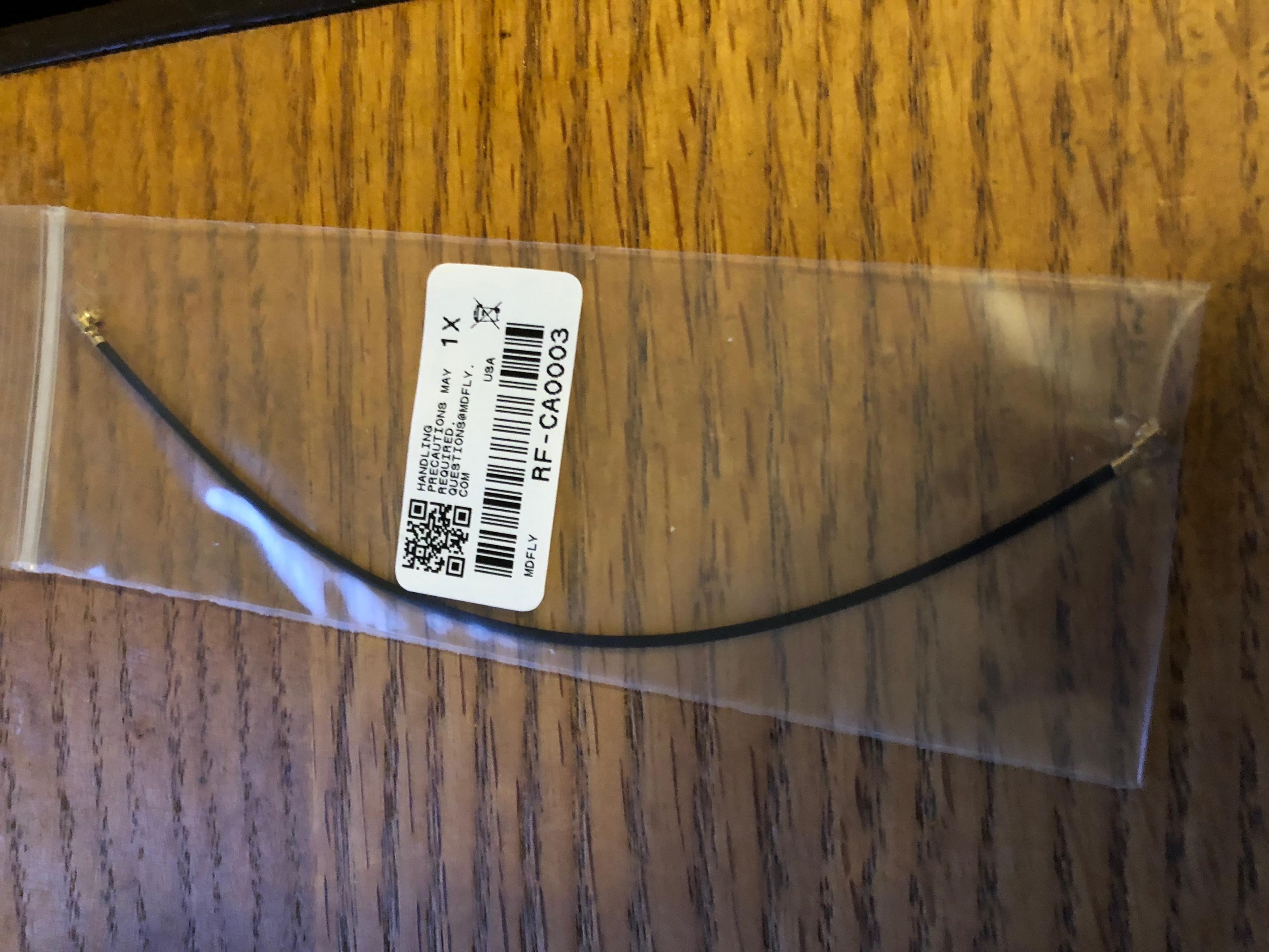

Getting ready to put the Amanero / Cronus together, but I'm having a hard time finding what looks like u.fl male to male connectors. Looks like both the Cronus and b3 have male connectors, but every cable I'm seeing male / female.
Am I missing something?
You are looking for female to female ufl cables.
Like the one attached.
