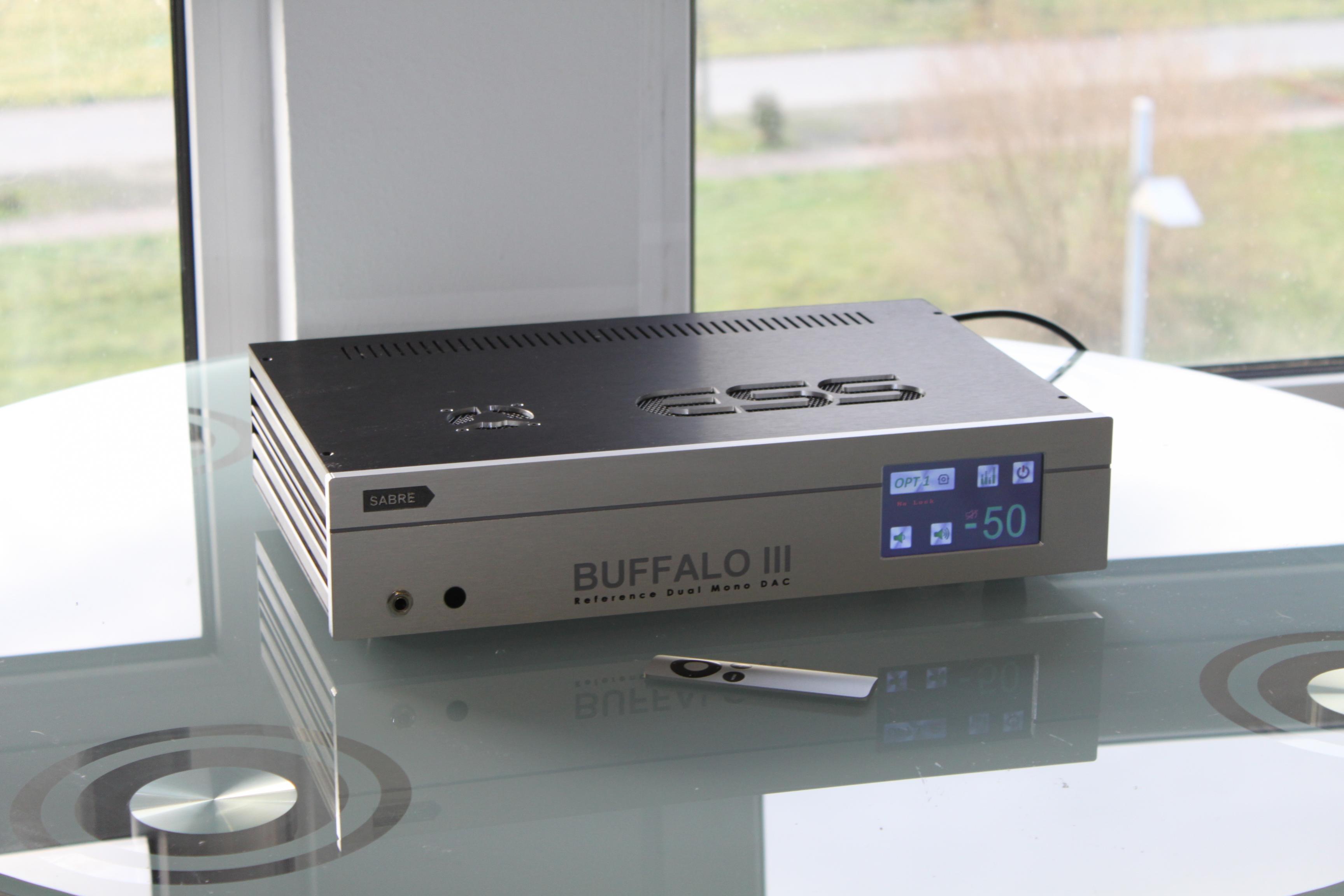

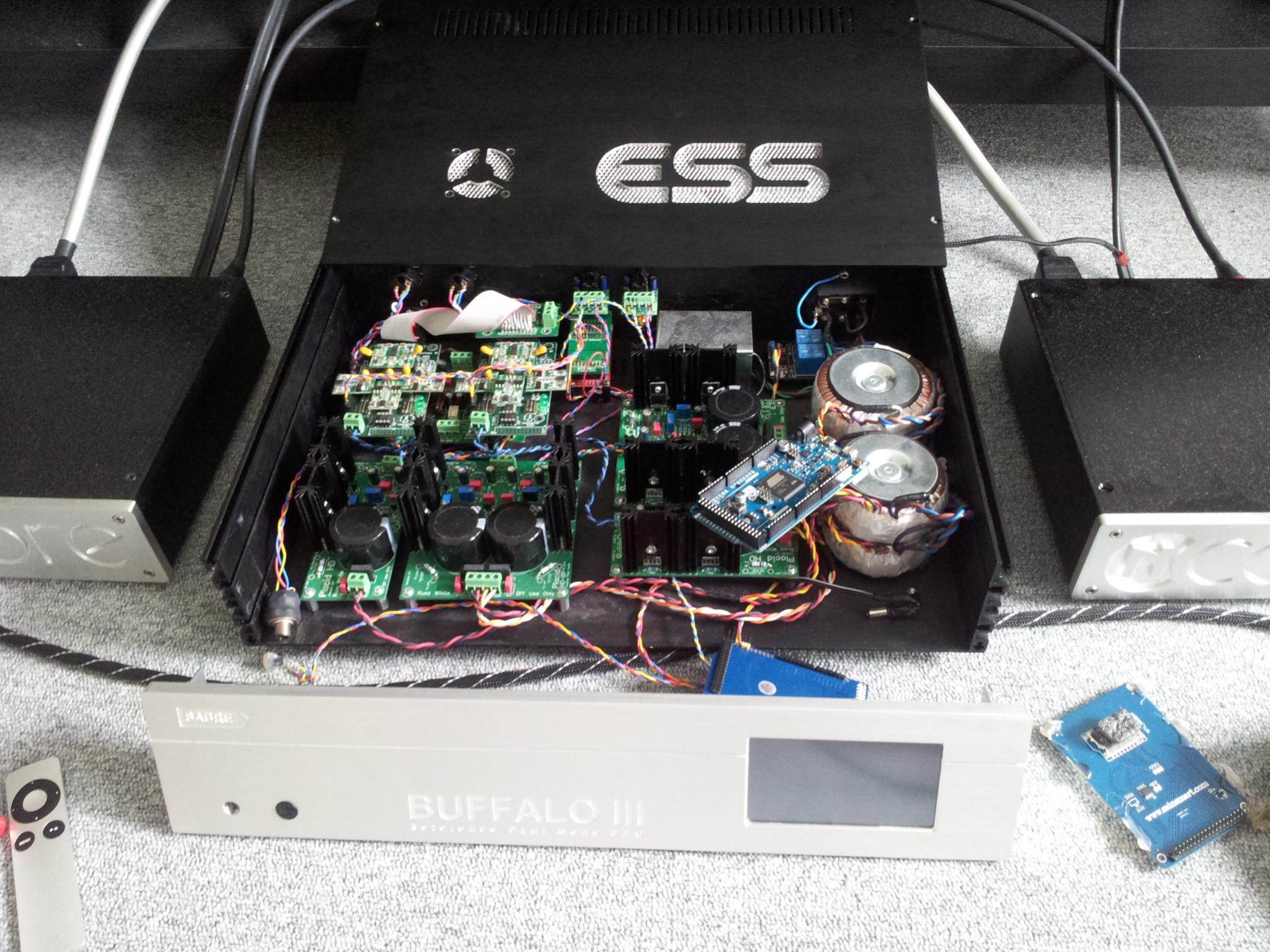

That would be great and it seems to me that most of the people experiment with PS.
Anyway, to go for dual mono on es9038pro one have to be insane😉
I personaly have build dual mono on Buffalo 3 and never really made it working (stucked on I/V stage). It is almost impossible to debug for me, so i couldnt focus on the software and controller.
One intagreted solution would make lots of place for programming, maybe one nice touch screen on raspberry for the community.
I stuck on unfinished this:
