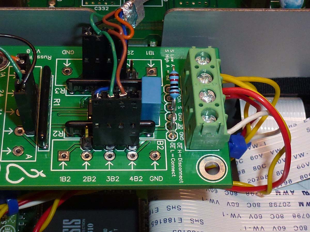

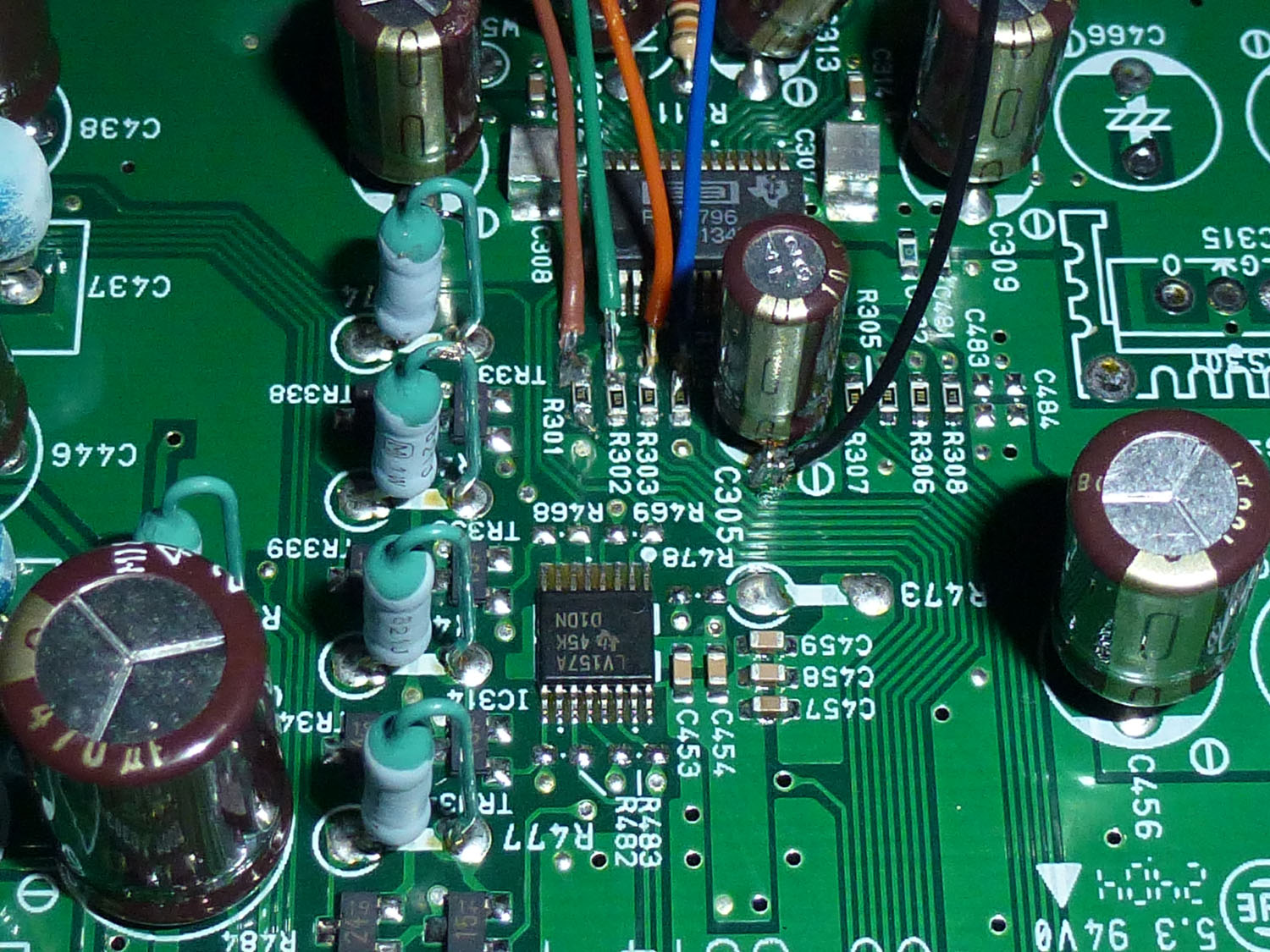

When I have got my new mechanism for my 3910, I would like to try I2S. Because this machine is very complicated, I would like to know if you have tapped I2S at the same points (attachment).
Hopefully your Denon is working properly now.
Thank you!
André

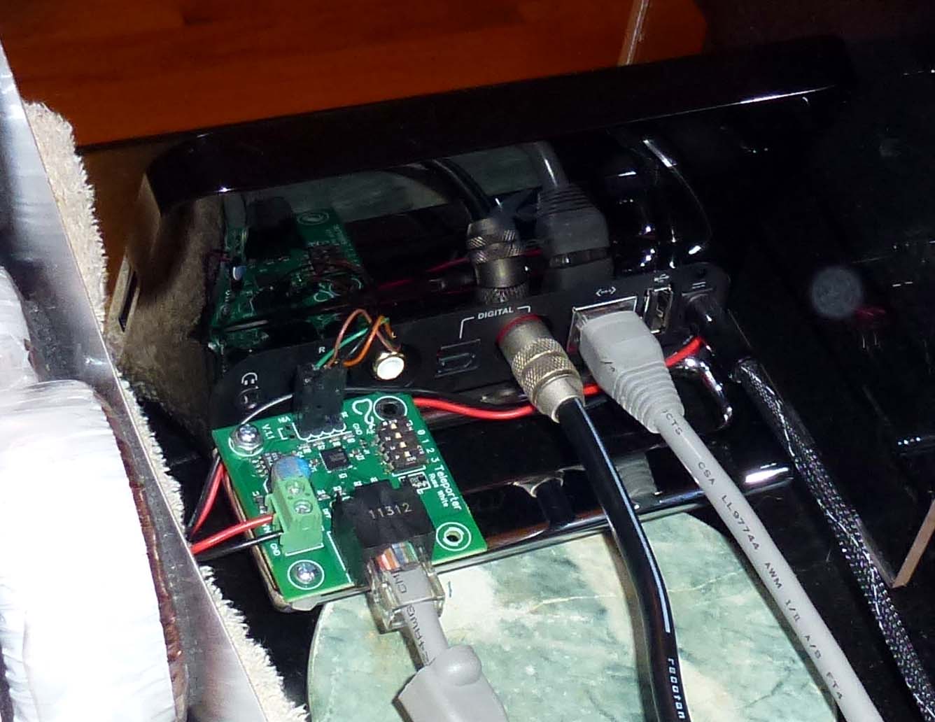

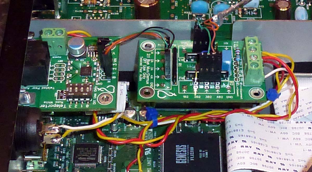

Hello Andre. I think I answered this at another forum, but if not I'll attach a pic of where. I attached at IC311 on the audio out board.
Thanks again for pointing out that DSD swapped R and L channels on the shared circuits with I2S out. Twisted Pear came to my rescue with the OTTO II, saving me from building a multiple relay board to correct that. I simply jumpered the shared wires from B1 over to B2 out and corrected the previously reversed R and L DSD channels.
Even with the lid on the Denon 3910, I still get dropouts using the Teleporters when that recliner is operated. (Upon releasing the switch). My two channel system is on a dedicated 20 amp circuit and the chair is several feet away. I don't use the Denon much so I haven't tried anything. Currently doing a dual mono build so my attention is diverted.

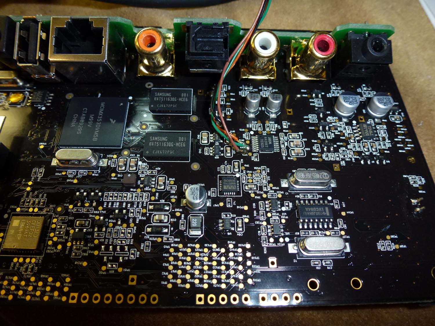

Getting I2S from SB Touch is pretty straightforward procedure however requires very good eye, steady hand and thin wires.
Greetings Thomas. I got brave and did the I2S mod on my Touch and it still functions.🙂 I was going to buy a used one in case something bad happened but pricing is crazy since they have been discontinued. One correction, Bit Clk TP 260 was actually TP 268 on my board. My board had good print under lighted high power magnification.

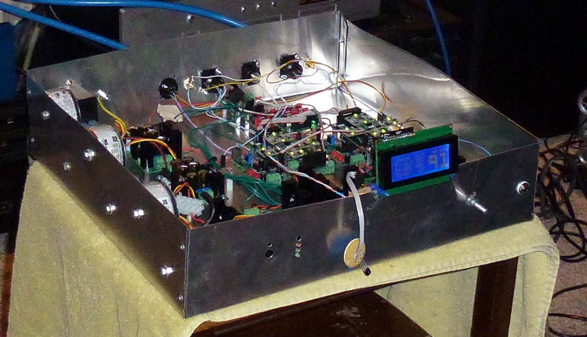

Thanks Thomas! It feeds a HiFiDuino/Corpius code controlled Twisted Pear dual mono BIII DAC that is nearing completion. I have a proper enclosure ordered from modushop, it should ship next week. Here is a poor quality pic taken at a friends house. It's in a friendly case.....it waves at you.😀
I have always liked "rat nests" . It easily shows amount of work you put in. Your Dac certainly deserves better enclosure and improoved layout 🙂
Thanks. It started out neat then the add ons began.😀 You should have seen it with the breadboard LCD hookup.
