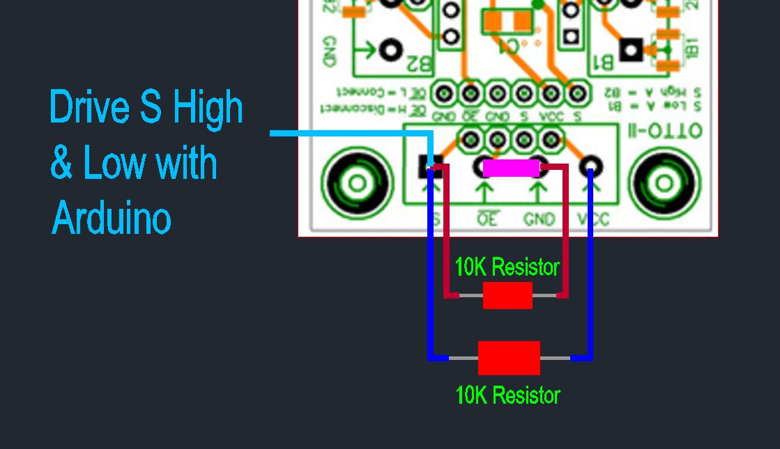

I'm doing some mods & want to loose the relay but also want to be sure I've got this right.
It is my understanding from what I have read that;
* I have a 10k resistor between S & GRND
* I have a 10k resistor between S & VCC
* I have a link between OE & Grnd
* I drive S High & Low with Arduino
Is that correct?

You will notice there are pads for installing pull-up/down Rs behind the terminal block. :)
As for control if you are using 3.3V logic you don't need the pullup unless you are using an open drain type output.

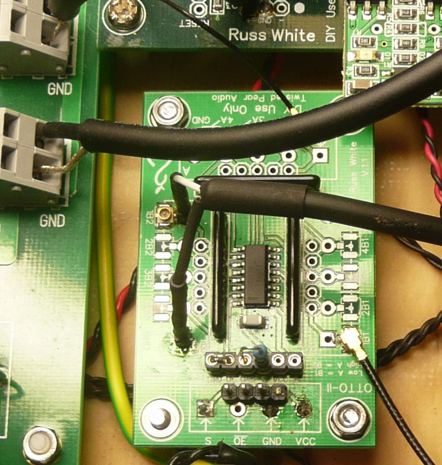

I've linked OE to Grnd, put a 10k resistor between S & Ground & an driving S High & Low with an Arduino output & it is working, although I'm going to have to change the code as I'm now getting a mirrored result to when I was using the relay.
You cant see the Arduino connection in the pic as its under the board.
