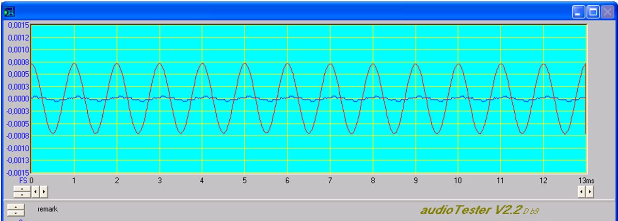

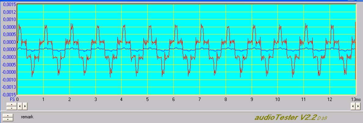

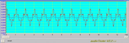

I know that -90dBFS is low, but with a 24 bit converter there should still be a fairly good resolution. Disregarding the noise for a moment, it should be possible to get e.g. a sine wave with a 9 bit resolution with a signal level of -90dBFS.
My set up is like this: the generator signal goes from the PC via USB to the MiniStremer, via I2S to a 24 bit DAC, from the DAC to 24dB gain stage before a 24 bit ADC, via I2S to the MiniStreamer and back to the oscilloscope/FFT analyzer on the PC.
I have attached two figures. In both cases the red trace is the interesting one.
The one with a distorted signal shows the signal I see when setting the Windows volume control to maximum and the generator to -90dBFS. As it can be seen there are only 4 quantization steps (+ some noise which could be from the DAC and ADC.
The one with the clean signal is with an analog signal (from a R&S UPL Audio Analyzer) into the 24 dB gain stage and the ADC. This is to verify that the distortion is not caused by the ADC. As can be seen the signal looks OK in this case.
The scale on the left is the same in both figures.
If I set the generator at -30dBFS and the Windows volume control at -60dB, this should also give a level of -90dBFS. It does and in this case the signal looks OK.

Could it be that it's a limitation with the generator? I.e. the generator is only generating a 16bit signal.

Yes, in principle it could be. I asked the developer of the analyzer SW and he claims that everything inside the program is done in floating point, so it should be OK. Does something happen at the interface between the analyzer and Windows XP? Perhaps.
In the near future I will test the analyzer SW although it will now be on a Win7 PC that I have just changed to as my work PC. I have installed an internal Terratec sound card which supports 24bit analog as well as SPDIF I/O. I have installed the sound card primarily because the internal sound card can work as a slave on the SPDIF input.
But of course things could be different on Win7 in general.

No, I have not tried the driver you are suggesting.
In the meantime I have changed to an internal sound card with SPDIF and it now works fine.
Initially I used an old Terratec EWX2496. It worked fine under Win XP, but was not running reliably when I changed the PC and changed to Win 7. I had to use some Vista beta drivers, which were not reliable and could sometimes cause a BSOD.
I now have an M-Audio Delta 1010LT which works fine under Win 7 using SPDIF I/O.
