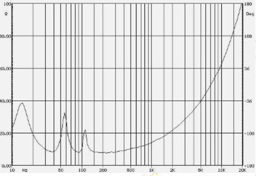

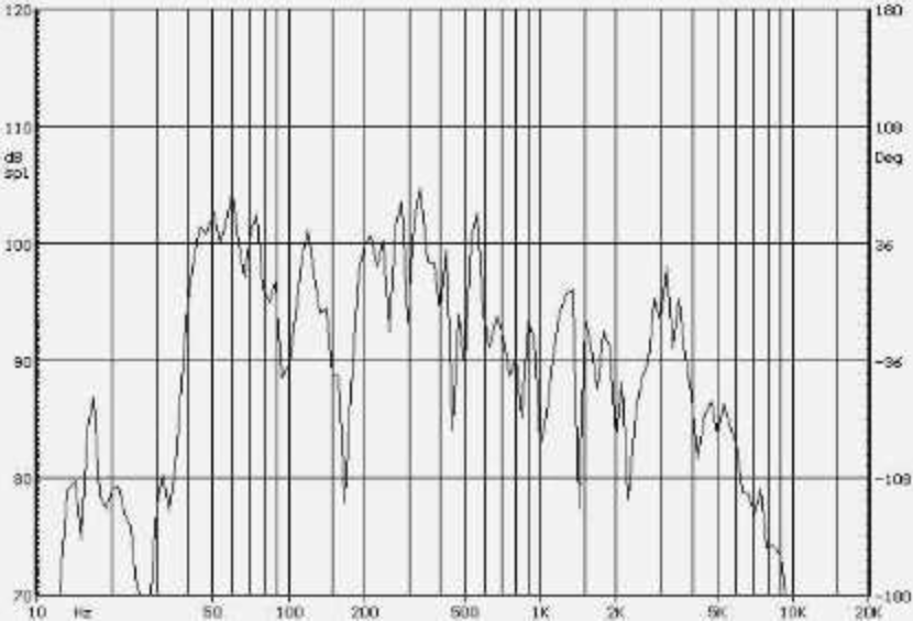

Below I have attached a current driven bass reflex (my old system). As it can been seen, the tiny peak around 80 Hz corresponding to the woofer resonance is nothing in comparison to what room modes do....

The impedance at the peak seems to be 7 times that in the surroundings, so the peak in response will be 17 dB on pure current drive and somewhat less on partial current drive though it may not show up as such in smoothed measurements.45 said:Below I have attached a current driven bass reflex (my old system). As it can been seen, the tiny peak around 80 Hz corresponding to the woofer resonance is nothing in comparison to what room modes do....
What do you mean? That would be true if there were no motor with current control.whereas in a ported system fs is solely on the mercy of the suspension.
I am afraid that might be true for an emulation of current amplifier.
The suspension of that woofer is treated foam and the woofer has a compliance around 1.8-1.9 mm/N and with very linear behaviour. Despite the large peak at the resonance the frequency response peak is tiny because it has a powerful motor and the current provided by the amp is amazingly clean. It basically works like a perfect very FAST damped oscillator with no inversions along the impulse response that are the first and most important indicator of distortions and actually make the impulse last longer. It does have overshoot as expected but is not big and response is faster than typical voltage drive. I don't think a 1/3 octave response can smooth a 17 db peak down to 2-3 dB's. That resonance FWHM (full width half maximum) spans approx. from 70 to 90 Hz (so it's about 20Hz wide).If it were really 17 dB I would expect some 8-9 dB smoothed peak.

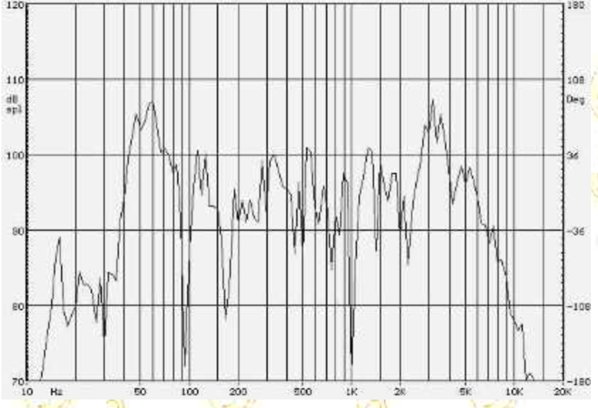

Another example with 8" full-range with whizzer cone. No smoothing here. Very visible the equalising effect of the coil inductance at high frequency. Of course nothing can be done on the midrange peaks and deeps coming from the interaction of the whizzer cone with the main cone....

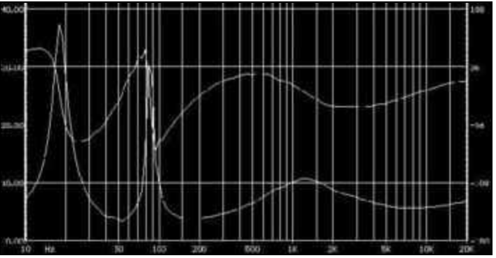

Here the resonance peak (the one in the middle) is approx. 4x (i.e. 32 ohm vs 8ohm) but there is no 12dB peak. From left to right: impedance, voltage drive, current drive.

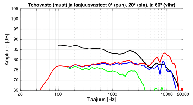

The anechoic response of the speaker with estimated power response has now been taken (red: 0deg, blue: 20deg, green: 60deg, black: power). Quite neat and almost as intended, except perhaps for the elevation at 2+ kHz, the reason for which is not very clear. Anyway, this region can easily be adjusted lower simply by increasing R3 a little. The low-end -6dB cutoff frequency is here slightly higher than the 64 Hz I had estimated. The difference may arise because due to the adapter the driving level remains here lower than usual, and bass corner frequencies always depend a little on the signal level. The on-axis response extends beyond 15 kHz (-6dB) (note: without whizzer cones or specialty drivers), but the best listening direction is somewhat off-axis.
