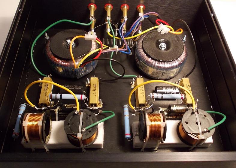

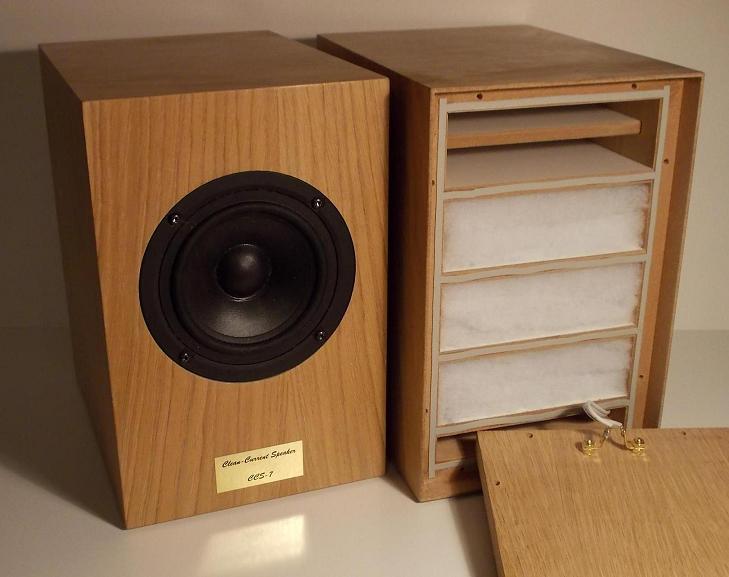

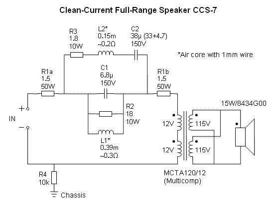

Below are found the circuit and pictures of the adapter unit, containing the electrical components, and of the speaker itself, the other with the back lid opened.

The sensitivity loss caused by the series resistors used for the V/I conversion is largely compensated by a step-up transformer.
If/when the speaker has an impedance of 8 ohms, the impedance presented at the 12+12V side of the transformers is 0.348 ohms. The network feeding that low an impedance will have a *very* low efficiency. Unprecedented, but for the wrong reason I think.

So how does it sound?
I was under the impression that the 15w/8434 was about done by 5KHz. 9KHz if you run it wide open & ignore the HF resonance, which, since it isn't designed for such purposes, isn't optimised for operating use. Nice small inexpensive midbass, albeit one that doesn't get very low, with a reasonable operating BW for those purposes, but it's not got sufficient at the top end (especially off-axis) to be ideal as a wideband unit in my book. Still, if you're happy, that's what counts & it's good to see something different.
This is a principle where by trading a few decibels of sensitivity one can achieve a crucial reduction in the most detrimental midrange distortions and almost get rid of the vague EMF:s (motional and inductive) in the signal path. If this is a wrong reason, then of course our interests do not meet.
(The presented image of 8 ohms is actually 0.42 ohms, as calculated from the real turns ratio instead of nominal voltages.)

interesting - so the in-band input impedance of the circuit never drops below ~6 ohms. Is a transformer with 1:2.8 turns ratio good for other drivers? If no correction trap is used, is it better to have additional resistance on the primary rather than in series with the load?
also - is using a higher powered solid state amp, what advantages does this approach present vs a simple series resistor?
It does drop to ~4 ohms at low frequencies.
With that, an 8-ohm load appears as 1.0 ohms and 4 ohms as 0.5 ohms. Quite in the useful range, but the answer is dependent on the current-drive factor desired.
Functionally there is no difference, but I don't recommend the latter because the DC current from the amplifier's offset voltage may use up a big portion of the transformer's flux capacity; and even without the DC, the transformer would operate closer to the saturation region.
No other advantages known than the sensitivity restored. (Both also protect the speaker against DC faults.)
However, if filtering is also used without the transformer, inductance values may become impractically high.
