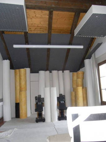

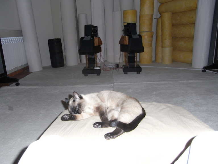

I have configured my ambios and they are already working.
I finally have ambiophonic sound without a physical barrier or a noisy and annoying computer!!!🙂 Good job, Ambio4you!
By the way, the equalizer is a very important feature to good ambio sound.
One suggestion: is it possible for you to include features such as the so called center or space parameters available in electro music website´s AmbiophonicDSP´s software implementation? Could that be done as a software update and used with the current boards or would it be necessary to modify the chips themselves? Those are features that Robin Miller and Howard Moscovitz developed and I have found to really improve the ambiophonic experience, sort of the icing on the cake so to speak.
Thanks for catering to the growing number of ambiophonic fans out there who don´t have $2,000 to spare or like computer fans buzzing along with our music.

Glad to hear that you're happy with your Ambio Setup! 🙂
A big listening room, that's neat..we would never get this kind of space in HK.. :-( . Do you mind telling us what type of speakers you're using and how this miniAMBIO setup differs from your previous install? Picture is a bit small..
As for your question, we don't know much about what Electromusic is doing (don't think it's open source...) so can't answer that one. We could investigate a bit more later to see if it's maybe possible to partner with the electro-sonic guys for this one... We'll try to have a look at it one of these days.
Have fun!
The speakers are diy. An ongoing project under constant revision. They used to be placed side by side when I was using a physical barrier and were moved to a 20º as seen from the listening chair for electronic crosstalk cancellation. This seems the best position for Ambio4you as it was with the other software I´ve tried.
I find that a given system´s frequency curve does need to be slightly tweaked once it undergoes cancellation and I have been doing that by modifying my active crossovers. Your equalizer comes in really handy particularly for users with non active speakers.
