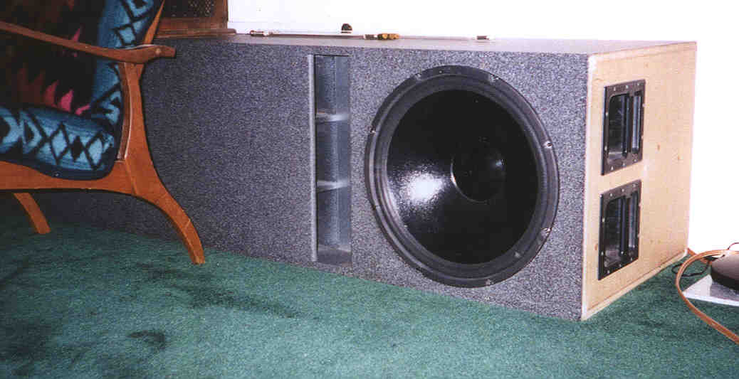

There were several attempts/experiments with tube-style subwoofers, but at the time my friends and me were craving something that could play the lowest pipe organ pedals without flapping. There wasn't much TL info back then, so using the Dalines as inspiration, along with the SWAG algorithm (Scientific Wild-*** Guess) we came up with some ideas and I designed a TL sub around the old 18" Radio Shack woofer, which was the only driver (that we knew about) that had the specs we needed. When I showed them the plan, they were surprised at how big they were - "well, if you want 16 Hz..." We built one and it worked very well, as long as you crossed it below 60 (nasty hump above that). Serendipitously I missed my vent target of 16 Hz and ended up nearer 12, hence the moniker.

I built another 18" TL sub, and traps and diffusion (my room is horribly dimensioned - 16x17x8 feet!), and this is the system as it is today, in the middle of the journey... after all, is one ever finished? It is up for a rebuild; in the future at some point I would like to have woofers all the way up so as to get a truer line, and the subs could use an update. I am a big fan of line sources and someday hope to build a full length planar magnetic driver.

I don't know how to HTML pictures in here with nice captions, so I will have to put more pictures in later (?) I have attached a pic of one of the subs.
