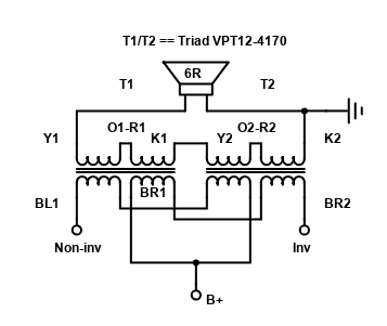

Toroidal mains transformers can work very well depending on a few things, one being low source impedance (Triode), and as said, they must be used with a push pull config or be used in parafeed since they are not gapped. I have built 10 amps over the last few years that all used Triad toroid power transformers for the output transformers. If you want good LF response, you must interleave a pair of them as in the attached artwork. If someone from Triad is reading this, a 240/480V dual primary would be nice!
