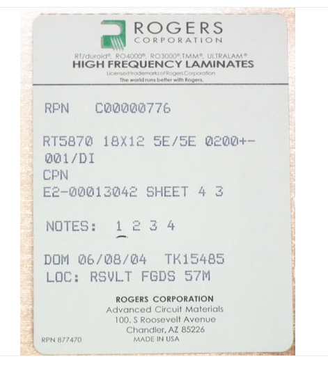

Hi diy'ers,
I may have access to some Rogers HF PCB laminate (ebayI, however, there's no information available about except for this product label ... which I just don't seem to dechifer ...
Might one of you know what the figures etc. means? I'm looking for information on laminate thickness and copper thickness ..
Greetings,
Jesper
Without any other information that label seems almost impossible to understand. If I had to make a guess I'd say it's a piece of custom or semi-custom material, perhaps just a sample, produced to meet a certain customer's requirements.
