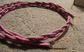

Vikash said:I've just made a cable using Cat5e. It looks pretty cool 🙂
I measured the resistance at 0.2-0.3 Ohms over the ~1.2 meter cable. Does this seem high?

Yeah, I thought so too. But after downloading the wire gauge calculator spreadsheet from TNT-Audio.com, the theoretical SPL loss is only 0.06db and damping factor = ~117. A helpful little spreadsheet.
I don't know what I'm looking for in the damping factor. A higher number the better I guess?
For comparisson, the 3m 10 AWG cable has SPL loss of 0.07 and DF = ~100. Not much different.
I'm guessing anything less than ~0.1db SPL loss is acceptable for a cable over its distance?
And another pic...I can't believe there's so much cat5e lying under my nose, and it never occured to me to try it...duh.

1. Vikash, when you measured the resistance of your CAT5 cable did you remember to subtract out the resistance of the meters leads. Hook the positive to the negative lead and measure the meter's resistance (mine is 0.4 ohms) and subtract this value from the reading when measuring the CAT5 wire. I have made a similar set of speaker cables that are about 8 ft long and got a resistance less than 0.1 ohms (below what my DMM meter could measure) so I probably should have used my LCR meter.
2. To reinforce GM's point. If you look at the voice coil wire, it is probably tiny compared to all of the other wires in the signal path from the amp to the driver. The voice coil probably has 100 ft of wire or maybe even more (enough to produce an 8 ohm DC resitance, I'll let somebody else calculate the length). So ask yourself this question. At what point does an 8 ft speaker cable, and all of the crossover wiring, become as big a factor as this long length of very small voice coil wire. I consider this analogous to water flowing in a fire hose through a 10 ft long nozzle the diameter of a drinking straw. How important is the diameter of the fire hose?
In reality the speaker cable and the interconnects are important and can make a difference in the sound. My experience has been that as long as the DC resistance is kept very small, the differences in cables occur at the high frequencies where the wire/connectors can roll off the response. At these frequencies the cable can become inductive or capacitive and alter the sound of the system. But at some point you reach the level of diminishing return, I think car battery cable may be way out there on the curve.
Try the CAT5 wire as shown in the pictures, I was surprised at how much better it was compared to my more expensive cables (now shoved under the couch). Simple, cheap, easy to make, how much more could you ask for in a cable?

No I didn't subtract the DMM's resistance. After doing so, I re-measured the cable resistance = ~0.01 Ohms. Thanks for pointing that out.
